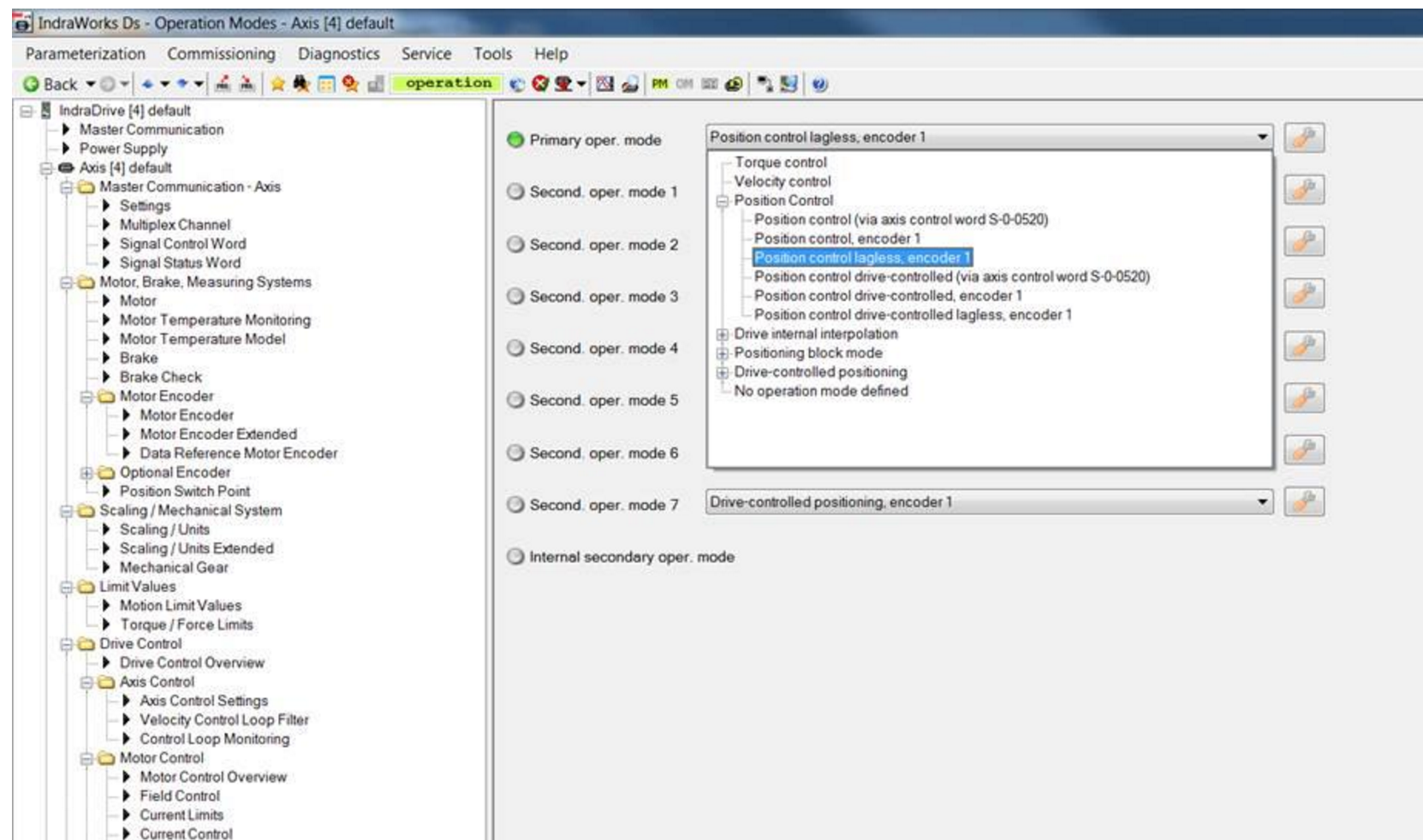

I'm trying to get a single axis Indradrive servo on Ethercat working and have a little problem - the servo won't rotate!
The config (attached) seems ok in that the axis gui comes up, motors homed and jogged etc. However the motor itself never moves
Comms to and from the drive works - the drive mode changes to OP (display on drive shows Ab then AF), I can see the torque change in the gui when force is applied to the shaft.
The servo works correctly in Indraworks and TwinCat.
Wireshark shows the position value is being sent to the drive. I have also sniffed the data from Twincat and there are some differences, I do not know enough about ethercat to determine if these differences are important or not. I can post extracts from those traces tomorrow if it will assist.
Can anyone assist? Sorry I'm new to this so please let me know what extra information I need to post.
Attached are the config files in use.
Regards,
Roger

Hi Roger,
two quick points are in my mind according to your files/describition
- in xml file the pdoentry poscommand is of type float --> what is about scaling? --> disable drive (AF -> Ab) rotate the shaft what value is there in halpin lcec.0.3.pos and when yes how much if you rote one time...
- in the config of the drive (done in indraworks) do you have the default main operation mode set to "position control"?
- don't use "speedaddcommand" for initial tests/setup
Hope that helps
Andreas

Thanks Andreas,
I will try adding scaling using your suggestion, thank you. I have tried before but I did not think to use the pos to determine the scaling. The motor has a brake which I will need to release.
I've attached a screenshot showing the Indraworks mode - "Position control lagless encoder 1". I've also tried "Position control encoder 1" with the same result, but have not tried any other modes.
I'll remove the speed command for now.
I will report back on progress, there is some building work happening in our test lab so it may take a few days.
Best regards,
Roger
