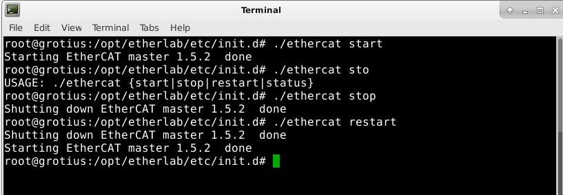

25 Oct 2018 20:31 - 25 Oct 2018 20:37 #119410
by Grotius
Replied by Grotius on topic Ethercat HAL driver
Hi it works.
I did a new instal :
hg clone hg.code.sf.net/p/etherlabmaster/code ethercat-hg
cd ethercat-hg
hg update stable-1.5 ( i think next time i don't do this one )
./bootstrap
./configure --disable-8139too --enable-generic --enable-e1000e
make
make modules
sudo make install
sudo make modules_install
depmod
Open the sysconfig, in total there are 2 files with the same name, hmmm strange :
input mac adres
input generic driver
Then my previous error is solved by copy this entire folder :
sysconfig map copy to :
etc directory.
And i made a empty file in the dev folder with name :
EtherCAT0
And i make a few files from root to user privileges in the etherlab directory.
Now the ethernet is starting. Now i need to connect it to linuxcnc. Someone has expirience with this?
my system : Linux grotius 4.9.0-8-rt-amd64 #1 SMP PREEMPT RT Debian 4.9.110-3+deb9u6 (2018-10-08) x86_64 GNU/Linux
cd ethercat-hg
./bootstrap
make
make modules
sudo make install
depmod
input mac adres
etc directory.
EtherCAT0

@Grotius You can compile linuxcnc-ethercat and use config file from ethercat_3axis_CIA402 , use basic_3_CIA402_new.xml and add <masters></masters> in front and at the end of the file
Regards,
Bryan
I'm using LinuxCNC 2.7.14 from this repository Ubuntu PPA . Ubuntu 16.04 kernel 4.4.12-rt20
You may have a different problem. And you can check if lcec.so is linked with libethercat.so by running
ldd lcec.so@Grotius You can compile linuxcnc-ethercat and use config file from ethercat_3axis_CIA402 , use basic_3_CIA402_new.xml and add <masters></masters> in front and at the end of the file
