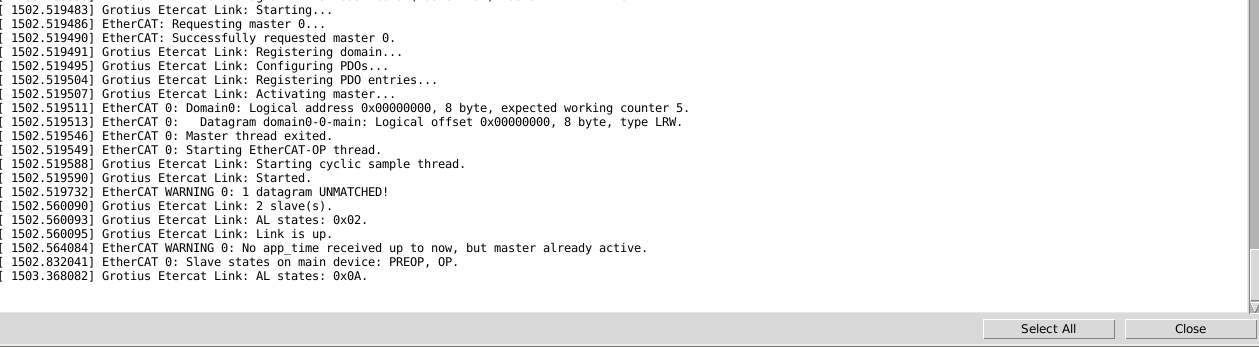

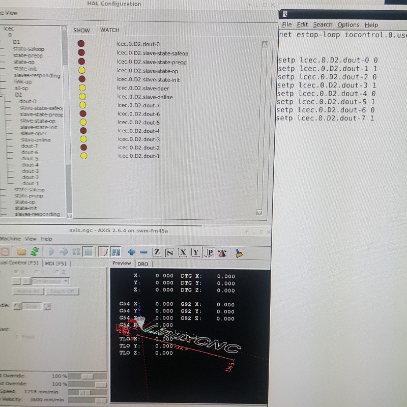

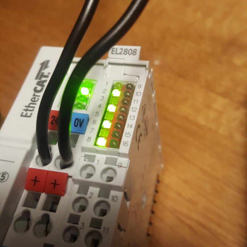

Got it working.
Have used a prime time linuxcnc verision of the past. 2.6. Thanks to Andy for providing a fast iso cd adres on the forum in other thread. forum.linuxcnc.org/38-general-linuxcnc-q...2-6-live-cd-download
the iso cd of 2.6 debian linuxcnc
I grabbed a new pc and installed the iso cd, after the cd, only used this for core installation ethercat :
So now i have some ehtercat working after 5 hours on a old linuxcnc version, problably 32 bit.
But i was started with c code on 64 bit linuxcnc system.
This was compiling but i have to know more about c coding. But first test tonight is so far so good.
The reverse engineering will take some time. I will now first investegate the real time lsec component.
On my 64 bit system the etercat connection is good. But reading value's with a custom component is until now the bottleneck.
Maybe time will bring me to next level.

This was for me the succes. In the example of swm-fm45a, i changed the ini to :
[HAL]
#HALFILE = core_sim.hal
HALFILE = swm-fm45a.hal
#HALFILE = swm-fm45a-axis.hal
HALFILE = swm-fm45a-spindle.hal
#HALFILE = swm-fm45a-io.hal
HALFILE = mies.hal
HALFILE = simulated_home.hal
This tiny changes provide e-stop reset + enable + auto homing. Then it's easye'r to check some things.

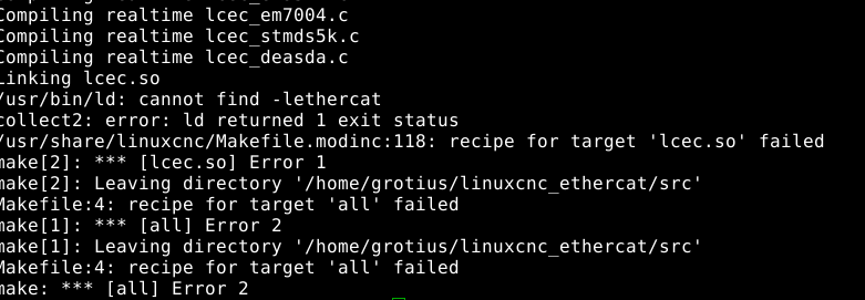

Hi, i have a little Ethercat project update for 64 bit linuxcnc systems.
It's a hard case. My c program language must be improved...
But there is every day a little progress.
Next thing to do is setting an digital output outside of linuxcnc. When this succeed i will try to include hal.h.

When installing the github version on 64 bit i get this error :
The error is related to the line 19 in the realtime.mk file :
LDFLAGS += -Wl,-rpath,$(LIBDIR) -L$(LIBDIR) -llinuxcnchal -lethercat
The -lethercat is not found.....
Warning: Spoiler!
include ../config.mk
include Kbuild
include $(MODINC)
ifeq ($(BUILDSYS),kbuild)
# dirty workaround to get the RTAI directory
RTAIINCDIR = $(subst /rtai.h,,$(firstword $(wildcard $(foreach i,$(subst -I,,$(filter -I%,$(RTFLAGS))), $(i)/rtai.h))))
ifneq ($(RTAIINCDIR),)
RTAIDIR = $(realpath $(RTAIINCDIR)/..)
endif
all:
$(MAKE) EXTRA_CFLAGS="$(EXTRA_CFLAGS)" KBUILD_EXTRA_SYMBOLS="$(RTLIBDIR)/Module.symvers $(RTAIDIR)/modules/ethercat/Module.symvers" -C $(KERNELDIR) SUBDIRS=`pwd` CC=$(CC) V=0 modules
else
all: modules
endif
include Kbuild
include $(MODINC)
endif
all:
else
all: modules
endif
