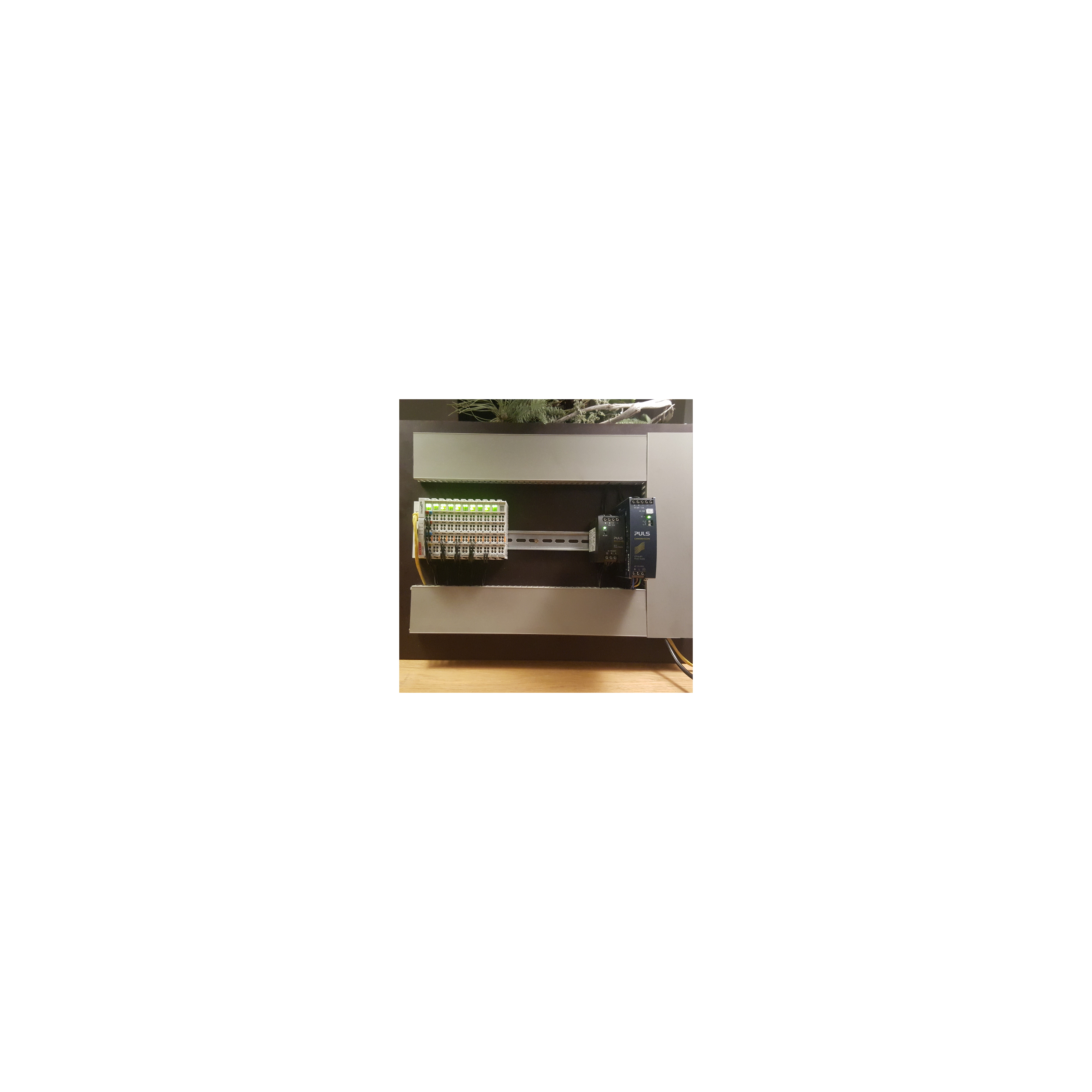

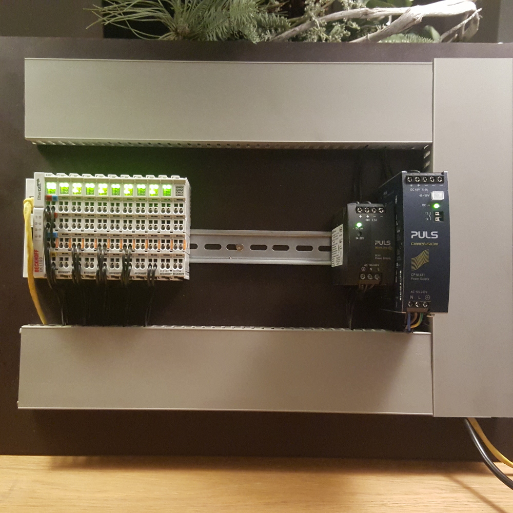

I am almost at the moment to install my first ethercat hardware on real machine.
Spec's of this board:
4 axis stepper, config XXYZ, home sense X0+X1+Probe (+5 input spare on stepper drives)
1 analog input for torch height control (+1 analog input spare)
1 relais output for torch on/off (+3 output's spare)
1 24Vdc power supply
1 50Vdc power supply

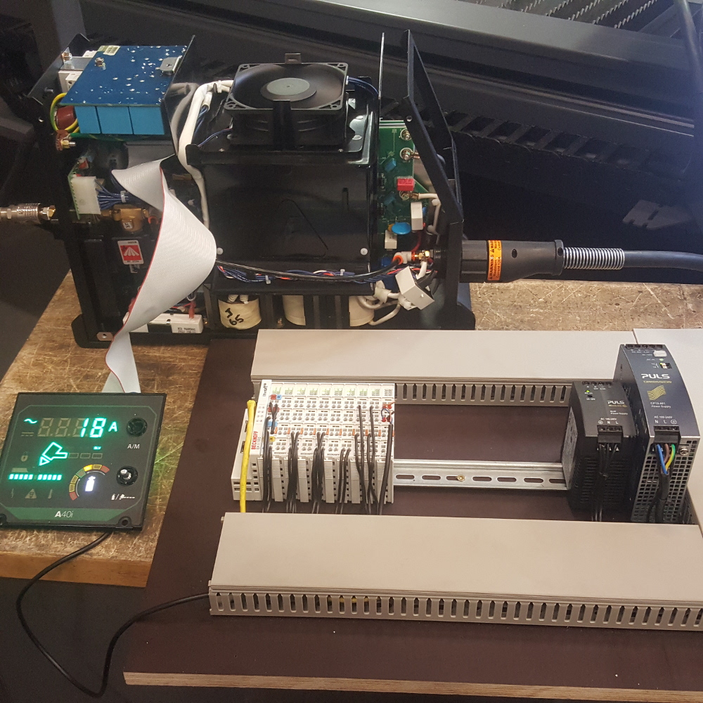

Hi Rod,
It's the 40 pin ribbon cable that does all the i/o. It's kind of confusing there is also a 15 volt department available on the ribbon cable. In total 3 type of voltage channel's. The pulse type potientiometer has a push function. this is easy to capture.
The fact is. At the moment i was testing the inverter i had only one inverter in the company and i had to cut next day.
Now i have more on stock, so i can test. If it burn's out there is no problem next day.
The ribbon adapter you sent in your link is the perfect way to test the application. All pin's are covered with hard wax. So measuring is also not easy at this moment without scraping first the hard way away.
I will test it with a new 40i inverter coming day's.
The purpose is to make an ethercat connection to the inverter. Maybe it will end in 2 pieces of 40 pin ribbon cable adapters, with
a analog ethercat output module beween it. If there are more connection's available i will let it know.
Almost forgotten, the inverter's have a selectable internal voltage divider with different ratio's.
Results in 0-10 volt analog in can be used on the ethercat side, that has a resolution of 16 bit.

Hi Rod,
I mentioned your manual is different then the 40i and 60i manual.
The interfacing of the power button is different at the 120 amp's inverter.
The 40i/60i has a power button based on a kind of rotary encoder, pulse type.
It was not easy, but it's now done. I soldered a 3-wire cable on the print.
I wrote a software component called POWER.comp that does the work for adjustment very nice.
The beckhoff EL2794 is a 4 channel solid state relais. This one uses 2 relais to adjust the power.
I had to write the EL2794 driver also. For reader's don't buy the EL7041 without the -1000 extension. So order only
EL7041-1000. The EL7041 works on the EL7041-1000 driver, but is about 30% slower trough the slower in motor output speed
using the slower internal encoder.
Now i am going to look, to adapt the kerf width offset into variable g-code, for G41/42 procedure's. When that is done,

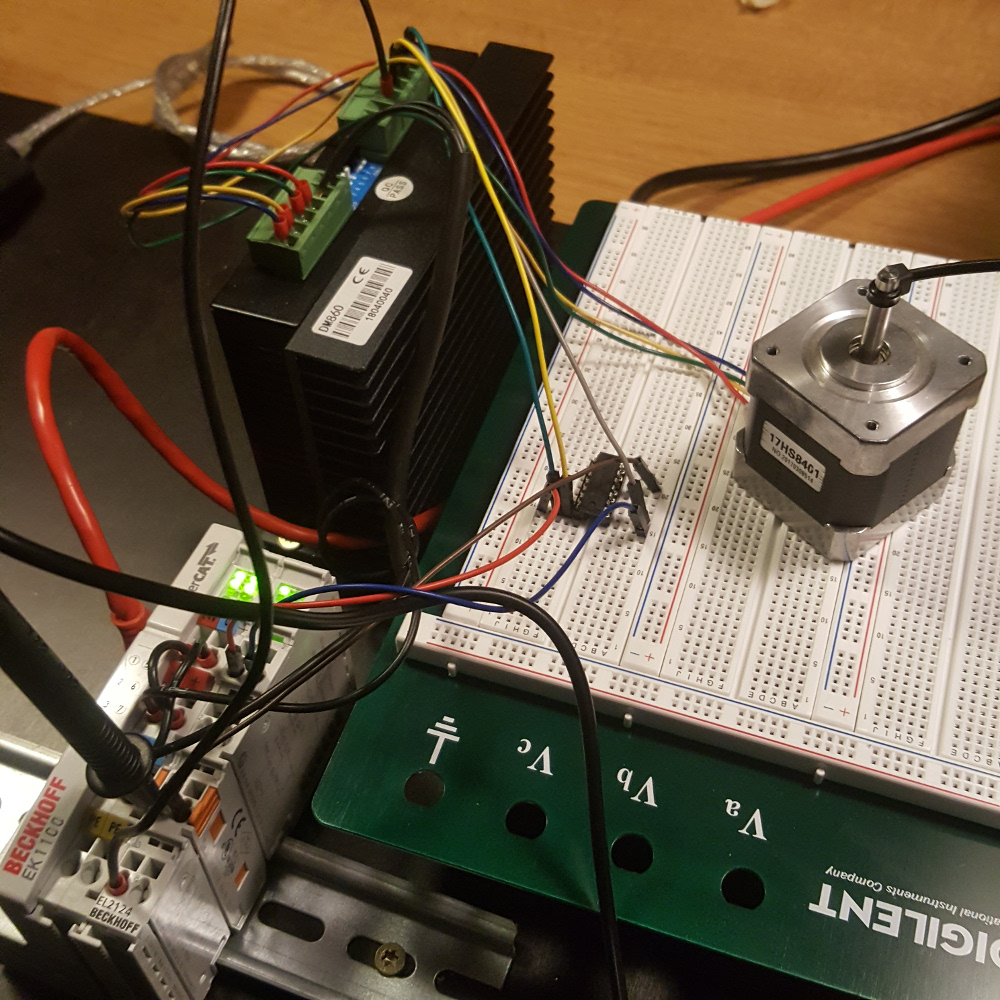

Today i made some Ethercat progress, but at the beginning i made first a smoke curtain at my factory and blown a EL2124 and a secondairy chip away on a 24 vdc circuit. Cheise. So at home i had a second EL2124... To try with. It's a small stepper at the picture to test with. It stay's alive at 2 amps.
The Beckhoff stepper drives are 50v 5amp's. This was to less power to drive my gantry portal x axis motor's after testing.
So Houston i have a problem.
I was looking for a solution. Watching youtube about the transistor. And i ordered a chip that works like a transistor.
Minimum order was 30 chips, so it was a bit risky to order if the test would fail. I also ordered a breadboard.
But finally it succeeded after tuning the Ethercat software side. Now i can drive my machine with 80 volts 8 amps on Ethercat. Also the price is reduced from Euro 250 a drive to Euro 50 a drive. I now use a EL2124 to guide 4 stepgen signals ( 4 motor pulse train's )
I will test this config on the machine coming day's. I hope it's good on a real machine. This test set up, run's like a servo.
I mentioned ethercat has no reset, parport has. But after all, that's no problem.

The EL2124 can directly work on stepper drives like DM860.
I inverted the signal with ic. This works, but was not my problem.
I trapped my self in a software pre configure issue. Glad it works now without ic.
The pulse speed of the EL2124 is : typ. TON: < 1 µs, typ. TOFF: < 1 µs, so pulse timer looks quite quick. Ethercat is fastest protocol i read somewhere.
Solution is to make Ethercat read and write in base thread in stead of servo thread, in my case the timer is now 15000 in stead of 1000000. Machine speed's over 20 m/min with steppers. I stopped stable testing at 21 m/min.
Now beckhoff is coming to my factory to show some servo drives. I hope this will bring some luck. In the past i worked with Lenze
servo drives. So i am curious about their advise.
