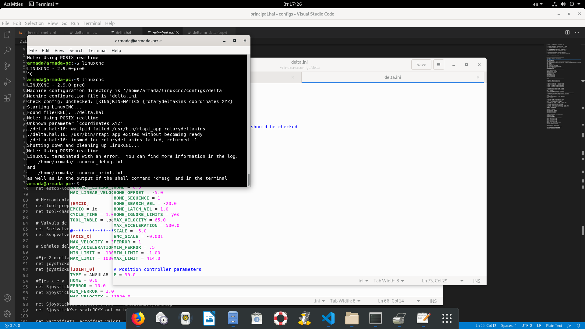

23 Jun 2020 14:36 #172473 by TheRoslyak
Tell someone who was able to run ethercat with rotarydeltakins on the new version of Linux (2.9). I try to run configure of narogon. But my or narogon's confuguration gives one error. trivkins works perfect, but it isn't my target.
23 Jun 2020 14:50 #172475 by Aciera
@TheRoslyak
Have you tried deleting the "coordinates=XYZ" in the KINEMATICS declaration in the INI?
The following user(s) said Thank You: TheRoslyak
23 Jun 2020 15:01 #172477 by TheRoslyak
Brilliantly!!! It's work.
