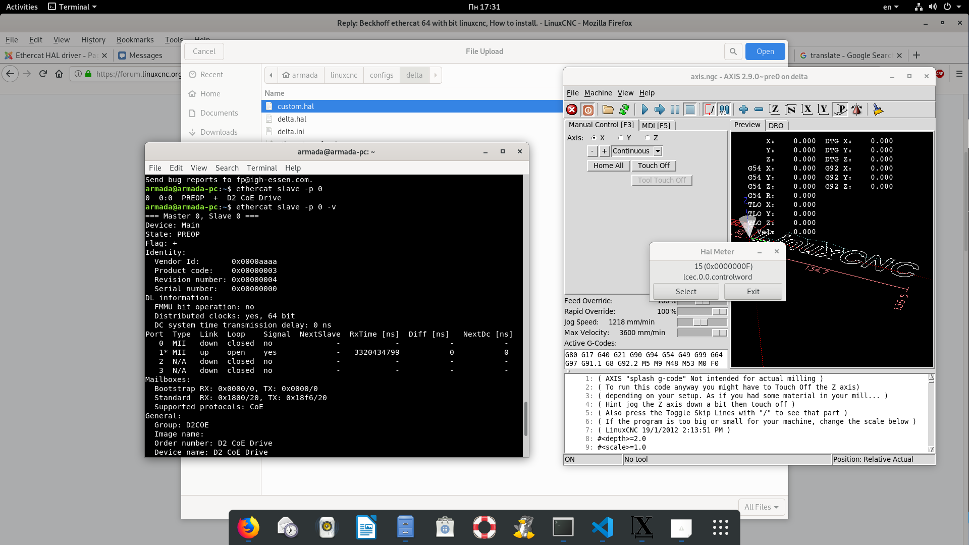

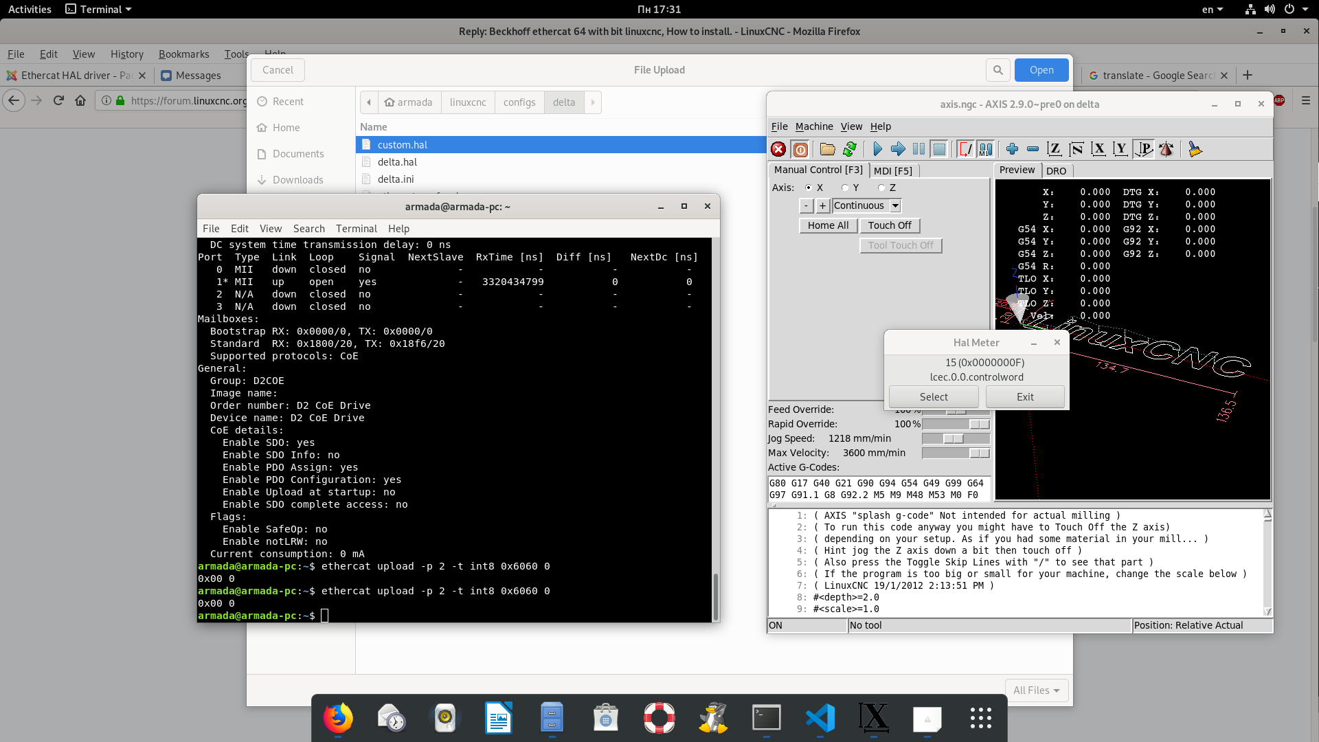

Сan you explain what I'm doing wrong. I create xml and hal files And linuxcnc work without error and gives correct values. But drivers do not load them. Can you help me please
Last edit: 29 Jun 2020 15:52 by TheRoslyak. Reason: Everything is working

29 Jun 2020 21:07 #173136 by Grotius
Maybe try one single motor driver config first. Then your problem is easyer to find.
Your xml is quite big at the moment.
