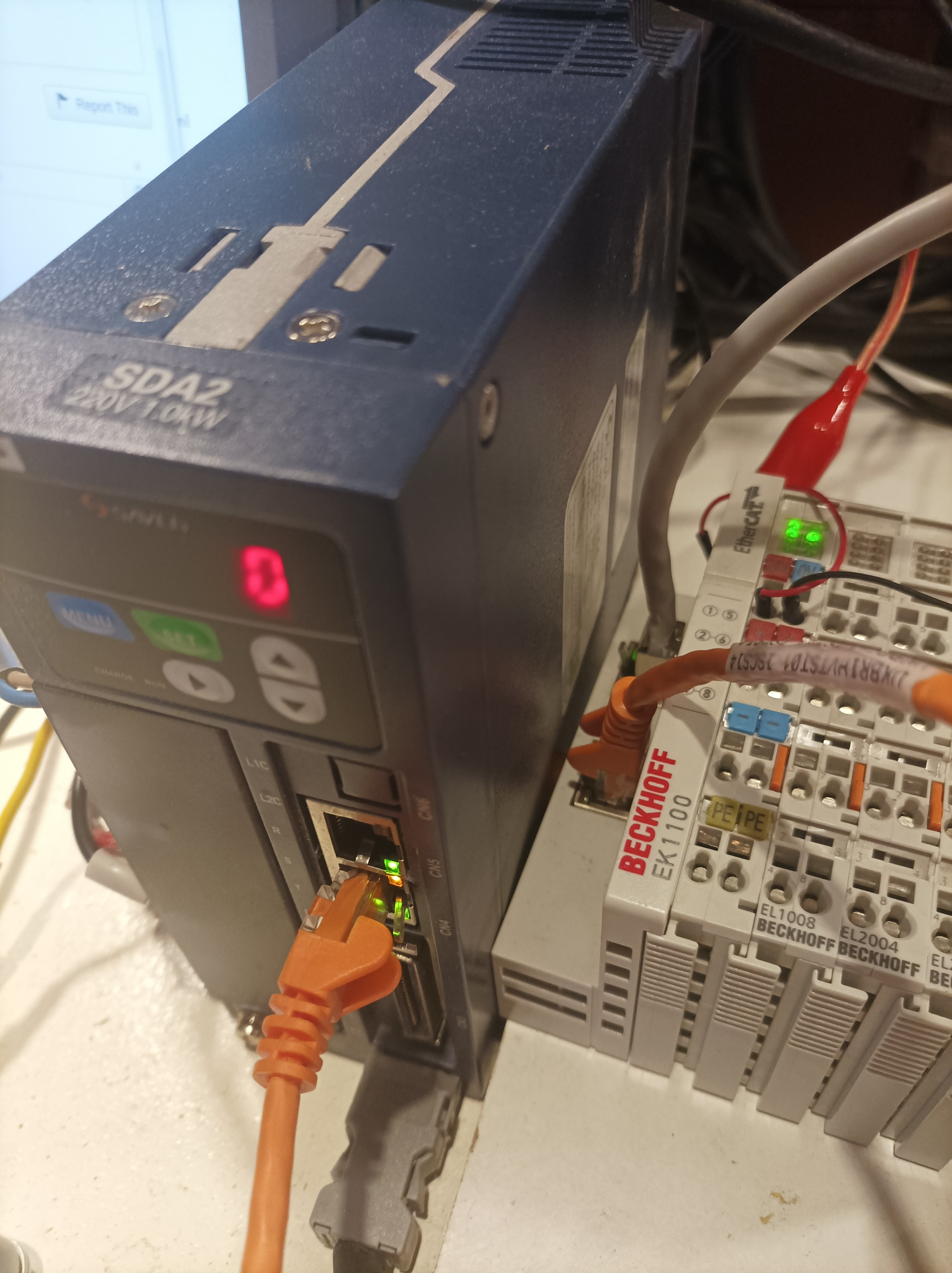

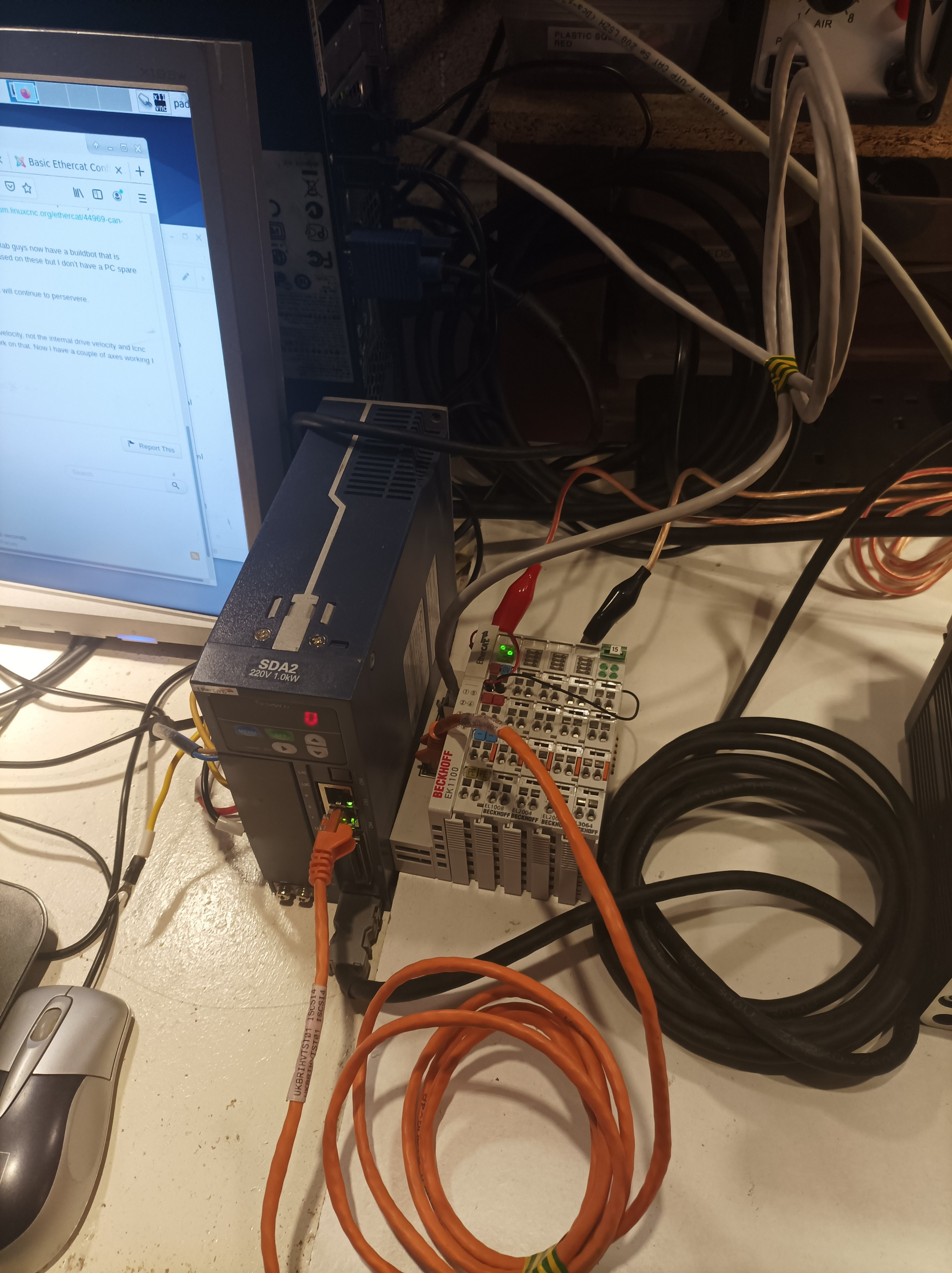

https://photos.google.com/photo/AF1QipOXuKMAiUl_3dyOeuQ562Me49VImoJFY-5H1J78like everyone I've been busy with boring work things...
but I've uploaded some pictures of the ethercat cabling, and you might be able to see that we have is a HP pc which has 2 network cards, the onboard, and one in a slot..
the cables, are from the onboard nic, to the beckhoff, and then out of the beckhoff to the savch drive,
but i've just swapped the cables around, so now we have the Savch and then the beckhoff and all the items seem to be on the same bus ID
i'll screenshot from the linuxcnc pc in the next post...

this is now, how it should look like....
strange is the old behaviour...
You now have to change the order in your ethercat_conf.xml and try again.

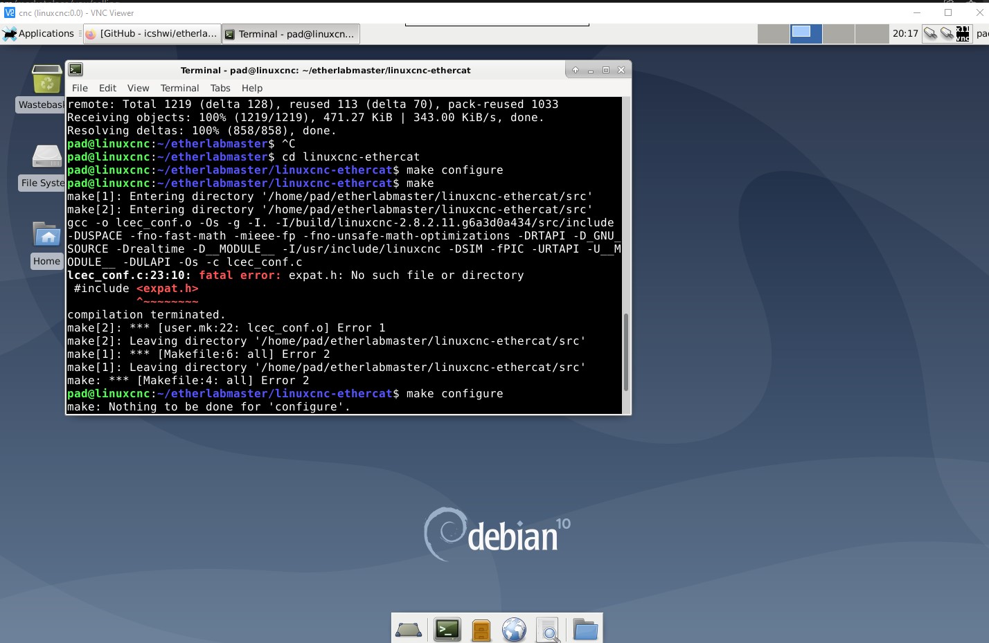

so ... i've got the ethercat bit working... but the bit that I'm now on is the linuxcnc-ethercat bit...
now using the forum.linuxcnc.org/ethercat/42048-notes-...aspberry-pi-4#203806
instructions as a starting point, (i'm creating a document as i go which i will totally share, as it actually seems to cut down on quite a bit of command line stuff when using the linuxcnc iso)
but i have a error...
if you look at the image you can see i'm trying to make the Linuxcnc-ethercat driver....
so ... whats wrong...
Pb
reboot, reboot, rebuild...
and today is the rebuild day ...
Pb

Hmm,
package missing. Install expath .
"sudo apt install libexpat1"
