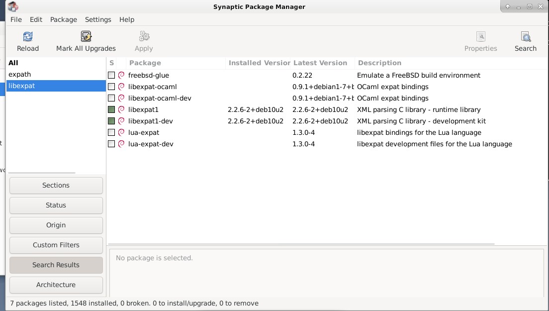

as always... i did not know that i should do that...
but i'm glad i asked... as its helping make my install instructions as good as i can make them ....
so one of the things I'm finding ... (and its being a windows guy i suppose... ) and its that i can use the package manager to make sure i have all the dependencies , and give a way of keeping it current, (as current as this sort of thing can be... )
so to get around the error during the make of linuxcnc-ethercat i installed libexpat1-dev (the libexpat1 was already installed) see the image below...
onwards and upwards..

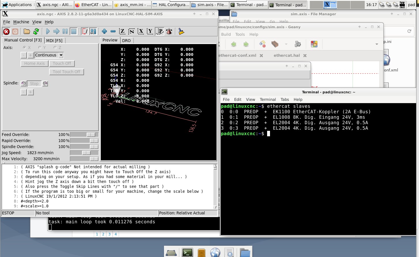

Good call.... i'm going to remove the savch servo .. and see if i can just command and read the Beckhoff items...
Pb
Pb

Hmmm... so i've got a very basic config... but seems the ethercat devices.. (jsut the beckhoff stuff) is not coming online...
- db1981
- Posts: 790
- Thank you received: 276
20 Feb 2022 16:51 #235399
by db1981
Replied by db1981 on topic the holy grail...
very strange.
what tells "dmesg" about ethercat .

20 Feb 2022 17:43 #235402
by Padstar
Replied by Padstar on topic the holy grail...
well...
here is the dump from dmesg...
what do i make of this..
Pb
Pb

puuh, nothing important.
post actual ini, hal, ethercat_conf
