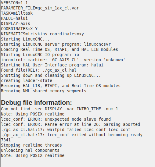

All know that my 1 hour can be so long ... sorry for delay ... any how today return on project ...
because someone told to me that is possible mix old style xml with cia402 these is my xml ... and above screenshot o error ...
I ask to someone ... and He told that is possible mix old style xml and cia402 .... so that my xml .... error on Lcnc was:
row 17 of my hal file report:
So i'm little bit confused .... but for sure not see some mistake ...
bkt
loadusr -W lcec_conf /home/linuxcnc/configs/axis.cld/gc_plc_ax.xml
