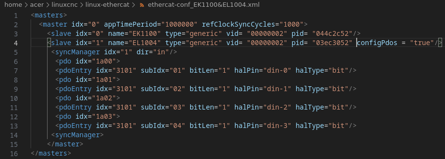

11 Feb 2024 15:04 - 11 Feb 2024 15:08 #293097
by pepex
Replied by pepex on topic Ethercat build from source - full instructions
Hello Robert,
thank you for your answer. I've made some progress, but I can't see my digital inputs.If I don't write them in .xml as my hal pins, I don't see them in halshow. If I write them there - .xml found on the Internet, there is some error. I have no idea, but what's wrong. Not even in your instructions is the .xml detailed with the description:
<syncManager idx="1" dir="in"/>
<pdo idx="1a00"> <pdoEntry idx="3101" subIdx="01" bitLen="1" halPin="din0" halType="bit"/>
What am I doing wrong?
Thank you for your patience.pepex

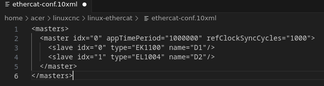

- CORBETT
- Posts: 286
- Thank you received: 113
12 Feb 2024 06:19 #293131
by CORBETT
Replied by CORBETT on topic Ethercat build from source - full instructions
Hi Pepex,
Ok I see you are trying to use the “generic” driver for the EK and the EL. There is no need to do this as both the EK1100 and EL1004 are already in the LCNC-Ethercat driver. I know you are saying LCNC fails if you try the XML without the “generic” type, but the EK and EL definitely work out of the box as these were working from the beginning when Sascha released his code.
The first thing is to change the XML back. Make your XML look like this, I will use your “naming” scheme:
<masters>
<master idx="0" appTimePeriod="1000000" refClockSyncCycles="1000">
<slave idx="0" name=”EK1100” type="EK1100"/>
<slave idx="1" name=”EL1004” type="EL1004"/>
</master>
</masters>
Make sure to remove all the pins that you have written for the EL1004 in any of your “hal” files. With the EK and EL hooked up, try and see if LCNC will start. It should start right up if the EL1004 terminal is ok and not bad.

Ok let's do an XML like the old days with the “D” naming. Just change the “name” only:
<masters>
<slave idx="0" name=”D1” type="EK1100"/>
<slave idx="1" name=”D2” type="EL1004"/>
<slave idx="2" name=”D3” type="EL1004"/>
</master>
</masters>
Pins for the #1 EL1004 would be:
lcec.0.D2.din-0
lcec.0.D2.din-1
lcec.0.D2.din-2
lcec.0.D2.din-3
Pins for the #2 EL1004 would be:
lcec.0.D3.din-0
lcec.0.D3.din-1
lcec.0.D3.din-2
lcec.0.D3.din-3

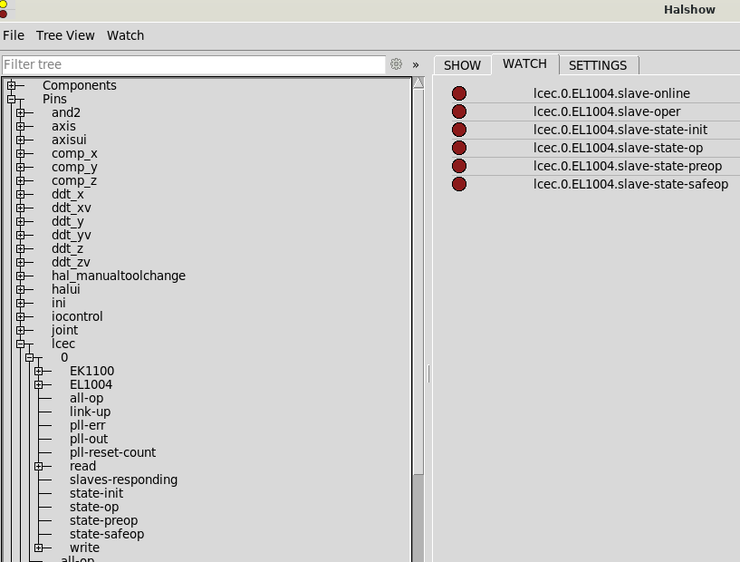

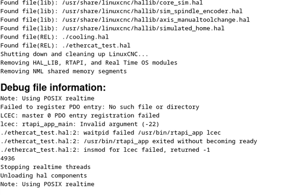

Last thing… if you still cannot get the EL to show up, then I would say you need to reset the terminal or get another as it would be hardware. I know TwinCAT can change the terminals heavily, so if this is a used terminal then keep in mind you don’t know what the person before you did and it’s best to factory reset it so that you are starting fresh with the terminal.
I have had terminals not work, until I reset them. Your first post with the Debug file shows that the terminal is not “seen” by the LCNC-ethercat driver. You call for it in the XML, but the driver cannot find/see it. This is evident in the line:
lcec: rtapi_app_main: Invalid argument (-22)
So this leads me to believe you may have a hardware issue still, but try the XML and software side and we will go through the steps to figure this out.
