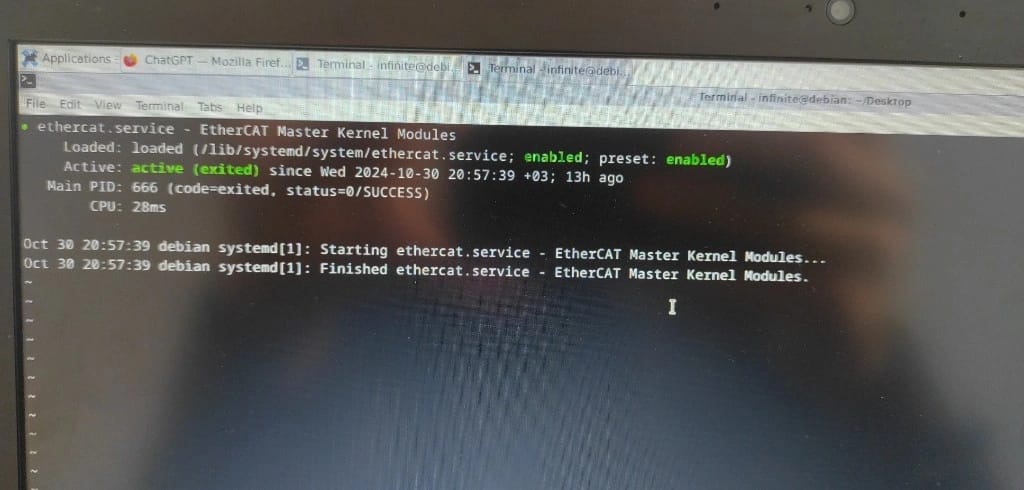

31 Oct 2024 03:00 #313529
by Halil
Replied by Halil on topic Ethercat build from source - full instrheluctions
Hello sir, I am trying to install linuxcnc xinje servo driver but I don't know if I am making a mistake due to the configuration. I would be very happy if you could help me. Thank you.

- Posts: 22037
- Thank you received: 7505
31 Oct 2024 08:50 #313532
Replied by tommylight on topic Ethercat build from source - full instructions
@Halil
Start a new topic for configuration issues, this is for installation only.
Thank you.
