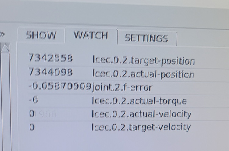

12 Mar 2025 21:39 - 12 Mar 2025 21:47 #323778
by LCR
Replied by LCR on topic Problems with Lichuan Ethercat servo drive
Has anyone actually run these servos? I'm trying to tune these, which was going well. However I'm having an issue where the drives randomly develop an offset. Not following error. I can use the pendant and the same offset stays. I can manually force the motor back and forth, and the offset stays. When I turn the drives off, and on, the offset dissapears. I put a dial on and the offset is real. The encoder is not loosing position, it seems to be something in the drive. Any ideas? Anyone seeing this? Anyone not?

13 Mar 2025 02:25 - 13 Mar 2025 02:36 #323794
by ihavenofish
Replied by ihavenofish on topic Problems with Lichuan Ethercat servo drive
that's still very decent. my machine is "faster than most". yours is more in line with what most people will be doing with these servos i expect.

13 Mar 2025 02:30 #323795
by ihavenofish
weiiird. is that mm for f error?
what axis?
Mine are omron, so no help there but when they stop, they are within 2 encoder counts (20 bit). I wonder if there is a feed forward thing where its just not bothering to catch up after stopping. I think i had that on my brother analogue servos when i chose some bad settings.
(also , side note, i need some help with ethercat setup, haha)
what axis?

13 Mar 2025 06:14 #323801
by Darium
Replied by Darium on topic Problems with Lichuan Ethercat servo drive
@ihavenofish
Wow that's nice. Having 3 ton machine moving like that also with the current jerkness is too scary definitely not good for my heart.
@LCR
I have similar issue with non-ethercat drivers. you can check it out this thread. It may help
forum.linuxcnc.org/38-general-linuxcnc-q...s-creeping-up#309973
@LCR
