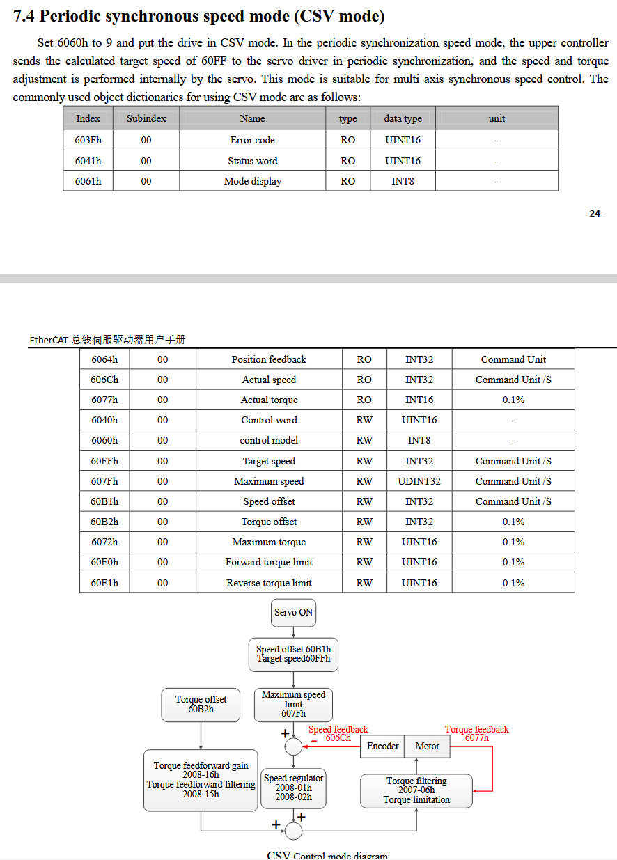

Is it possible to use the lichuan servos in csv mode with ethercat. i dont see any target speed the the variable pdo mapping. Can you use the fixed pdo mapping? Ive tried using index 1702(fixed) but im not able to enable the drive.

05 Sep 2025 16:15 - 05 Sep 2025 16:28 #334502
by Hakan
Replied by Hakan on topic Problems with Lichuan Ethercat servo drive
Alex, try
nn being the number you want to set. There is also an upload. Sometimes it is better to do it outside of linuxcnc.
Check for SDO index:subindex using $ "ethercat -p 2 sdos"
Max, did you try to claim it with "AliExpress Seller Protection"?
Philip, the manual says it can be done see snippet here
You should be able to add PDO 0x60ff to the SyncManager listing in the config, I think.
0x60ff is also in rxpdo 1703,1704,1705 so one of them should work. I guess.
$ ethercat -p 2 download 0x6068 0 nnnCheck for SDO index:subindex using $ "ethercat -p 2 sdos"
Last edit: 05 Sep 2025 16:28 by Hakan.
