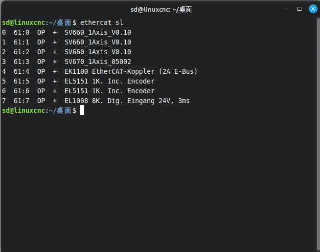

29 Oct 2025 11:17 #337392
by onceloved
Replied by onceloved on topic Long initialization of Ethercat on servo drive SV660N

- onceloved
- Posts: 134
- Thank you received: 59
30 Oct 2025 00:21 #337427
by onceloved
This is unrelated to the configuration; you need to modify the driver, Sii firmware, and disable Eoe.
