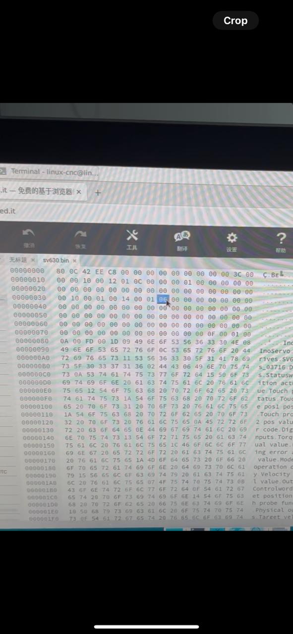

- hanz24
- Posts: 16
08 Dec 2025 04:06 - 08 Dec 2025 04:07 #339845
by hanz24
Replied by hanz24 on topic Long initialization of Ethercat on servo drive SV660N
Sorry for the late response. If our problem is same, this is what I changed in the sii file from my Inovance driver. I changed that part to ‘04’ and then wrote it back to the driver after making the change.

12 Dec 2025 15:11 #339999
by automata
Replied by automata on topic Long initialization of Ethercat on servo drive SV660N
I can confirm that Innovance SV660N works by recompiling the IGH etherlab master stable-1.6 branch and installing on a fresh debian bookworm installation.
The configuration options I have used for the etherlab master are:
./configure --sysconfdir=/etc/ --disable-8139too --enable-userlib --enable-generic --disable-eoe
Thank you nanowhat.
