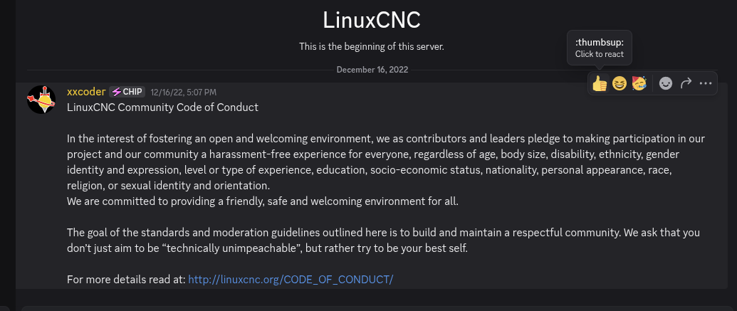

You are still doing the install, and cannot get the system online?
the discord you joint the channel, go the the welcome, read the rules, thumb up the rules, and you can join in general
read the instructions and the rules to joint the linuxcnc channel, they are there when you try to join the channel
edit:
you need to confirm email, and maybe phone number
then add server in discord
discord.gg/uW7KXqMw
then you need to go to the rules, and thumbs up react to the first message in the rules, here you see #rules and you click it
here you see this message and you click the hand with the thumb up
Then you will be able to write in the linuxcnc general channel with everyone else, I also PM you in discord, but you seem offline.
