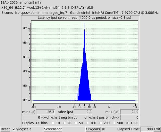

Greetings everyone. Today I went to the customer's office after the company closed at 5 pm. I just got back at 8:30 pm. I had the chance to do some more testing, and I have to agree with Grandixximo.
I don't know why, perhaps I was in a hurry to not down the customer's machine for too long, and I made some mistakes.
The jitter results:
Debian Trixie, kernel 6.12.74-rt, latest Grandixxmo patch, Grub command line optimization (isolcpus, etc.) with 4 glx files open, 2 browser windows open, full-screen window movements, switching between different desktops, max jitter 65 microseconds.
The machine with refClockSyncCycles=-1 normally doesn't emit any noise, except for some window movements.
With refClockSyncCycles=1, it emits some noise.
With both refClockSyncCycles=-1 and 1, the command
ethercat upload -p 0 -t uint16 0x1C32 0x01 returns 0x0002 2
Pin pll-error oscillates around -1200 to 1300
Pin pll-out oscillates -5 to 5
I tried the commands:
ethercat upload -p 0 -t uint16 0x1C32 0x02
ethercat upload -p 0 -t uint16 0x1C32 0x03
ethercat upload -p 0 -t uint16 0x1C32 0x05
but it returns the error failed to upload sdo : no buffer space available
Debian Buster, kernel 4.19-27-rt, no optimizations on the Grub command line, with 4 glx files open, 2 browser windows open , full-screen window movements, switching between desktops, max jitter 95 microseconds.
With the same Grub optimizations as Trixie, max jitter is 75 microseconds.
With refClockSyncCycles=1, it easily emits noise.
With refClockSyncCycles=-1, it works flawlessly and without Grub optimizations, which with GRUB optimizations
pll-err pin from -1800 to 2000
pll-out pin oscillates with only two values: either -1000 or 1000
So I deduce that even Trixie has lower jitter than Debian 10, but for some reason, Debian 10 lets my machine work and Trixie doesn't.

Thanks for confirming that jitter itself is not the issue. This was expected with my tuning in place..
One of the difficulties with Ethercat, is that there are no IP addresses on the network to test network latency against. If this was a Mesa card, we would do that with sudo chrt 99 ping -i .001 -c 600000 -q 10.10.10.10 Perhaps there is an alternative method.
I think it can be assumed on a properly tuned Ethercat Intel NIC (like yours) that network latency is not a factor. Ethercat has an inherent advantage over Mesa because of its customized network protocol that uses significantly less bandwidth due to smaller packet sizes. The main network latency culprit is coalescing which has been disabled, SMP affinity has been used to ensure the NIC interrupt is running on the same core as Linuxcnc and a number of other optimisations that could introduce network latency have been tamed.This is confirmed where we see a substantial tightening of the Standard Deviation in before and after latency-histogram tests (more than halved from 2.3 to 1.1 usec on Mike's PC). This means the system is much more deterministic with fewer latency spikes (eg narrower bell curve, much more consistent timing on the servo thread).
It all comes back to your environment. eg a configuration issue or a problem with the ethercat system itself (ether the Ethercat master or the linuxcnc-ethercat driver. CNC is a very small subset of what applications the iGh master is used for. Its mostly used on factory floor automation. This is why I find it hard to believe that it has a problem as if it did, the Igh issues register would be flooded with reports and it isn't.
So by my analsyis, the issue has to be a configuration issue or the linuxcnc-ethercat driver.
