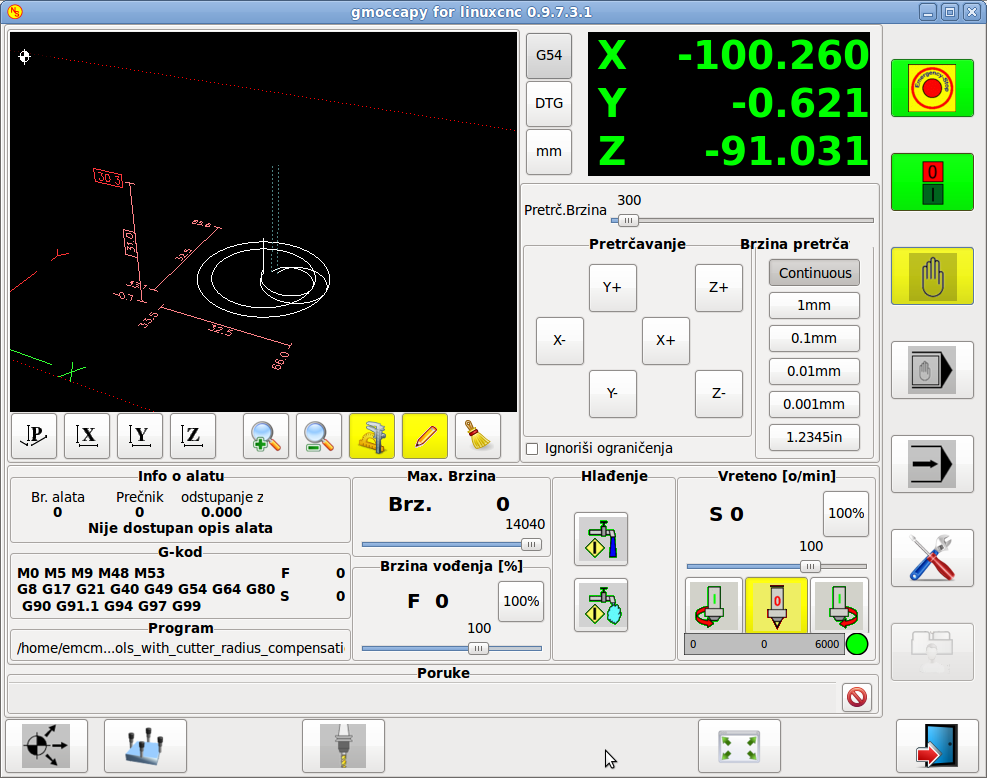

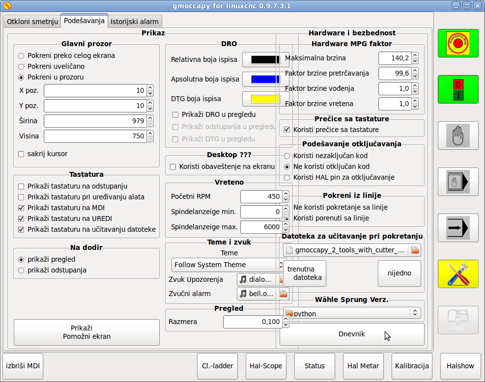

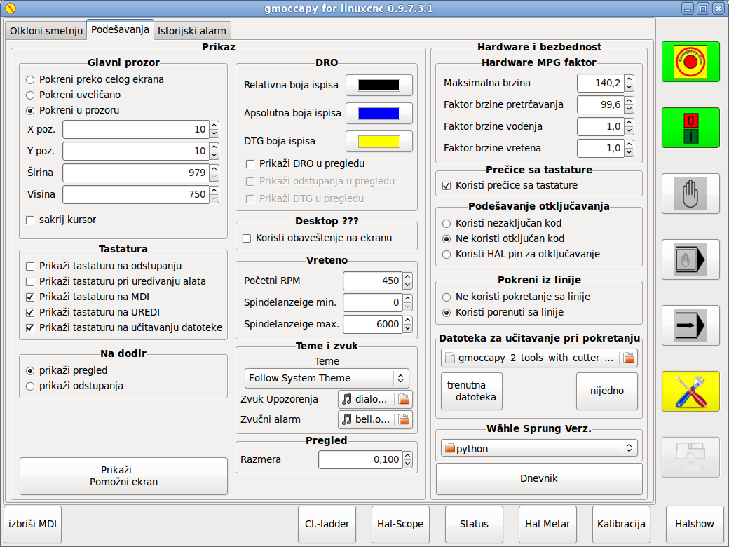

- newbynobi
- Posts: 1931
- Thank you received: 394
25 Sep 2013 22:30 - 25 Sep 2013 22:31 #39182
by newbynobi
Replied by newbynobi on topic Gmoccapy - A new screen for linuxcnc
Halo probamo,
it seems to be a serious problem on your computer.
If you just followed the WIKI, then deleting the linuxcnc-dev folder will erase all master thinks.
If you then start linuxcnc from the menu, it should start as usual. I am sure this has nothing to do with gscreen or gmoccapy.
Next step: run as first latency test to check that your realtime kernel is OK, than try to get your 2.5.3 to start than reinstall master as descriped in the WIKI.
I can give you the good news, that your translation is working, see the attached screenshots. Just serbian seems to be a language of long words;-)
You will see in settings that you have to shorten some of the translations. And there are some mot translated words, or better you translated Spindle bar max and spindle bar min to german. I errased that ones and will push a new release with the translation included.
Norbert
Norbert
Last edit: 25 Sep 2013 22:31 by newbynobi.

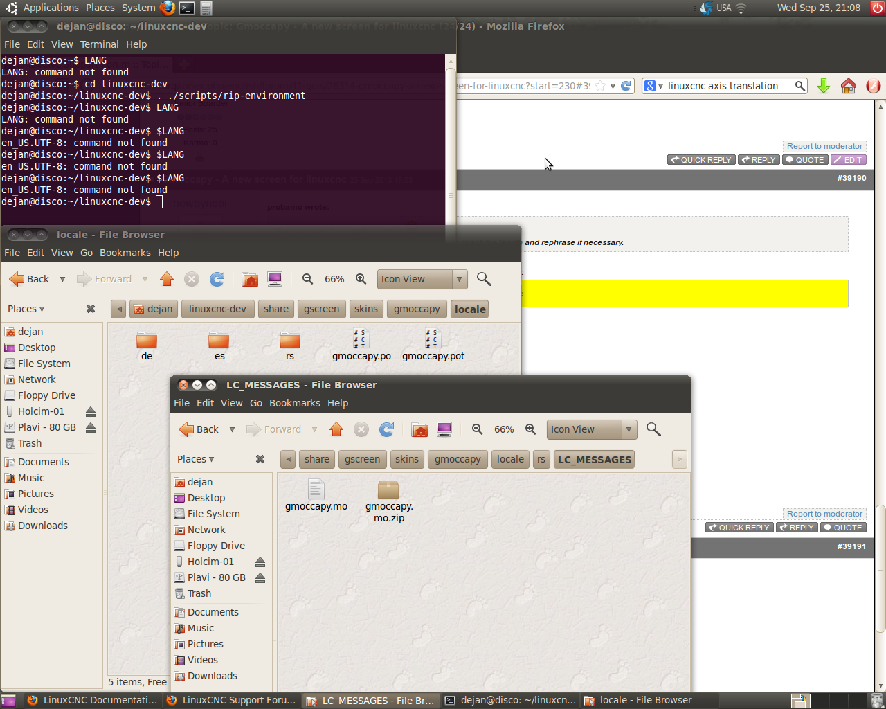

26 Sep 2013 02:02 #39191
by probamo
Replied by probamo on topic Gmoccapy - A new screen for linuxcnc
Instead of "cs" please make "rs" for Serbia.
I'll give a try.
I'll give a try.
- probamo
- Posts: 139
- Thank you received: 9
26 Sep 2013 02:08 - 26 Sep 2013 02:13 #39192
by probamo
Look my screenshot. I created folder "rs", though there is "de" and "es", but neither German or Spanish is loaded. In Terminal there is en-US. How to change it.
Thanks.
Thanks.
Last edit: 26 Sep 2013 02:13 by probamo. Reason: forgot attachements
