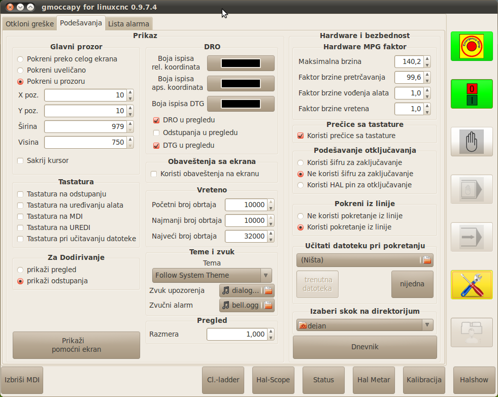

please tell me in the Settings, in which of the three columns I have to workaround, to fit the window size, the second or the third one.
Regarding localization of 10.04, I tried so many times to install serbian in Languge Support w/o success. In fact instaltion of Serbian languge passed as a sharm, but unfortunately such installed support is not seen in the list of the languages !??? I search on Google, there are instructon how to change the language which I followed, but none. Doing this back and forth my gmoccapy slowed down while loading the application and even Estop button while pressing on it does not take my wish to start the "machine", permitting me to go on the next button to "start/stop switch".
I will use wiki instruction again to install 2.6.0 and give a fine tuning for translation.

it doesn't matter which column you edit. If one getting shorter the other one gets more space so the Widgets will fit in the screen.
I will look for a little bit of time and try to find a solution for you.

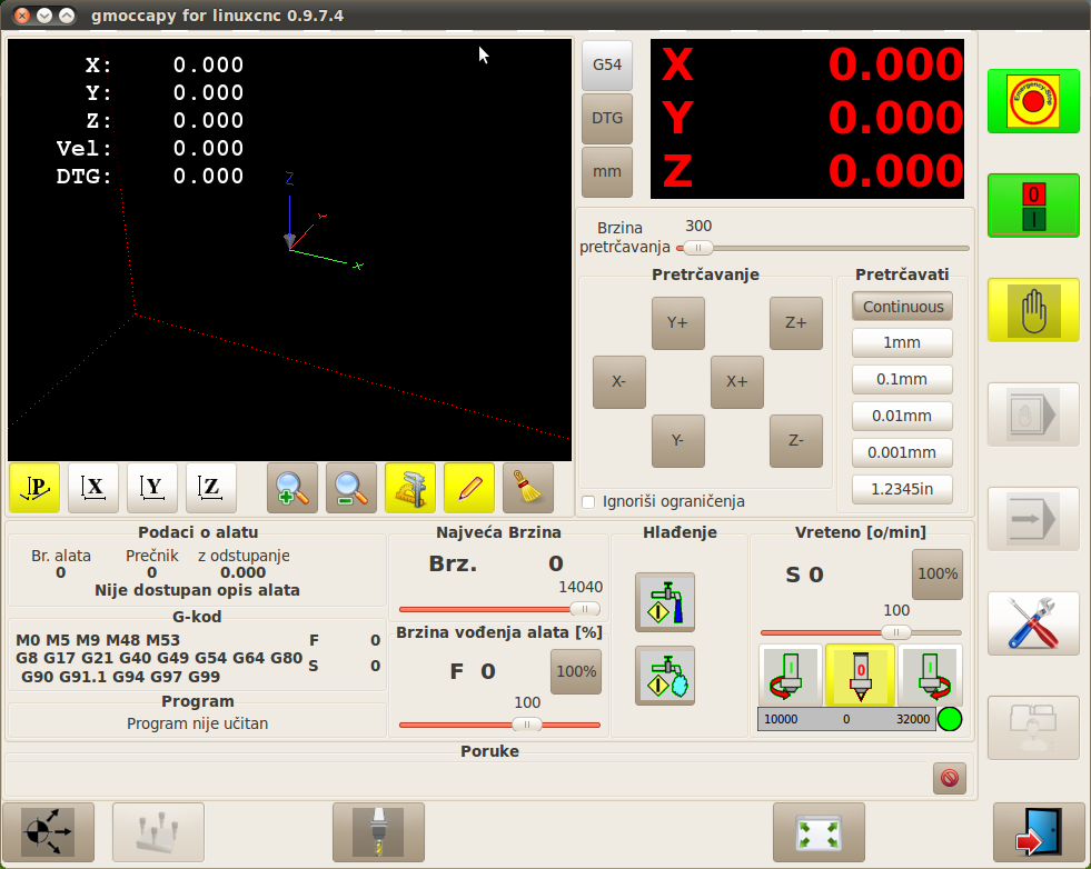

Main display:
1. having loaded 0.9.7.4 and wanted to home each axis separately, homing X &Y were OK, but homing Z did not work displaying the message:
"cannot home while shared home switch is closed". Don't know what happened, just homed!!! Even this kind of message does not exist for translation.
However the option homeall works.
2. In JOG Rates, there is no translation for "continuous" though there is local word for such meaning at least in Serbian. The last option in rates is in Inch, not in mm. Either remove this option, and place ignore limits check box somewhere else due to symmetry or modify it in mm as well.
3. G54 is referent coordinate system, nothing to be translated, but Abs. can be. I have no option for it. The same applies for DTG and GTD
4. Show or hide tool path do not take translation.
5. When using keyboard, and jogging the axes, pressing Shift does not double the jogging speed. It should be instead.
6. Unit for velocity in main display shall be indicated

Main display:
That is not a problem of gmoccapy. In sim mode we use simulated home.hal, that makes the problem. If you want to home a certain axis and get that message, just jog the axis a little bit in negative direction and it will work.
OK, The Continious Button I missed, I fix it very soon!
The last increment is on purpose in inch, just to show, that it is possible to mix them. You can change that very easy, just edit the INI file. The buttons are generated dynamically on start, reading the INI File. See also the section "jog increment hal pins" of the WIKI.
So here is everything OK!

2. When change the data for Spindle, min/max/starting, no changes affected in Main display but only when you restart application
3. What does mean MPG faktor?
4. What is unit for maximum velocity mm/s?
1. Ok, looks good now, would you please send me also the po file? I need that to merge it with the new files, otherwise xou will have to translate everything again, also the steps you have done allready.
2. I will check this and fix it.
3. It is an factor witch is apllied to the counds we recieve. It is explained in detail in the WIKI section settings
4. Max Vel is in machine units per minute

Automatic mod:
1. pressing button starting from the line, new window is opened, named Restart Entry, not translated
2. when you want step-by-step and press the button, what is going on? I have feeling nothing happens.
1. it is a part of gscreen, I will have to check how to include that one.
2. Every time you press that button linuxcnc will run one step, meaning one line of code and than wait for you to press the button again.
