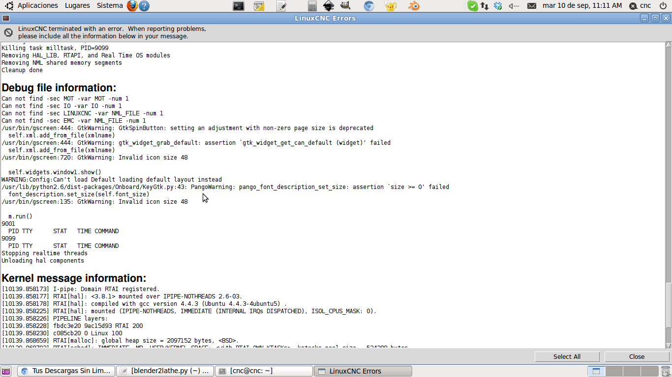

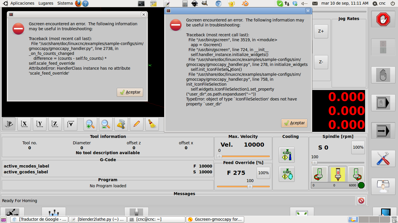

10 Sep 2013 23:14 #38631 by jlviloria
Replied by jlviloria on topic Gmoccapy - A new screen for linuxcnc
Halo Norbert.
update the version and I have this error.
Next week I will send an email with some things I've been working, to see what you think.
10 Sep 2013 23:22 - 10 Sep 2013 23:57 #38632 by newbynobi
Replied by newbynobi on topic Gmoccapy - A new screen for linuxcnc
Halo Jorge,
I beleave that is an problem of your config. I just tested the actual version in a virtual machine and it works fine. I do beleave, that you still have in your config folder old gmoccapy files!
In your config folder should not be any of the following files:
gmoccapy_handler.py
gmoccapy.glade
no folder icon or locale
The structure of the files has been adapted to fit the new gscreen structure.
We look first in the config folder, if there is an handler file, if it is, we use that one, if not, then the search goes on in share/gsreen/skinns/gmoccapy if there isn't easer a handler file, than default gscreen will be used!
So please look at that first!
Norbert
By the way, why is your GUI not in spanish?
I only miss the translation file from you ;-)
Last edit: 10 Sep 2013 23:57 by newbynobi. Reason: explaining the error
