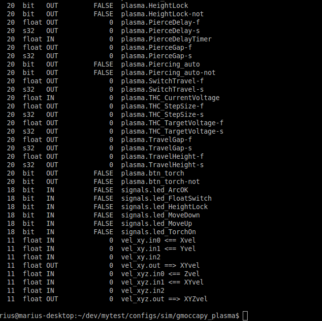

Sorry I took so long to get back to you. I looked at the pins and it seems ok but for one missing setting. We have a pierce gap but require a cutting gap/height as well. This is not the same as the travel height.
The "step size" setting can change to a percentage (of the feedrate) instead of the 0.0001 . I will use this in the component to adjust the z travel speed.
The lock percentage must be able to go up to 98% for very thick steel.
What happens is as follows. When we get a M03 the torched is moved towards the job at a probe speed (from the INI) until the switch is made. We know the switch offset so we travel back that much and set the z zero. Then we travel up to the pierce gap and start the torch. We wait for an arc good signal and then move the torch down to the cut height/gap. The thc looks at the up/down signals and will adjust the z up or down at a speed percentage of the feed rate. At the end of the cut the torch is retracted to the travel height. Ans the process repeats.
Edit: Oh the one thing that gets changed on the fly while cutting is the target voltage. A large plus and minus button to change the value would be very useful instead of the spinbox.
Hallo Marius,
sorry for the late answer. Please take the attached files and replace the existing ones, so you get the missing TravelGap.
(you have to delete the txt extension from plasma.py.txt to be called plasma.py)
I tried to include also the buttons to change the voltage, but I got problems, that the handlers are not found, I will have to look at that closer.
Norbert

05 Nov 2013 18:58 #40550 by mariusl
Replied by mariusl on topic Gmoccapy - A new screen for linuxcnc
Norbert
Sorry it takes so long but for some reason the notification of your topic replay did not come through. I have been waiting and wondering why you are taking so ling meantime it has been waiting for a week already.
I loaded the files that you attached but now I get now plasma features at all and no error either. It just does not load or show nothing. No glade panel.
While we are at it, I dont know if I asked before but is it possible to store the last selected values in all option, text or spinbox inputs to the preference file or any other file?
For Axis Arceye wrote a component to save the parameters but I believe that in Gscreen it might be done another way.
Regards
Marius

06 Nov 2013 02:40 #40561 by mariusl
Norbert
If you do a show pin in the debugger it looks like all the plasma panels loaded but the plasma.glade does not show on screen. The pins are all there.

06 Nov 2013 03:01 #40563 by mariusl
Norbert I think the plasma.py.txt file that you uploaded is corrupt. This is what is inside.
Please repost that.

07 Nov 2013 03:04 #40601 by newbynobi
Replied by newbynobi on topic Gmoccapy - A new screen for linuxcnc
Halo Marius,
you are right, the file is corrupt. I do not know why, may be, because the forum does not allow uploading python files.
I just send you the correct one by separate mail. After adding the file, you should see also the second panal.
Norbert
