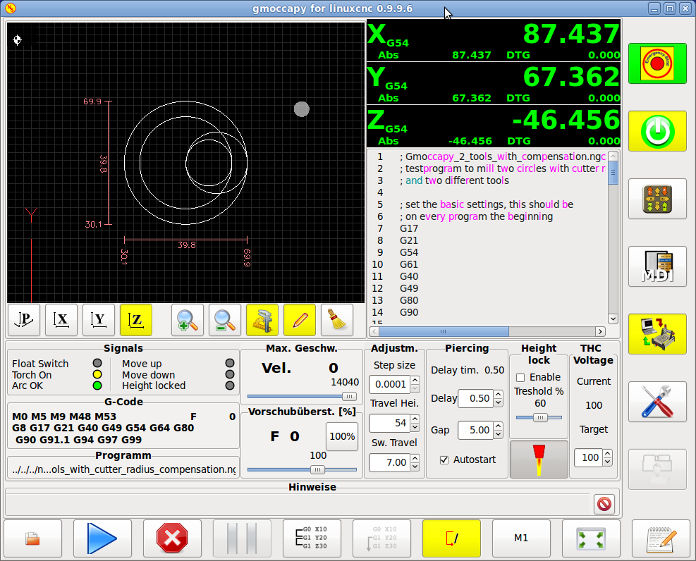

11 Dec 2013 03:55 - 11 Dec 2013 04:00 #41480
by newbynobi
Replied by newbynobi on topic Gmoccapy - A new screen for linuxcnc
gmoccapy 0.9.9.6 - introduced plasma screen layout
ver. 0.9.9.6
- made a new config folder to show gmoccapy as plasma screen
- included some minor changes to be able to place user glade panels
over the coolant and spindle frame, hiding the original widgets
so plasma screen can easy be realized
This will hide also the spindle speed label in gcode info frame.
- the tool info frame can also be hidden by a user glade file, because tool
info is not needed for plasma.
- corrected an error in handling python calls in / for user glade screens,
as example introduced plasma.glade plasma.hal and plasma.py demonstrating
all possible communications
ver. 0.9.9.6
Last edit: 11 Dec 2013 04:00 by newbynobi.

- mariusl
11 Dec 2013 05:06 #41482
by mariusl
Regards
Marius
www.bluearccnc.com
Replied by mariusl on topic Gmoccapy - A new screen for linuxcnc
Wow looks great Norbert. I might want to talk to you about some of the labels or terms used. Not all of them are the usual plasma terms. It could be a last thing though once we get all the other stuff working.

- mariusl
11 Dec 2013 05:50 #41486
by mariusl
Regards
Marius
www.bluearccnc.com
Norbert
I am not having much luck in the live config. I did a pull and compiled fresh. At this stage I am trying to load the screen without any hal files.

- newbynobi
- Posts: 1931
- Thank you received: 394
11 Dec 2013 06:31 #41489
by newbynobi
Oh !
My fault!
Please delete line 55 frommer plasma.py
self.connect_signals()
I forgot to delete that one, I will correct that tomorow.
Bet your parfon.
Norbert
My fault!
Bet your parfon.
Norbert
