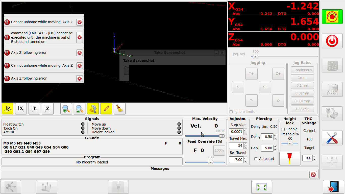

I got the screen to load and do most things but I have a problem with the jogging.
I can jog X and Y axis no problem but as soon as I jog the Z axis I get the errors in the screen shot. I reset the estop and machine and then I cannot jog any axis. The error is as shown. The error is for Z axis although I jog the X axis.
I have the NO_FORCE_HOMING switch ON at the moment so the machine is not homed.

Hallo Marius,
most of the warnings you mentioned, are normal, I will spend some time to check how to avoid them, but not all come out of my computer;-)
The actual error of your config is the following error in Z axis, the following error do unhome the axis, what is not allowed and so on.
Please find the reason for the following error.
Norbert
Norbert

Replied by mariusl on topic Gmoccapy - A new screen for linuxcnc
Norbert
It is running on live machine now. The problem with Z was the THC comp was not connected so there was no feedback
It looks great. I will let you know how it goes.
