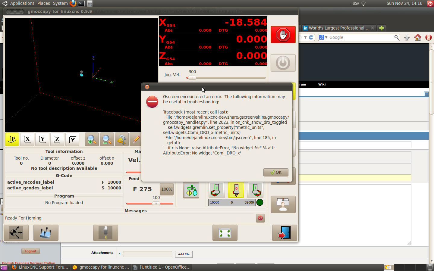

Replied by probamo on topic Gmoccapy - A new screen for linuxcnc
This is what I got
Any advice. It happened after I did 'git pull'.
Thanks,

Hallo Dejan,
The problem is a typo of mine in line 2023 of gmoccapy_handler.py, I missed an "b"
It should be "self.widgets.Combi_DRO_x.metric_units"
I am just correcting that, that bug does affect only the DRO in the preview.

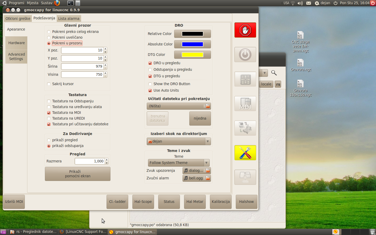

Serbian Translation, after a push you will find a gmoccapy.po file in linuxcnc-dev/share/gscreen/skinns/gmoccapy/locales/rs
Open the file with poedit and edit the missing translations and changes.
After pressing the save button, you will get a new file called gmoccapy.mo
Send me the edited po and the new mo file, I will push the new translation.

I trays *.po file in RS folder and as said before, there are in total 404 lines. However, in new ''settings'' there are things not taking translation as before. Having looked in the *.po file I found that old references making the same have been translated, but new lines in file could not found. See attachment. Any advise.
PS. Looking in DE there are less lines then in Serbian!???
