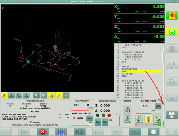

12 Jun 2014 17:02 #47935 by mariusl
Replied by mariusl on topic Gmoccapy - A new screen for linuxcnc
Hi Norbert
What I do is to start with I home the X axis of my machine. The Z has no home switch. Then I do a tool offset edit. It would seem to happen after I tired to edit a tool. The editor jumps out of edit mode once you press return. After that the if I select MDI, the button comes on but the jogging controls remain in place as if the machine is still in manual mode.
Regards
Marius

15 Jun 2014 16:49 #47983 by newbynobi
Replied by newbynobi on topic Gmoccapy - A new screen for linuxcnc
Hallo Marius,
Hi Norbert
I am not able to reproduce that!
I switch on the machine, Estop reste, machine on
I go to home
I do home only X
I go back to manual page clicking the back arrow,
I push the tool button
I click in the tool table and edit a x value,
All is OK!
What are you doing?
Norbert

20 Jun 2014 21:44 - 20 Jun 2014 21:54 #48145 by verser
Replied by verser on topic Gmoccapy - A new screen for linuxcnc
Hi Norbert,
In Gmoccapy, large g-code program is dynamically loaded into the window and scroll slider is impossible to estimate how much has already been done.
Is it possible to make indicator of the accomplished part of large g-code programm?
Meanwhile made ​​such an indicator as an addendum to Gmoccapy
File Attachment:
File Name: Progress.txt
File Size:2 KB
replace txt with rar
Unrar to ~/linuxcnc-dev/configs/sim/gmoccapy/
Add to [Display] section of ~/linuxcnc-dev/configs/sim/gmoccapy/gmoccapy-your-machine.ini
EMBED_TAB_NAME = progress_g_code_panel
EMBED_TAB_LOCATION = box_custom_4
EMBED_TAB_COMMAND = gladevcp -x {XID} -u progress.py progress.glade
get here is
Last edit: 20 Jun 2014 21:54 by verser.
20 Jun 2014 21:51 #48146 by verser
had to use one timer, although it can be excluded, but then you have to make changes in gmoccapy.py ,
maybe Norbert will do it :)
