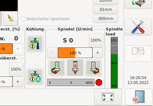

Hello, I have spindle load feedback working in Axis GUI and now I'm trying to make it work in Gmoccapy. What's the best way to do this? I think I could use the PYVCP control panel from axis, but I don't think this would blend in nicely with the rest of the screen. Looks like GladeVCP is an option, but I haven't seen a spindle load feedback example. Your advice is appreciated

Gmoccapy allows embedding glade panels. There are several positions to integrate that panels.
Within the configs / sim / gmoccapy folder you will find several examples for that purpose.
There is also a detailed part for embedding panels in the documentation.
To create the panel you need, just use the glade editor.

I have created quickly a very basic display GladeVCP for displaying this.It provides a pin "spindle_load.bar_spindle_load" where you can connect your spindle load value to.
Just copy the attached files to your config folder an add following lines to the display section of the ini file:Use the Gtk2 version for LinuxCNC 2.8 and the Gtk3 version for LinuxCNC >=2.9
EMBED_TAB_NAME = Spindle_load
EMBED_TAB_LOCATION = box_custom_4
EMBED_TAB_COMMAND = gladevcp -x {XID} spindle_load.glade

Hello,
that looks well, but i see at your picture the original Spindle load feedback isnt works.
I have the same problem and didnt understand why?
I tried to find the signals and linked in the HAL, but the result isnt works.
Have anybody an idea, why isnt works?
My configuration works with a Mesa 7I76E and i using the spindle connectors.
The spindle works very well

What version LCNC do you have?

LinuxCNC 2.8.3

HansU made it for Python 3. You must remake it for Python 2. Or you should ask somebody for remake. I am Interested for version 2.8 too.
