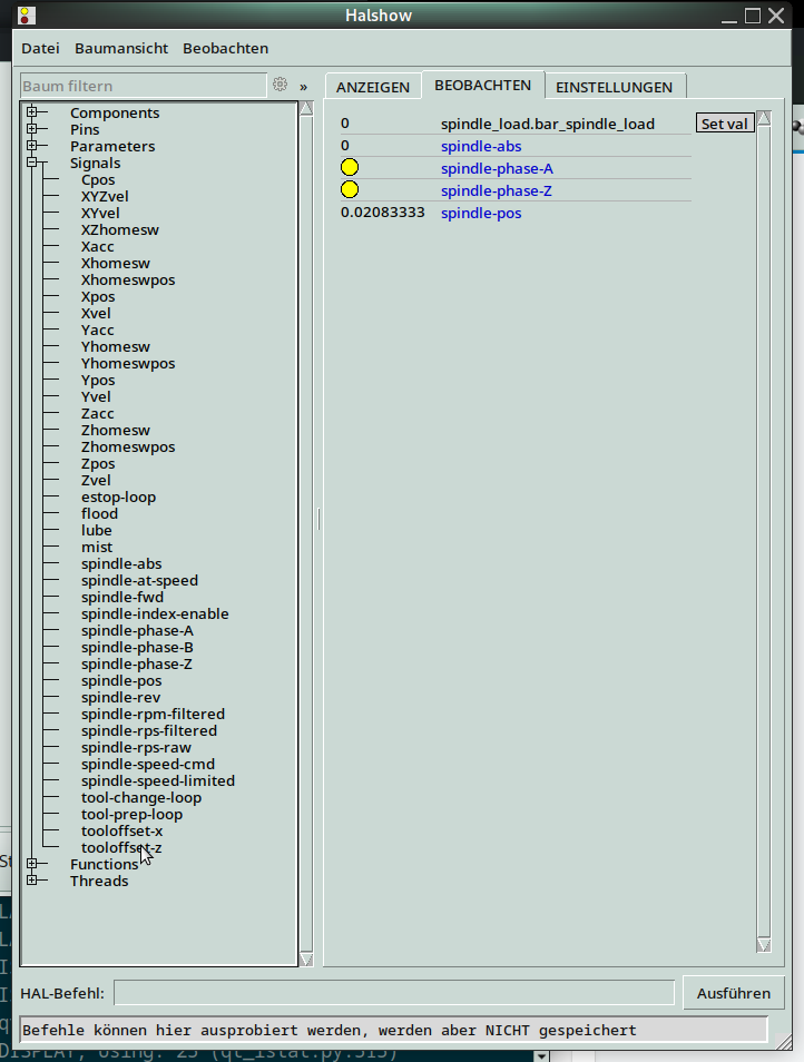

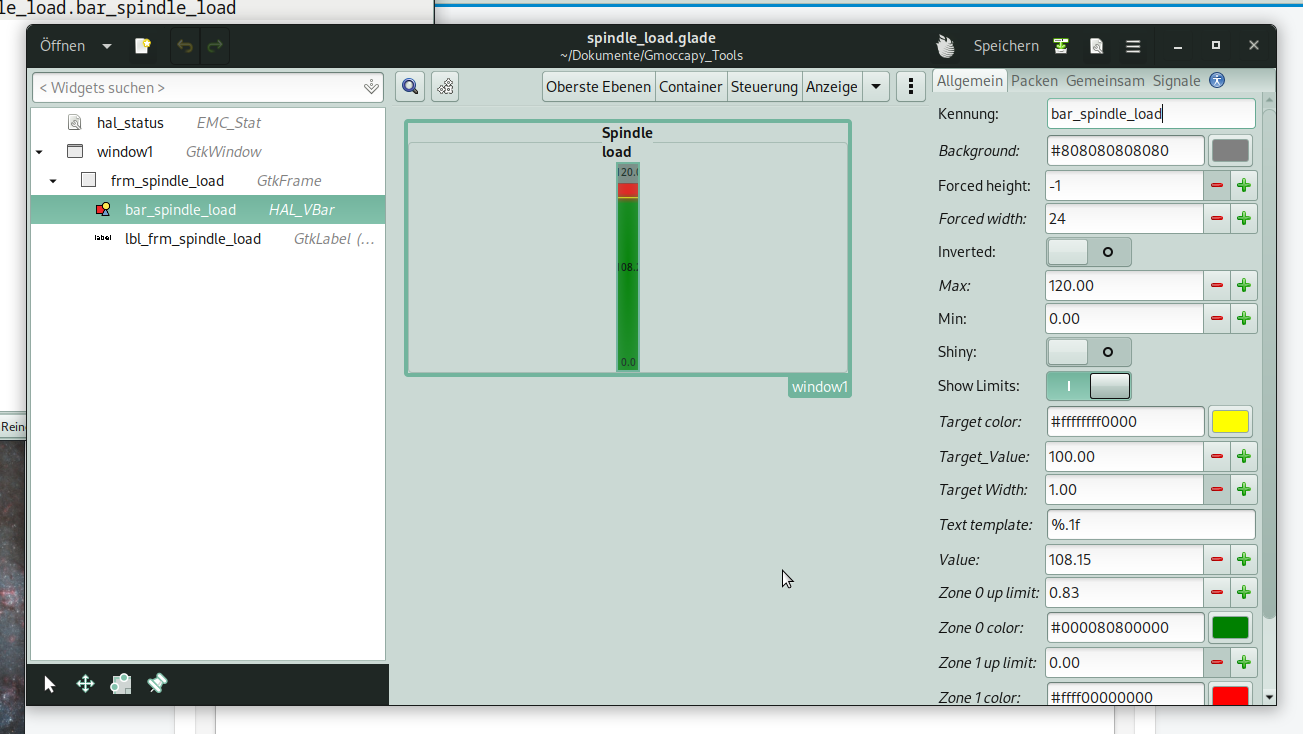

Hi ChironFZ16,
I don't understand what you are trying to tell me with your post.
My problem is that the command:
EMBED_TAB_COMMAND = gladevcp -x {XID} spindle_load.glade -H connect-pin.hal
ignores the connect-pin.hal file.
What should happen if you change the name of the signal:
net bar_spindle_load spindle_load.bar_spindle_load
net signal-spindle-load spindle_load.bar_spindle_load
Have you tried this test forum.linuxcnc.org/gmoccapy/45856-spindl...capy?start=20#266183 ?
If you tried that test, did you see a signal bar_spindle_load or signal-spindle-load in halshow=>Signals?
It would help me if you did the test too so we know it's not my fault.

Show Signals please not Pins.

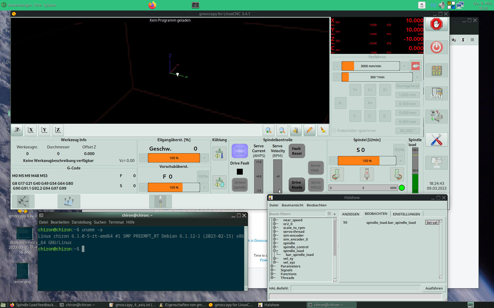

10 Mar 2023 17:54 #266309
by zz912
Replied by zz912 on topic Spindle Load feedback in Gmoccapy
I found problem:
This works:
This NOT works:
This works:
EMBED_TAB_COMMAND = gladevcp -x {XID} -H ./gladevcp.hal ./spindle_load.gladeThis NOT works:
EMBED_TAB_COMMAND = gladevcp -x {XID} ./spindle_load.glade -H ./gladevcp.hal
The following user(s) said Thank You: ChironFZ16
