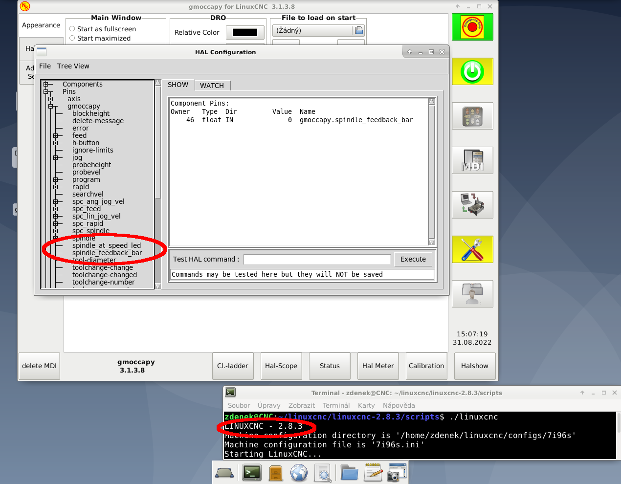

Pins are here:
linuxcnc.org/docs/html/gui/gmoccapy.html#_spindle_feedback_pins
Do you use postgui.hal ?

i can see the pins in the hal show, if i make a link,
i get a fault message " pin or Signal doesnt exist"
I took a look into the sim examples ... noting in the hal, but the pins are linked.
Postgui.hal, i think is an idea to take a look inside

Dear ZZ,
thank you so much, with the postgui.hal was the right idea!
It is working!!
Now i understand why this message "pin or signal doesnt exist"
Gmoccapy is not loaded and the pins exist after loading the GUI.
Cheers
Reinhard
