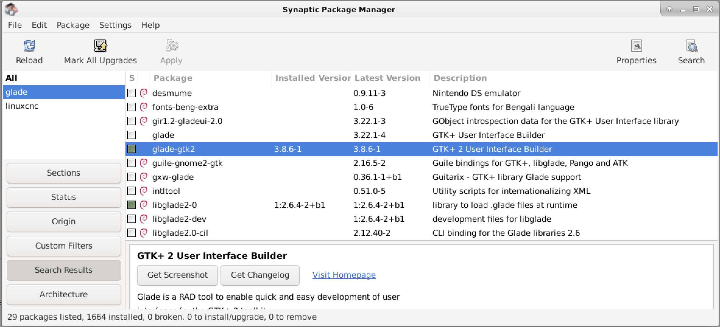

Which version of Glade have you installed? (And which version of LinuxCNC
If you are on LinuxCNC 2.8 then you need the Glade version here: www.linuxcnc.org/dists/buster/base/binar...k2_3.8.6-1_amd64.deb
But it is probably best to get it through the package manager. Make sure that you are getting a package called glade-gtk2.
Replied by andypugh on topic Spindle Load feedback in Gmoccapy
Still no success in setting up glade unfortunately.

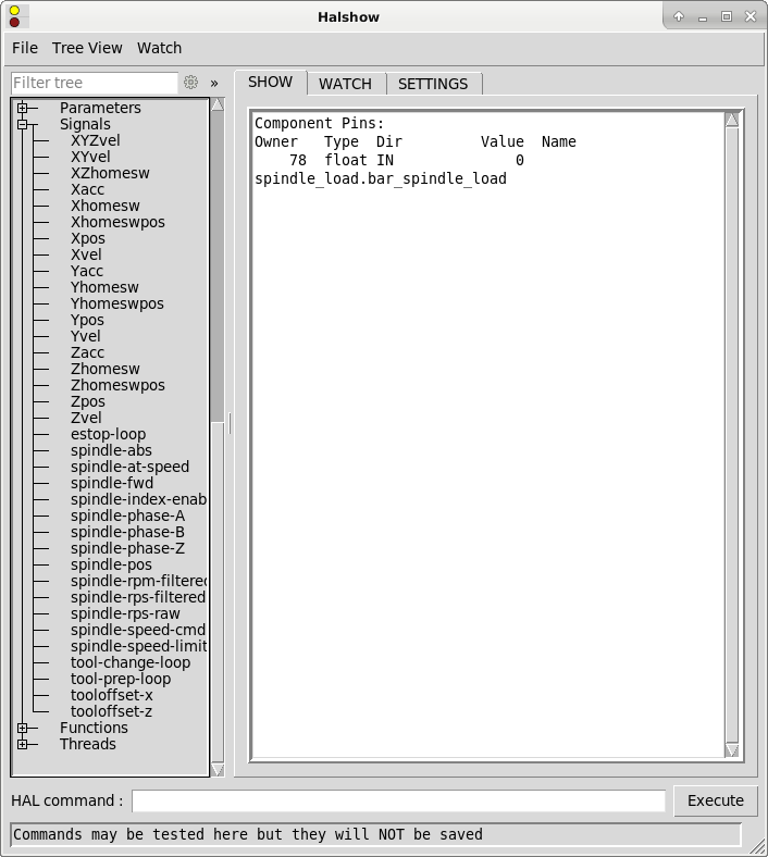

- HansU
- Posts: 723
- Thank you received: 217
07 Mar 2023 18:08 #266050
by HansU
Replied by HansU on topic Spindle Load feedback in Gmoccapy
Maybe you have to connect your pin 'spindle_load.bar_spindle_load' in a separate HAL file which you pass with -H to the gladevcp command.
Like this:
The reason is that the VCP might be loaded after the GUI loading is done and so the pin is not yet available in the POSTGUI_HALFILE. But I am not 100% sure about this.
Like this:
EMBED_TAB_COMMAND = gladevcp -x {XID} spindle_load.glade -H connect-pin.halThe reason is that the VCP might be loaded after the GUI loading is done and so the pin is not yet available in the POSTGUI_HALFILE. But I am not 100% sure about this.

- newbynobi
- Posts: 1931
- Thank you received: 394
08 Mar 2023 06:23 #266094
by newbynobi
Replied by newbynobi on topic Spindle Load feedback in Gmoccapy
If you are using integrated panels in gmoccapy and the panels have there own Hal pin, you have to load that panel with the -H flag naming a Hal file and all connections must be made in that file.
Otherwise you will get race conditions and the panel may work or not.
Hal connections are made in the following order:
- LinuxCNC Hal pin connections
- GUI relatet connections like the gmoccapy pins
- glade panels
so you need to take care in witch file you connect pins.
Norbert
- glade panels
Norbert

08 Mar 2023 16:17 #266122
by zz912
Replied by zz912 on topic Spindle Load feedback in Gmoccapy
I moved spindle_load commands from custom_postgui.hal to gladevcp-zz.hal.
I added "-H ./gladevcp-zz.hal"
But LCNC did not read this file.
I added "POSTGUI_HALFILE = gladevcp-zz.hal"
And it works again.
Flag -H is not working probably. I downloaded branch 2.9 now.
And it works again.

09 Mar 2023 09:23 #266183
by zz912
Simulation of bug:
1) download and build branche 2.9
2) add to linuxcnc-2.9_2023-03-07/configs/sim/gmoccapy/gmoccapy.ini3) copy
to: linuxcnc-2.9_2023-03-07/configs/sim/gmoccapy/
4) run linuxcnc gmoccapy.ini
5) signal "signal-spindle-load" from connect-pin.hal is missing, so file connect-pin.hal was not loaded probably.
I made this test on virtual PC in other PC.
I would like ask for help.
EMBED_TAB_NAME = Spindle_load
EMBED_TAB_LOCATION = box_custom_4
EMBED_TAB_COMMAND = gladevcp -x {XID} spindle_load.glade -H connect-pin.halto: linuxcnc-2.9_2023-03-07/configs/sim/gmoccapy/
