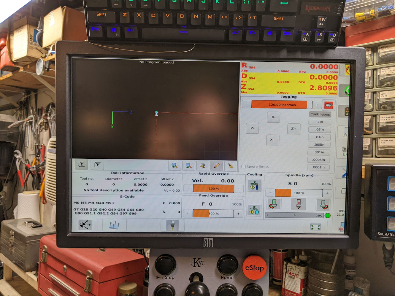

I upgraded from LinuxCNC 2.8 to 2.9.
Now my display does not quite fit the screen. It did before. See attached photo.
Gmoccapy is configured for screen1=fullscreen.
Any ideas?
I realize I can run a windowed version, and set the size. I'd rather have fullscreen, though.
Any ideas?

OK. It's even stranger.
Resolution is 1024 x 768
Running Bookworm rt
Running LinuxCNC v2.9
When I load LinuxCNC and go to setup, Fullscreen is already selected and screen is too wide to fit (photo 1 - Initial)

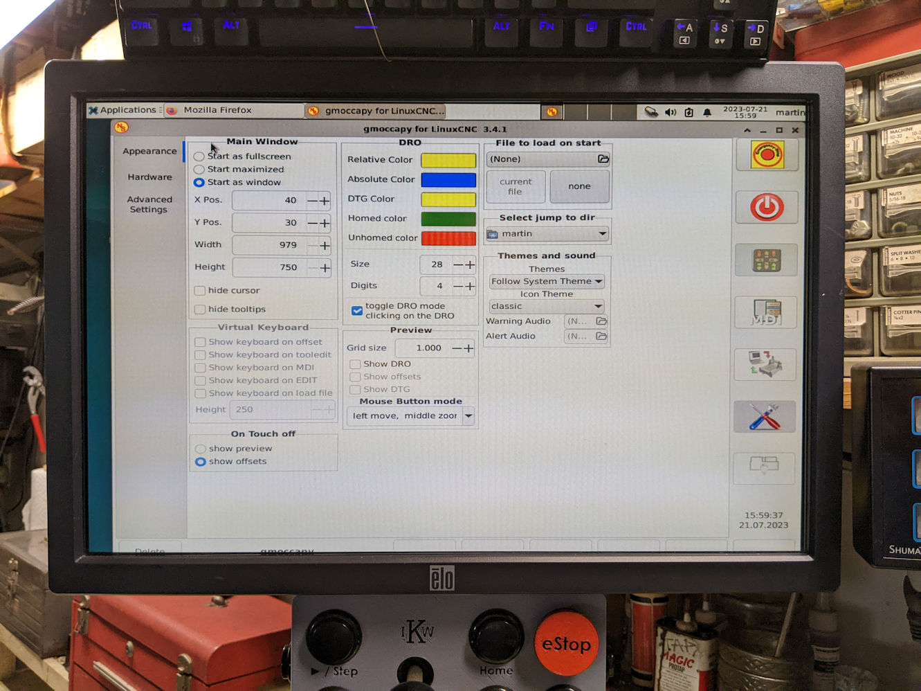

When I click Windowed, screen changes size and fits (2 - Windowed)

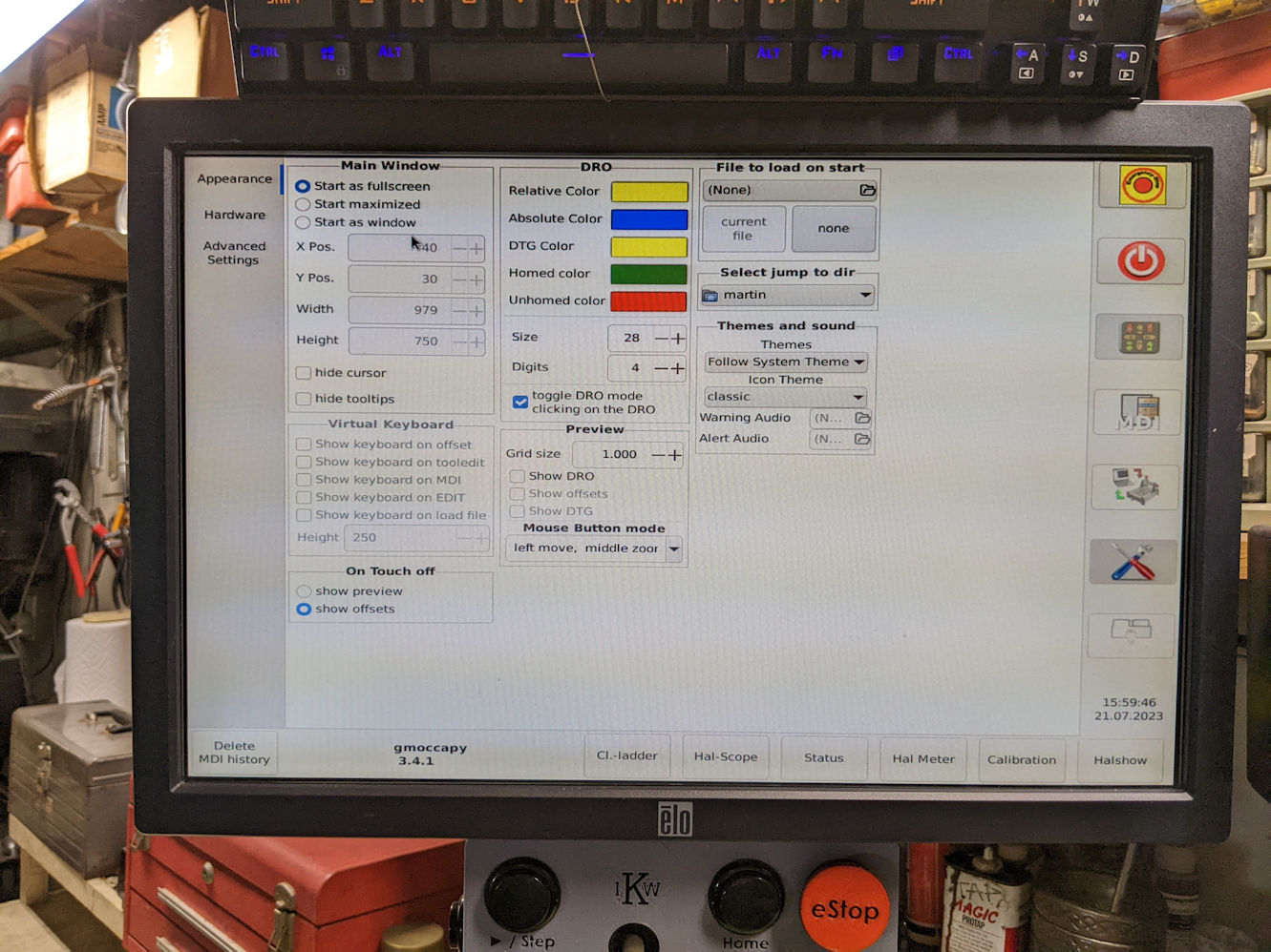

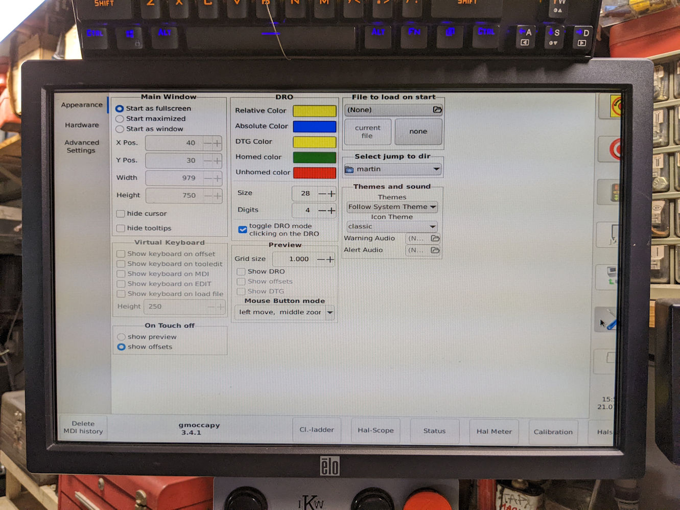

When I click Fullscreen, screen changes size, but now it fits! (3 - Fullscreen)
If on the second step, I click Maximized instead of Windowed, screen is still too wide. However, when I go back to Fullscreen, it resizes correctly.

I changed the numbers to 0,0,1024,768 under "Start of window". I cycled through that option (which worked correctly as expected), and then back to "Start as fullscreen" (which showed the display correctly, as described above). I exited LinuxCNC and restarted. It still exhibits the same behavior where the screen is slightly too big. So, the size of the windowed screed does not seem to affect the strange behavior.
