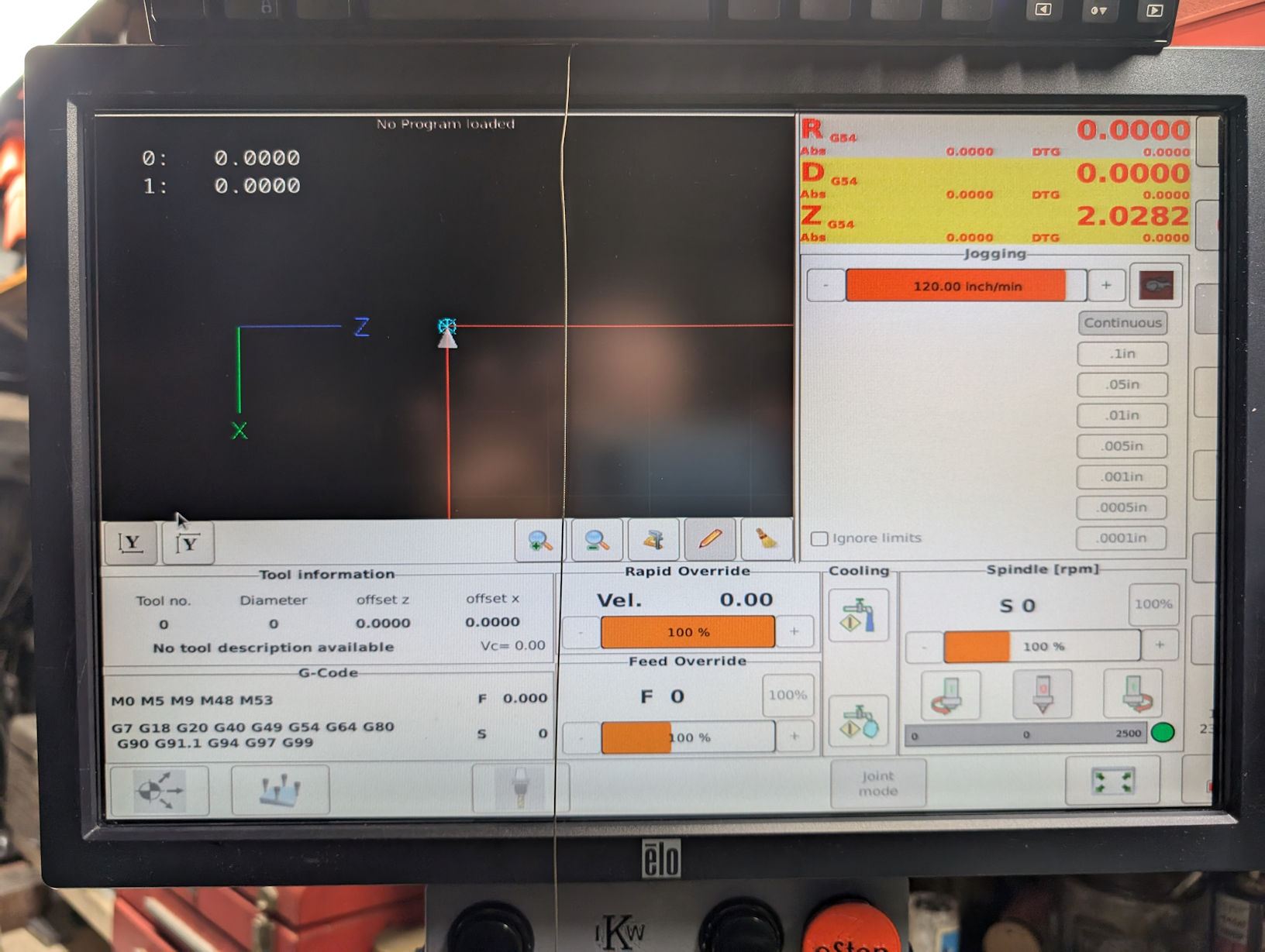

Problem came back! Something updated, possibly Debian, and now my screen is too wide again. See attached photo. What's different is that I can't set it to Start as Windowed and then back to Start as Fullscreen to fix the problem. Also, the modification to Gmoccapy by
alex_sar
earlier in this thread does not work anymore, although it did for 6+ months.
My touchscreen monitor is set for native resolution, 1024 x 768
I have the latest version of Debian Bookworm.
I thought that updating everything might help, so I updated LinuxCNC from 2.92 to 2.93 and Gmoccapy from 3.4.6 to 3.4.8. No joy.
Help me newbynobi , you're my only hope!

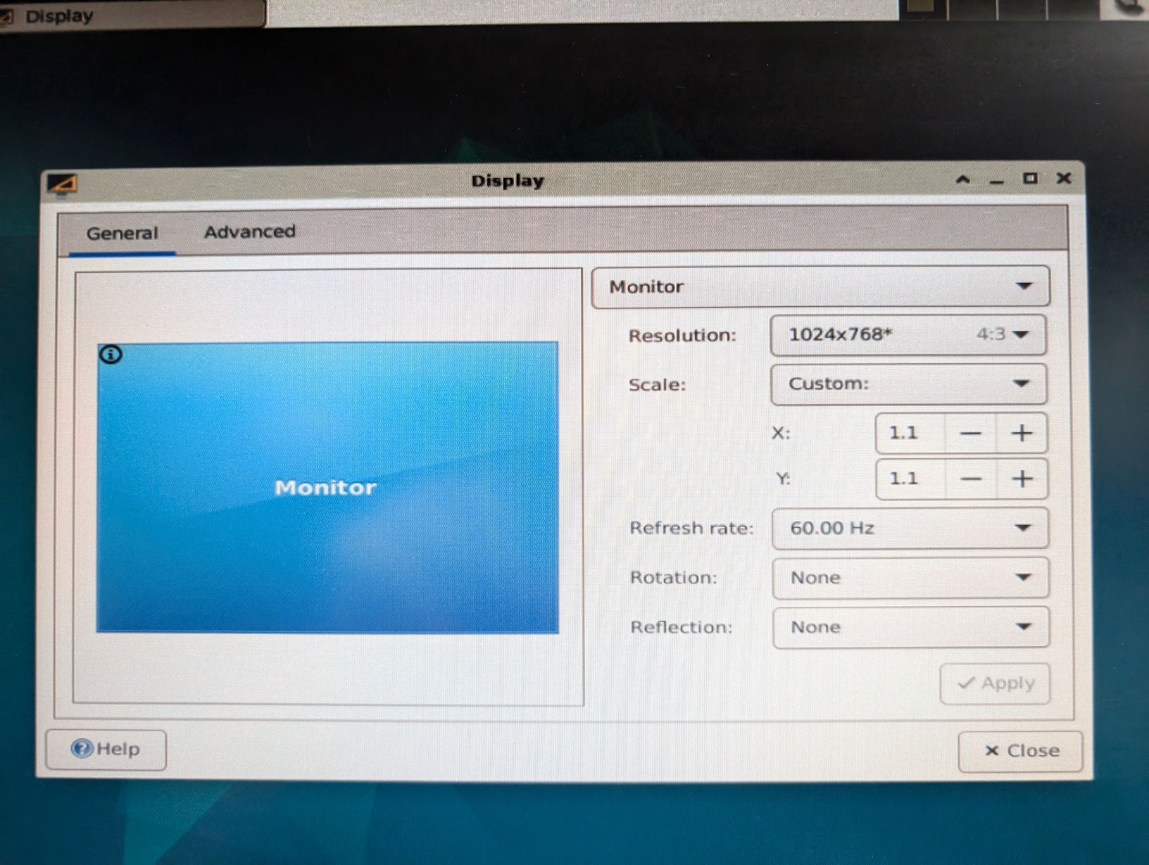

I found a fix!
I'm running Debian Linux. Go to Settings - Display
Under Scale, pick Custom, and set X & Y to 1.1 See attached photo.
After that, the display fit on the screen!

I did a clean install with the 2.9.8 / trixie ISO file, and have the same behavior on a 1980x1080 HDMI monitor, but inconsistantly. Sometimes full screen is correct, and then I get a switch to Gmoccapy not fitting the screen, but I am not yet sure under which conditions that happens.
Scaling 1.1 doesn't help, it just uses 90% of the screen with the gmoccapy still not fitting.
Cheers,
Mark
