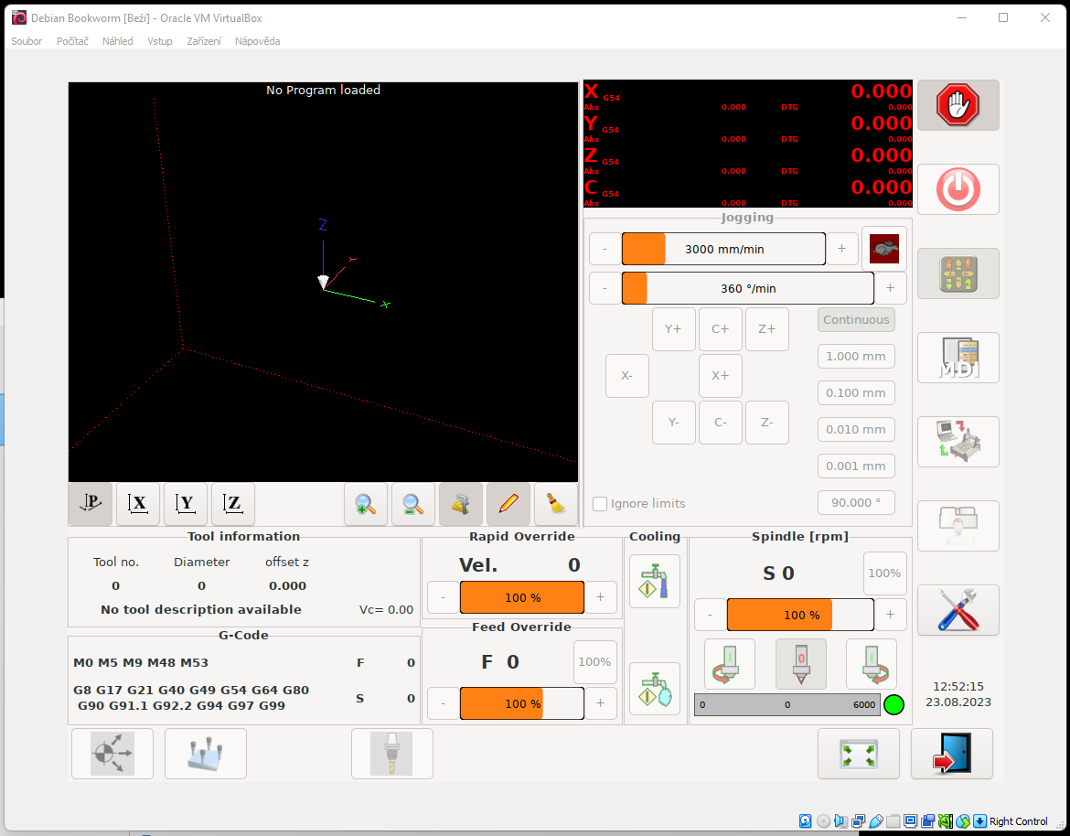

Here's a workaround.
Select the settings icon on the right center of the screen. In the upper left corner of the settings screen, under "Main Window", use the radio button for "Start as Fullscreen", then immediately use the button to reset to "Start as Windowed". That will reset the screen to the correct size. There's a picture of this behavior in my original posts on this topic.
Because this fixes it, it may be caused by something Gmoccapy does when it loads initially that differs from what it does when you click on the radio button to start as windowed.

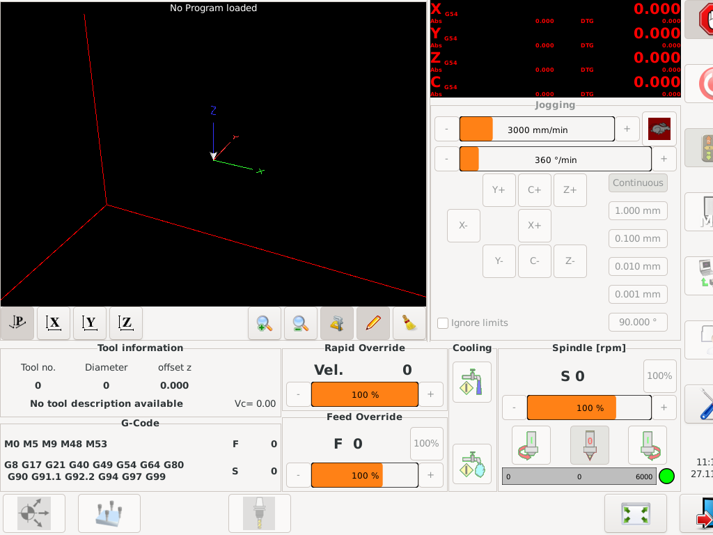

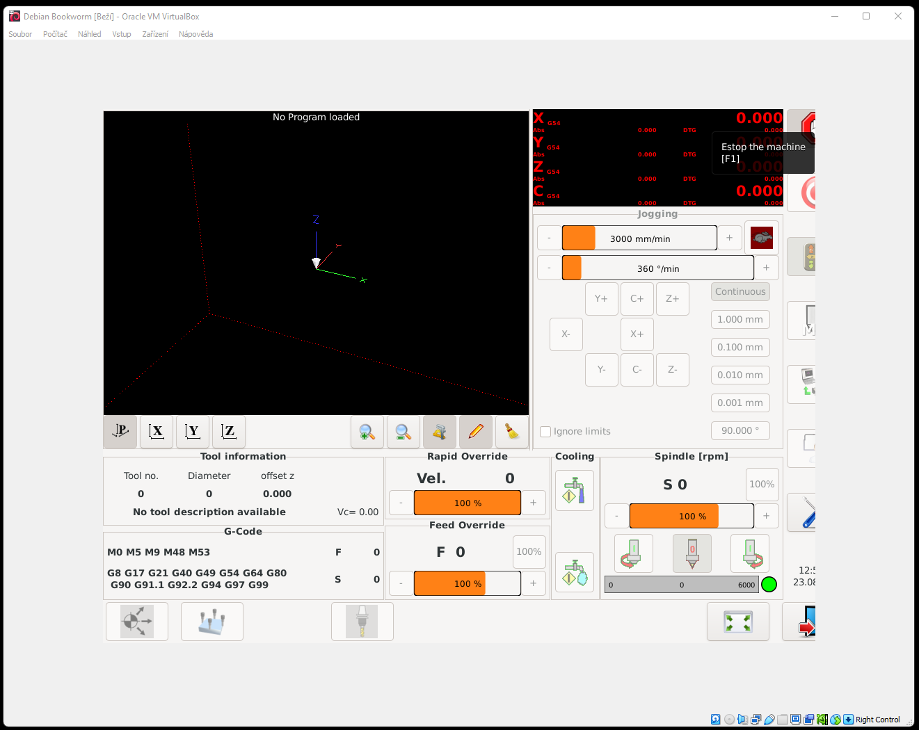

Hello,
I have bad news. I thought I had clear evidence that this problem was the Xfce way, because LXQt didn't have this problem.
LXQt 1024x768:
xfce 1024x768:
This is how it behaves in the Virtual Machine and on my computer at home. I installed LXQt on the CNC machine and the problem persists. Therefore, what I wrote above is not true.

I am another one with same problem
1024x768 , debian bookworm , 2.9
I made some modifications so gmoccapy always start in windowed mode, then I switch to fullscreen and then it works fine. Else buttons go right and I cannot click it.
Seems there is a gmoccapy bug with switching fullscreen mode on startup on small resolutions. Once window is fully open and initialized, problem disappears.
I just tried and it is easy to repeat in VirtualBox bookworm-2.9 linux install
- set resolution 1024х768
- start gmoccapy 4axis sim config (allow copy config to home dir)
- enable fullscreen in settings
- exit linuxcnc
- restart gmoccapy 4axis sim config from home dir
- buttons are out of screen
