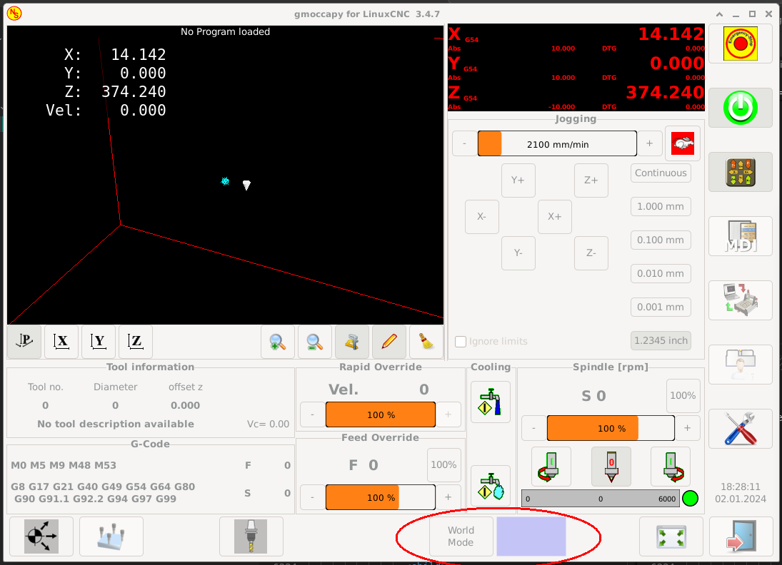

I've found a naive workaround, not sure if it is acceptable as common solution, but works for me.
Edit file /usr/bin/gmoccapy
find line
replace to
find lines
replace to
what does it do? it schedules a timer to enable full-screen with 3 seconds delay and it works like a charm now.
find line
from time import strftime # needed for the clock in the GUIreplace to
from threading import Timerfind lines
if start_as == "rbtn_fullscreen":
self.widgets.window1.fullscreen()replace to
__t = Timer(3, lambda : self.widgets.window1.fullscreen() )
__t.start()what does it do? it schedules a timer to enable full-screen with 3 seconds delay and it works like a charm now.

I have a fix for this. See github.com/LinuxCNC/linuxcnc/pull/2831.
The solution is very simple - just removing one property in the glade file, but it took me a while to get to this point.
The background:
The button "World Mode/Joint Mode" is displayed optional, so there is a placeholder label if that button is not shown. The problem is that at the time the GUI is created (started), the button and the label are active and that make the window too wide to fit 1024 px. The fix is just to have this button hidden at start.

Interesting, I'm upgrading gmoccapy.py and gmoccapy.glade as described at github. Nothing changed. Window is still too width.

I hope most interesting is rewrite glade file. But true is that I have gmoccapy 3.4.6
It helps this fix for you?

I dont copy all files from githib. I copy changes from 3.4.7.1 into 3.4.6 and run 3.4.6
If I copy and run 3.4.7.1 linuxcnc dont start up.
Linux tell me error "dont find interpretter in #!/usr/bin/env python3"
or somethink like that.

You have to copy the gmoccapy.glade file..
