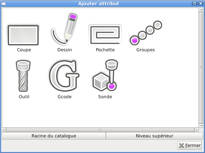

I am almost finished with translation to French. Every strings have been translated but there are some I am not sure because I do not understand fully hox CNC works.
Here are a few screenshots.
When I have it work, I will be able to correct the rest but if some French speaking people is willing to help, I include the language files. Just edit linuxcnc-features.po with poedit and when you save, it compiles automatically to mo. Re-open LinuxCNC Features to view the modifications.
To install the language file, unzip the archive file in LinuxCNC-features/locale folder and follow the point 6 of INSTALL in README.md
Regards
