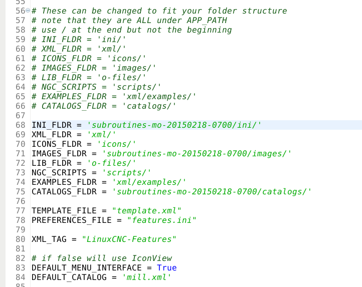

20 Feb 2015 10:09 - 20 Feb 2015 10:19 #56134 by FernV
Replied by FernV on topic LinuxCNC Features - a kind of NGCGUI
Hi Martin,
I was able to load your menu with minimal changes to it, but unable to load any ini, because I think it is because your folders structure is more complex than mine. Also, when loading the icons, it was the large image that loaded. First see what needed to be changed in the variables to set the path and what it looks like when loaded. Subfolders are possible in all path, it then depends of the ini
And writing code to change tools any number of times in a job and use the probe to compensate for length is a complete success
Regards
Fern

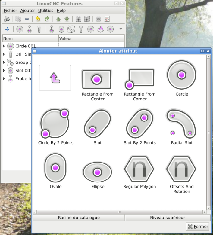

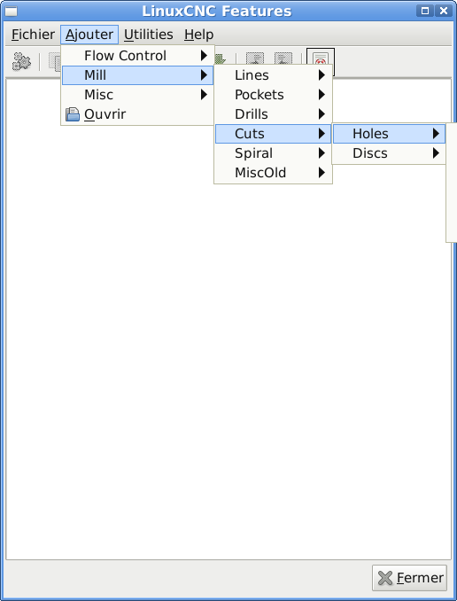

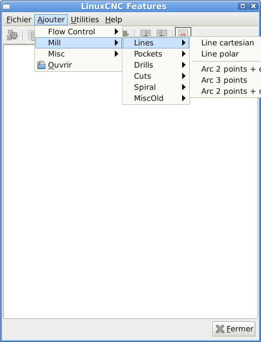

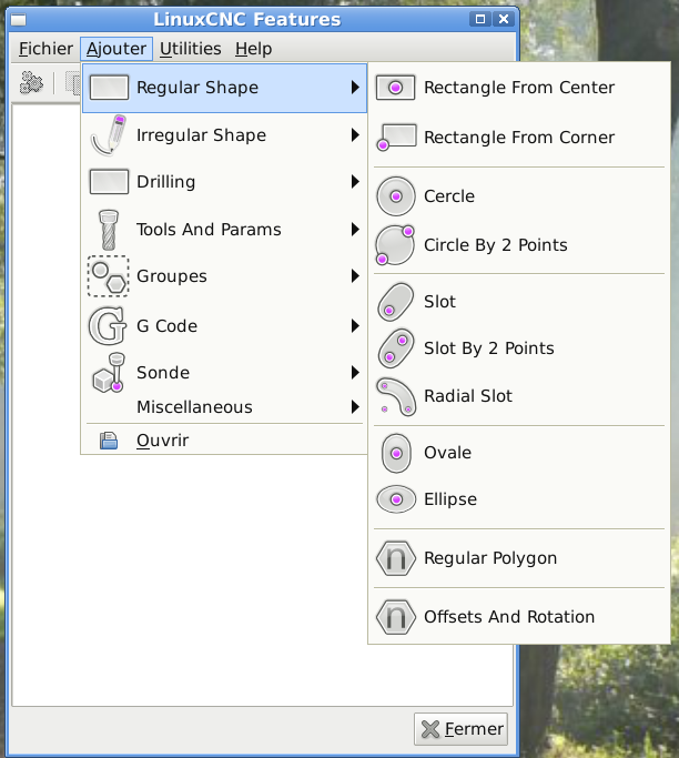

22 Feb 2015 08:55 #56210 by FernV
Hi Nick
It is possible to use larger icons in the menu like this
OR
combine menu AND iconview like this
It is just a matter of selecting True or False in features.py
What do you think ?
