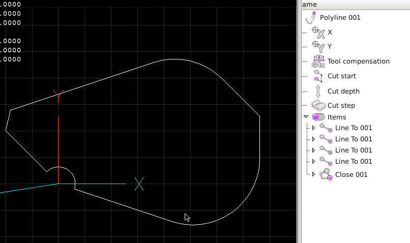

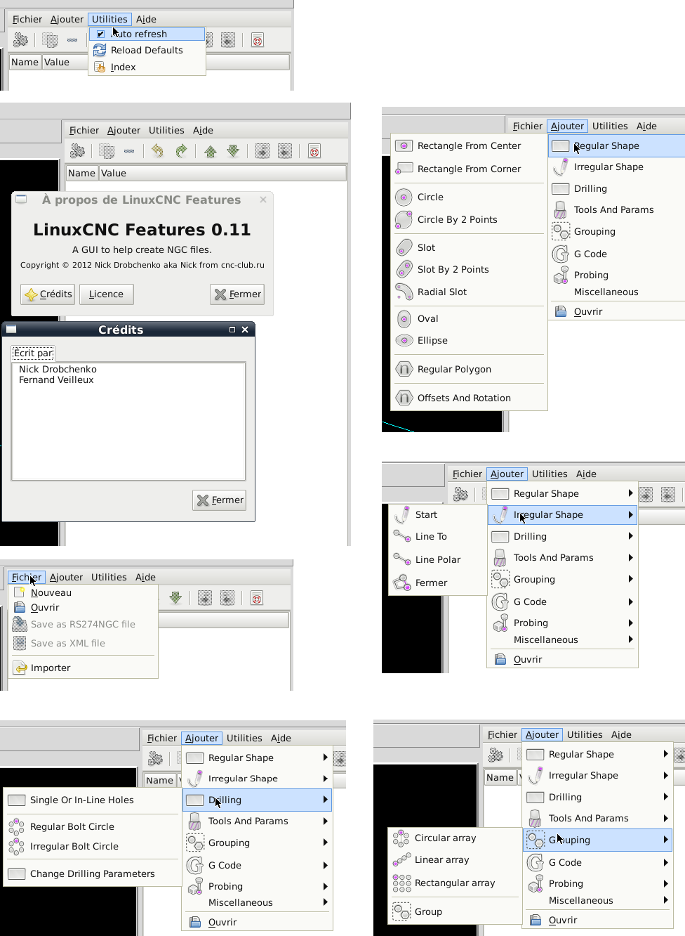

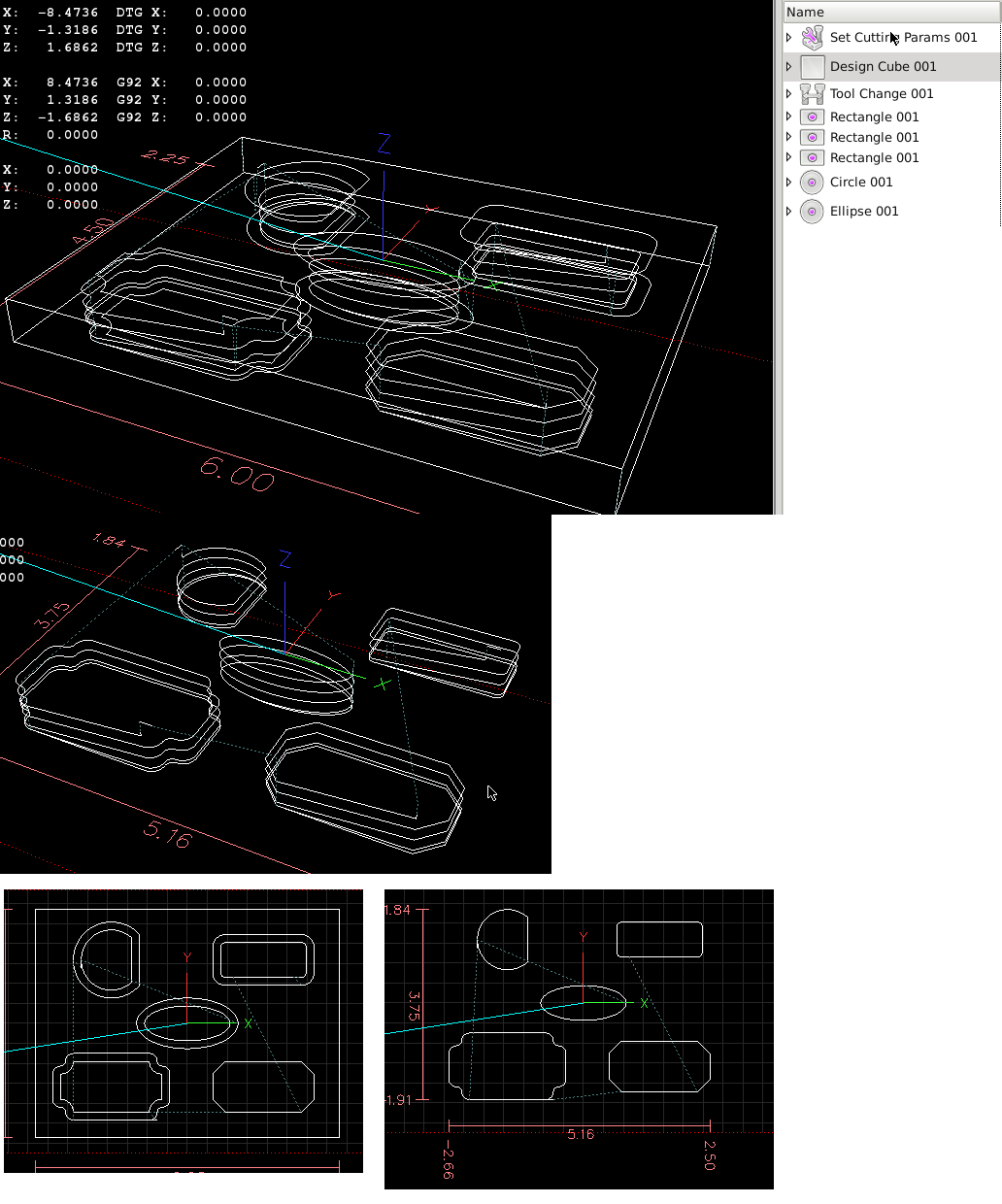

Hi Martin
Hera are some screenshots
I prefer menus
This one shows a design bloc and reference lines that diasppear when '/' is toggled
Not sure I need to add arcs to this
This week I will try to solve the problem of copying where the ID is the same
Next thing I would like to see is this :
When many features a added and expanded, the tree is a little confusing. I intend to split the view in 2 where the top one would only show the header and items and the bottom view would show the params of the selected feature. What do you think about this ?
Regards
Fern

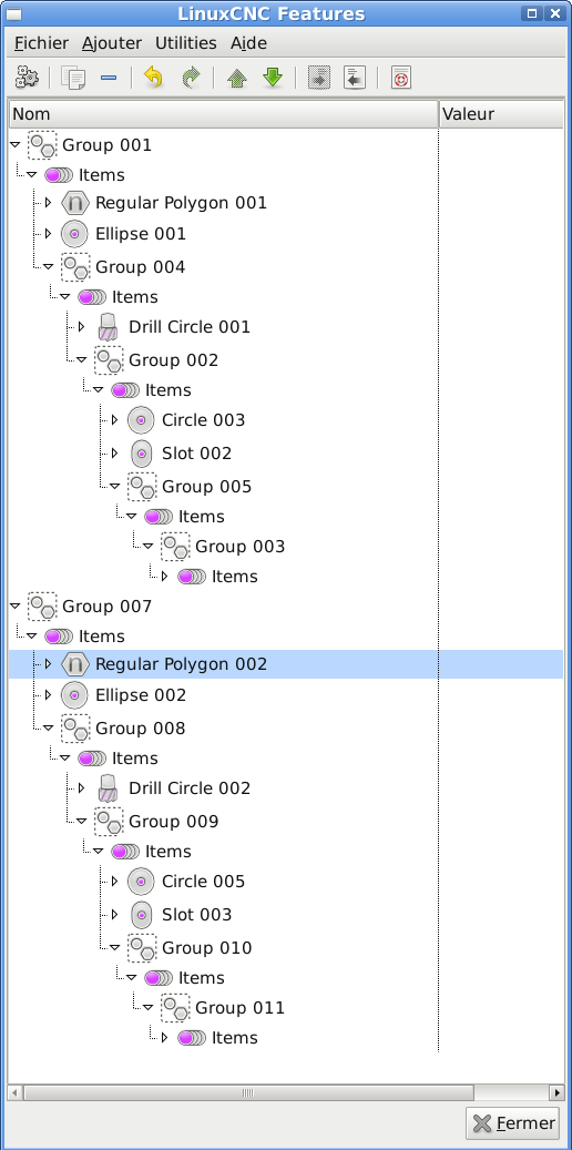

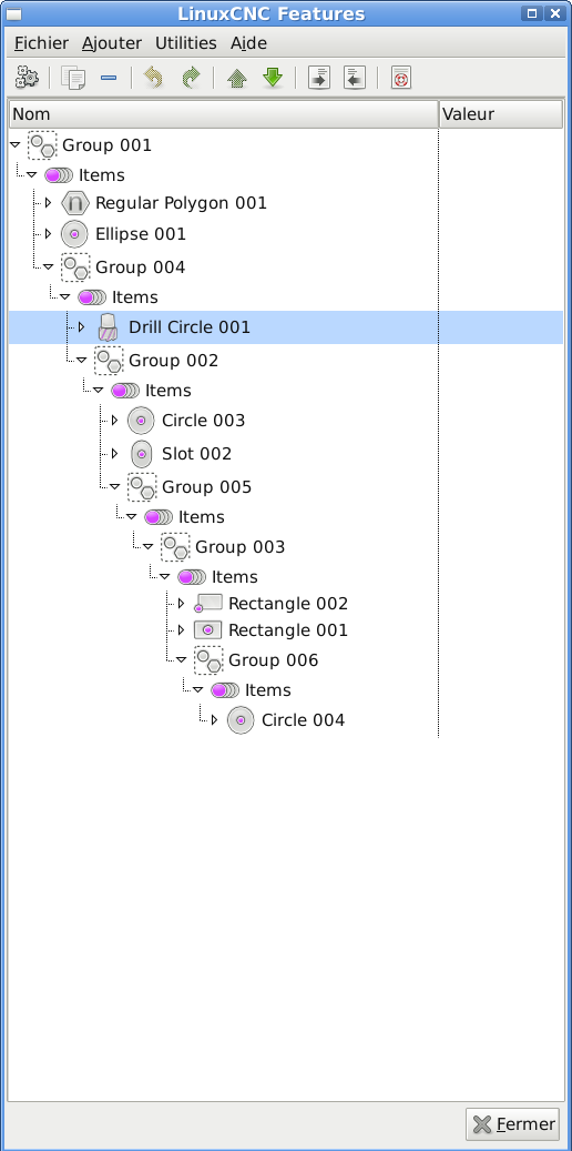

Problem with copy is SOLVED
This is before (note how deep levels can be)
No 2 elements have the same id
This is the function to replace the "Features.copy" one
I adapted the code for unmodified file. I hope it works for you
(I will later modify "import_xml" to copy to a specific position, only possible with File:Inport XML)
Regards
Fern

- Nick
- Posts: 125
- Thank you received: 11
17 Feb 2015 18:27 - 17 Feb 2015 18:28 #56051
by Nick
Replied by Nick on topic LinuxCNC Features - a kind of NGCGUI
Wow!
Great work!
Menus is a good option, we need to find a way to combine them, or make a choice between menus and big icons.
Btw have you already made those menus from those screenshots?
Great work!
Features was originally intended to work with touchscreen, that's why there are huge icons in the catalog.I prefer menus
Last edit: 17 Feb 2015 18:28 by Nick.

17 Feb 2015 21:54 #56053
by FernV
Replied by FernV on topic LinuxCNC Features - a kind of NGCGUI
Hi Nick,
The "Add" menu part is defined in xml file similar to what you did and can be easily modified to suit needs. The base menu is part of "features.glade"
No change to ini files is needed.
There are different ways to make both as options:
It could be available as 2 different download or in the same download with 2 different folders, but it would be more difficult to maintain and improve, better in one file only
but we must consider that it would have all to be done by code instead of "features.glade" where I removed bars and added the menu. But by code would have to be done only once. I think it would be the best way.
I will post the needed files if you have a real interest in this
Regards
Fern

18 Feb 2015 14:34 #56063
by turbospeedskater
Replied by turbospeedskater on topic LinuxCNC Features - a kind of NGCGUI
Hi Fern,
wow...... looks great!!
I would also prefer the menues!!
@Nick: Big pictures and touchscreen sounds good, I also have a touch screen on one of my machines, but:
During work with dirty fingers you allways have a dirty screen. So I don't use my touchscreen anymore. A mouse
will also work when it is dirty.
