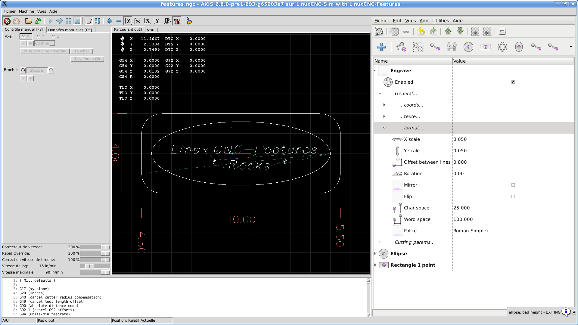

I succeeded with the integration of engraving in Features.
One screenshot
Simply replace process function with this code

In mz_engrave.ini
Delete the [COMMAND] block completely
Change the [CALL] with this
[CALL]
content =
 	o<#self_id> if [#param_ena]
 		<subprocess>./lib/engrave-feature.py -X#param_x -Y#param_y -S#param_xscale -s#param_yscale -Z#param_s -D#param_dpt -A#param_rot -W#param_word -C#param_char -M#param_mirror -F#param_flip -f#param_font -0'#param_line0 ' -1'#param_line1 ' -2'#param_line2 ' -3'#param_line3 ' -4'#param_line4 ' -5'#param_line5 ' -6'#param_line6 ' -7'#param_line7 ' -8'#param_line8 ' -9'#param_line9 ' -y'#param_yoff'</subprocess>
 	o<#self_id> endif
That is all.

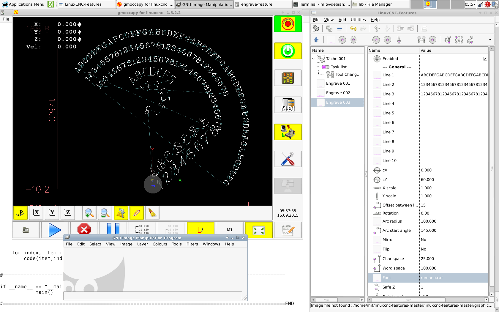

It will receive a big rework. You will be able to postion text referenced by angles, center, center of arc, align text keft, right, center, all parameters will be visible in G code, all those variables and sub are already renamed. If anyone can think of anything else please share you ideas.

24 Sep 2015 00:06 #62897 by fixer
Replied by fixer on topic LinuxCNC Features - a kind of NGCGUI
I am a little busy lately, but am still working on engrave feature slowly. I have some progress, now it supports QCAD 3 fonts, have a working ttf2cxf tool. I use xy-rotate from features instead o9000, almost everything works ok.
But, of course I have come to the limitations of my programming knowledge. I have trouble dealing with unicode strings. Until I pass ASCII chars to python script it works, but when I use any of non ascii char, it starts to throw exceptions...
Is anybody here willing to help with this issue?
And we will need some kind of CXF font optimizer - some chars, that could be made with single or only a few strokes are divided in many different strokes, each next stroke starting away from the last stroke end. The produced g-code is then full of unwanted rapid moves... I think it would be best to write a script, that would optimize the font and then write it back in cxf format. If anyone is interesed to help here I can send the collection of 45 fonts that I have currently. CXF format is pretty easy to read in, it would just need some kind of "sort points by distance" alghoritm.
