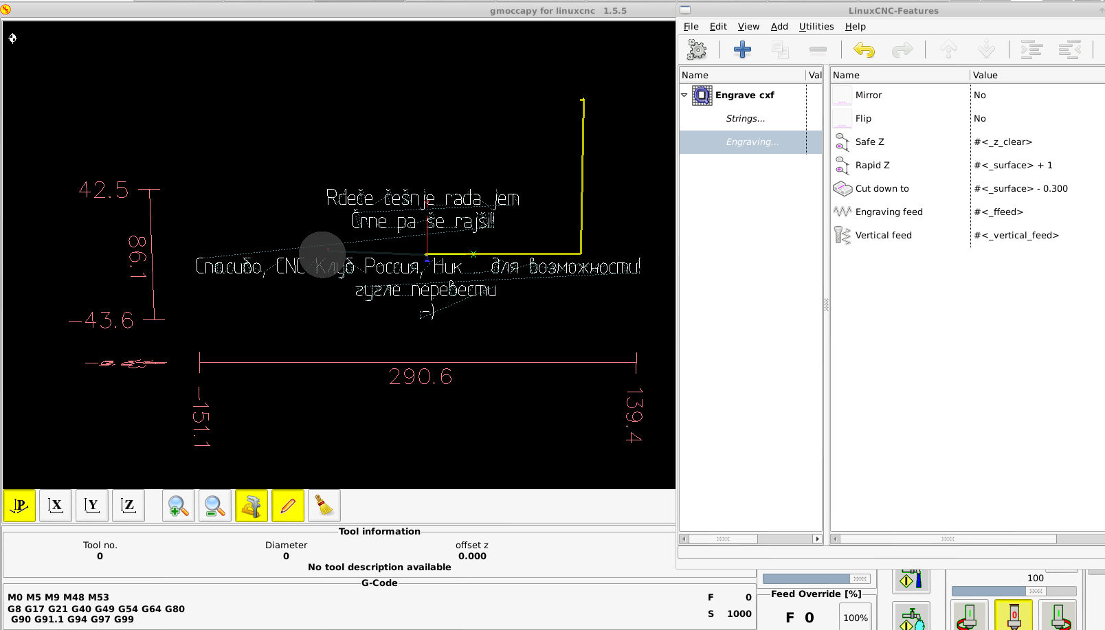

This is absolutely GREAT! You did a lot of work here, and I personally am very thankful for this! Polyline feature looks very interesting! Some kind of lead-in move and cutter compensation needed there.
I commented out treeview.expand_all() in line 2558. I dont know what you mean with it, but it works better without it IMHO - it shouldn't expand everything in main tree after adding feature.
I will try to do some work on cxf engrave, I am not sure what is wron with identation. It looks like my editor is doing something funny there, i am still using mousepad...

06 Oct 2015 00:10 - 07 Oct 2015 01:12 #63451 by fixer
Replied by fixer on topic LinuxCNC Features - a kind of NGCGUI
Tell me if you like it better this way ;
Yep, better.
I did my homework too - attached new engrave feature, support for unicode strings and fixed exceptions in main().
It's your call, but i think it is better to have default values to be like that^^ , imperial would be
#<_surface> + 0.1
and
#<_surface> - 0.01
And remove that G0 moves loop in defaults, leave only debug message, M0 and loop.

07 Oct 2015 01:33 - 07 Oct 2015 01:47 #63512 by fixer
- above I have replaced engrave-feature, use that one now.
-I would replace top features with features history.
-SafeZ and surface are set with task. this should do the same move in all subroutines. SafeZ is set above all fixtures, so you cannot hit anything no matter how you arrange your subprograms, surface is where the material starts (cut start). Safe Z is only used in first tmove from previous operation to start of engraving, Rapid Z is where G0 moves between characters are made. First vertical move is from safeZ to rapidZ, from rapidZ to depth is G1 with #_vertical_feed
Make it so that the users will clearly know what are you doing underneath.
And there is a missing underscore _ in mz_engrave.ini at font combo at file Cyrillic_II. And font Sans NS doesnt work, best to delete it from features.
-about ttf it looks there is some kind of problem with trajecotry planner there. With default values, when it comes to engraving of letter "u", the machine starts to move somewhere far away on Y axis - move is not shown in simulation, only when you start the machining... Set your soft limits in simulation linuxcnc ini file to +99999999999 and -99999999999 so it doesn't warn and you will see. I never used G5 moves and I dont know nothing about how is the preview drawn differently to real machining, so i cant really help...
Last edit: 07 Oct 2015 01:47 by fixer.

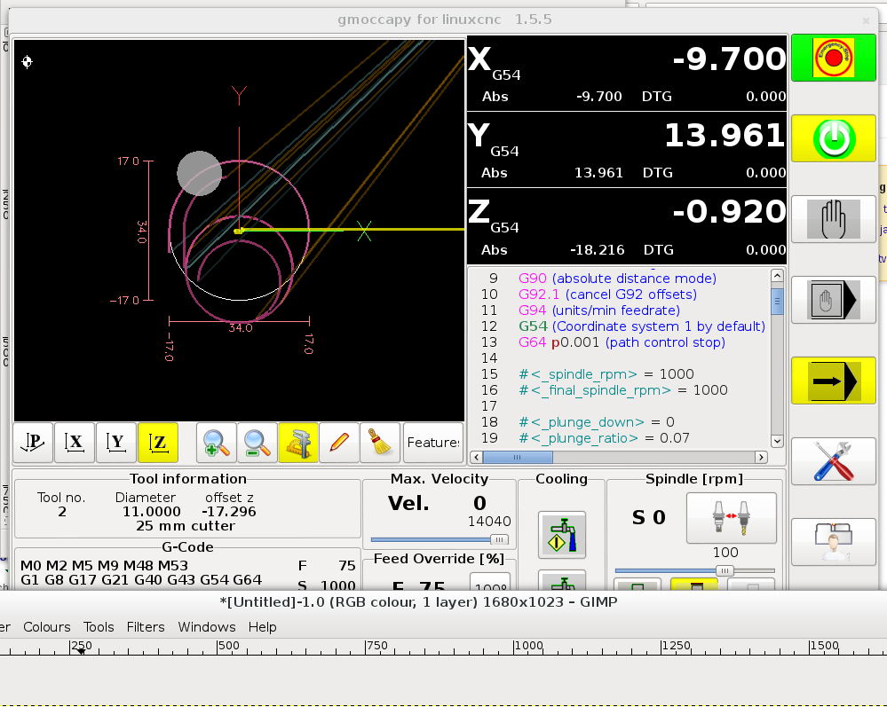

26 Oct 2015 02:20 #64258 by fixer
Something strange I noticed and I am not sure where the problem is. Can you please try to duplicate this:
Using metric units, make a tool with a diameter of 40mm
do a T0M6 in MDI
in features, put only tool change to that tool above
and a circle, dont change any parameter, only tool number
watch LinuxCNC status, variables dtg and distance_to_go while lead-in move and compare to DRO (type linuxcnctop in terminal)
Change tool diameter to 10mm, do a T0M6 in MDI and only repeat start of previous program.
The problem is, that the lead-in move doesn't get executed with big tool, distance_to_go in linuxcnctop is decrementing, but the axes don't move. After the lead in move is finished, it continues to cut a circle on the wrong position. It costed me an expensive tool, destroyed workpiece and a whole afternoon figuring out what actually went wrong.
The following screenshot shows path moves by the same program with only tool diameter changed.
I use lcnc 2.7, features 2.01, with some GUI changes in gmoccapy.py and features.py. Changes should not affect machine moves.
