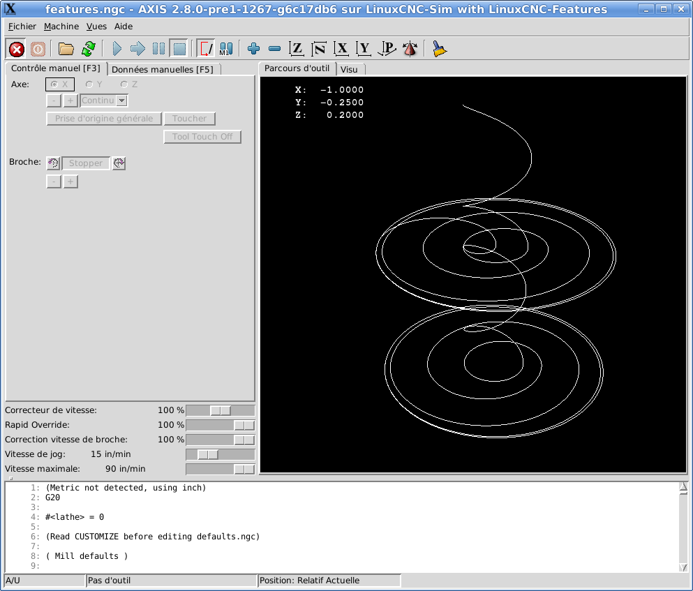

I was going to write to you about this : spiral mill (by layer)
I tried to follow your suggestions on the matter. As I am sure you can see, it will mill the center to a z value then expand, return to the center, mill the center to the next step down then expand again then finish the last bite (if defined) at a different feed/spindle speed for a defined number of passes (>= 0). About all I have to debug is stopping loops and when changing feed/speed. Once done, it will be available to all base shape. Any suggestions to make it even better ?

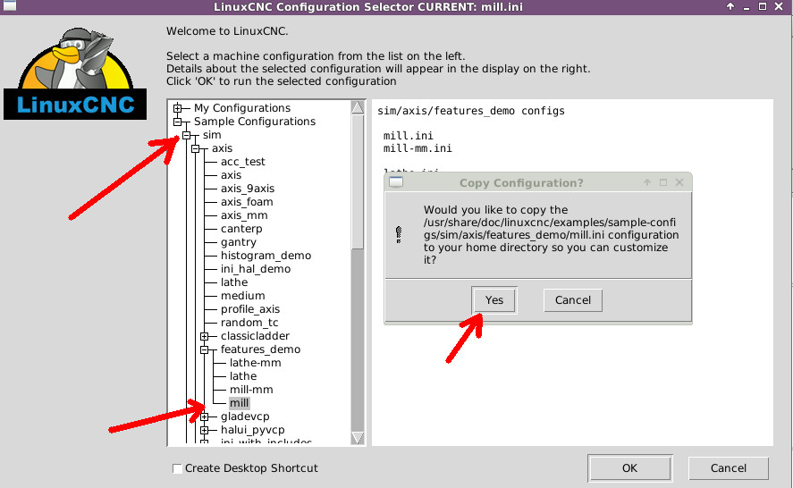

I have been working with Lcnc team to include Features in the distribution. I am using all my dev time to this. I do not know exactly when it will be released but I will not make a personal release anymore, working on only one project is enough.
If you want to try it, it is available as a buildbot dist
buildbot.linuxcnc.org/dists/
I am not sure yet how to install it, but I will let you know when Ido

05 Dec 2015 16:38 #66467 by dgarrett
Replied by dgarrett on topic LinuxCNC Features - a kind of NGCGUI
And the latest news...
The LinuxCNC git tree now includes a testing branch named 'features_preview_2'
When updates (commits) are made to this branch, the LinuxCNC buildbot will attempt
to build deb packages. If successful, the deb packages will be available
for a _limited_ time on the buildbot as 'scratch' debs for testing.
(A deb build may fail if there are compile errors or if the runtests suite
fails on any supported distribution/architecture)
Instructions to install 'scratch' debs are included on the buildbot
home page:
The scratch debs make it possible for interested users to help by testing a
deb install and reporting problems).
The 'features_preview_2' branch has been rebased on the LinuxCNC 2.7 branch
so after some period of testing and validation, the 'features_preview_2'
branch can be merged into the 2.7 branch and made available to all users
updating an existing 2.7 installation. There is no schedule for this.
Note: As of today ( Sat Dec 5 16:32:34 UTC 2015), there are no scratch
debs for the 'features_preview_2' branch. When a new update (commit) is
made, a successful buildbot build will create debs within a couple of
hours typically.
The buildbot status showing recent activity can be viewed at:
buildbot.linuxcnc.org/buildbot/grid
The grid shows all recent build attempts for both mainline and testing
branches.

spiral mill:
almost ok, but should be like this (for circles):
1. spiral plunge to depth per pass
2. spiral clear pocket with feed, but leave some stock for the last pass at the wall
3.clear the wall (last spiral) with different feed (finnishing feed and rpm)
4. repeat 1-3 until last pass
5. last pass could also be cleared with different feed
with that strategy you can mill a lot faster and cut pockets to a few times the cutter diameter in depth in one pass.
this is ok for circles and elypses, and maybe polygons. Squares and rectangles should also be cleared like circles, until the mill touches one of the walls. Corners should then be milled with different strategy.
Tool receives the most stress when entering corner, because the "cutter engagement angle" quickly rises - more info here www.mmsonline.com/articles/the-promise-of-high-cube-machining, or google "constant cutter engagement".
something like this:
If you think that this is too much work, you should at least use different feed when entering corners on polygons.
