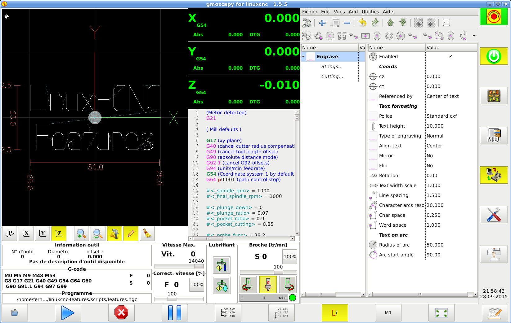

attached engrave-feature + fonts from qcad git + converted stick fonts from here + ttf2cxf.
Need some help in converting strings manipulating functions to support unicode.
Since we can not know what fonts someone has on his computer, we can not use a combo unless including all the font files in a specific directory.
I was thinking of including fonts with Features, because people normally dont have cxf fonts installed on machine controllers.
still, great idea on file chooser dialog. I am thinking about dwg2gcode and image2gcode feature, were this will be useful.

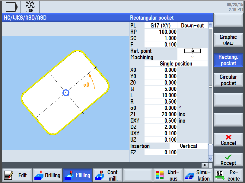

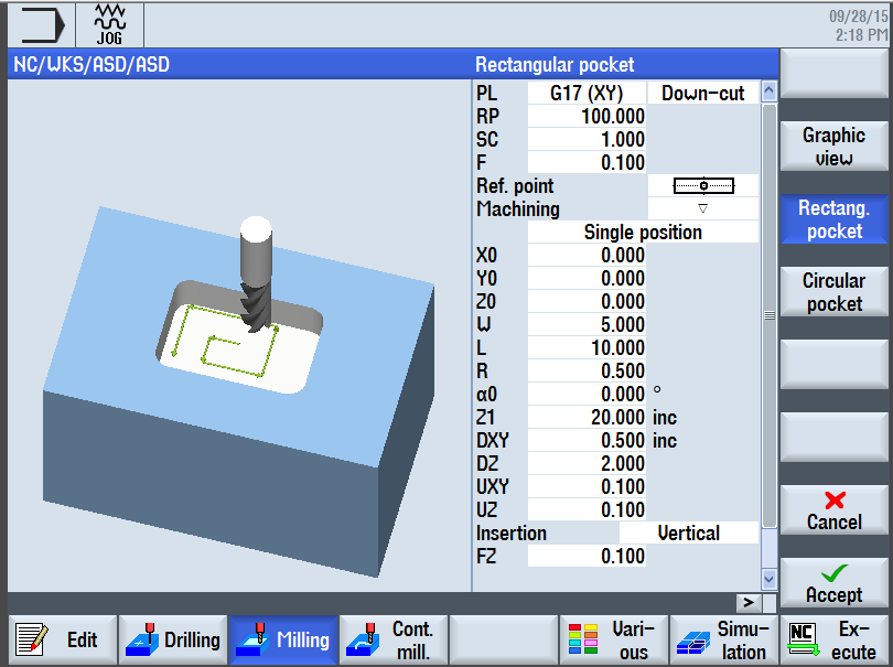

First I want to say that Features is the best CNC program input mode ever made among all CNC controls. I just want to show how Simens did their job with "conversational programing". Everyone can try that with "Sinutrain", with 30-day time limit for free.
Cycle input - parameters names are strange at first, but it changes pictures when you list trough them, so it is very intuitive
The program then looks like that. Cycles are just a normal subprogram call, but when you put cursor on that line and press a button you instantly get back to cycle input screen so you can change parameters.
I would do something similar with integrating Features in gmoccapy.

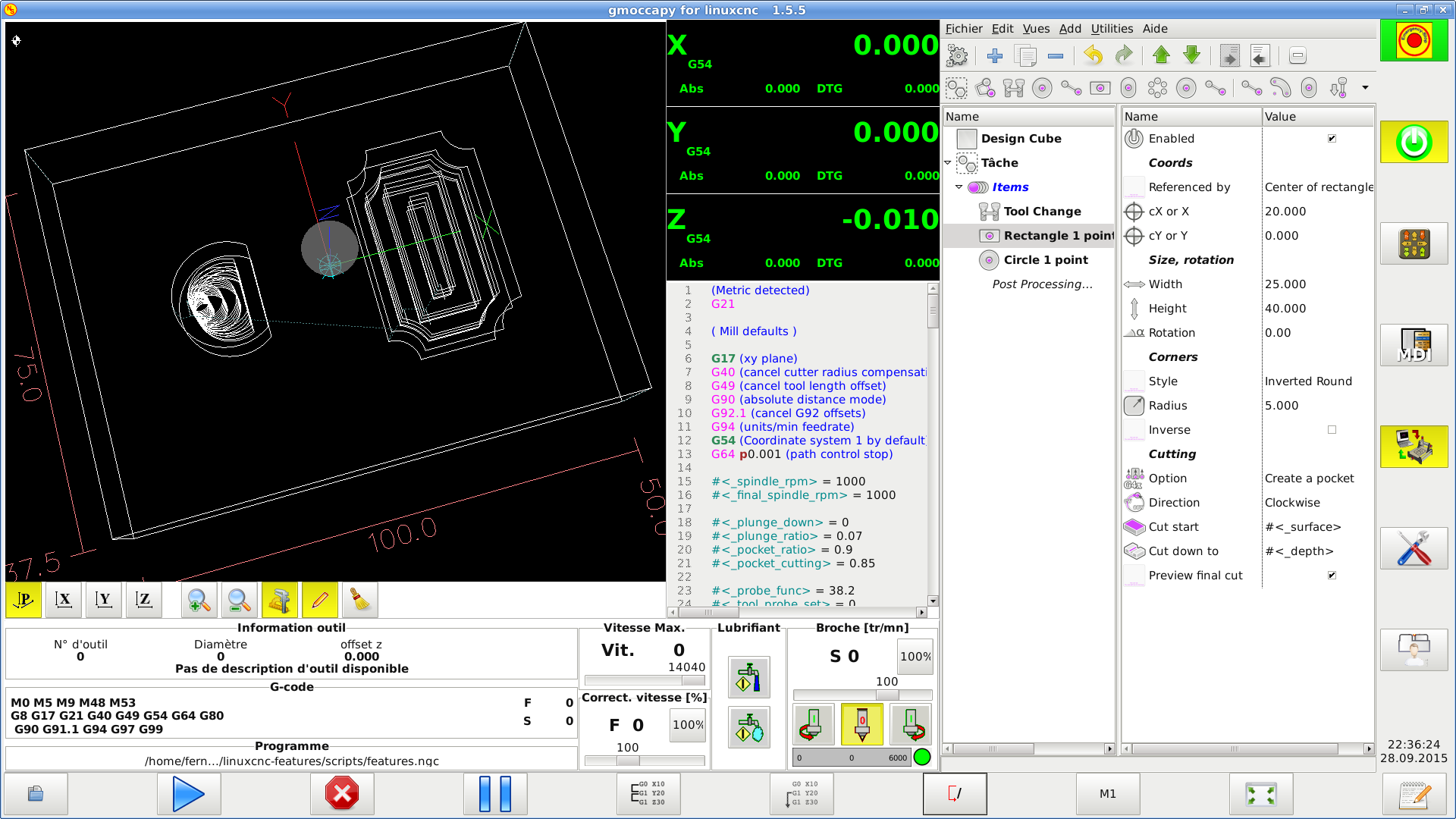

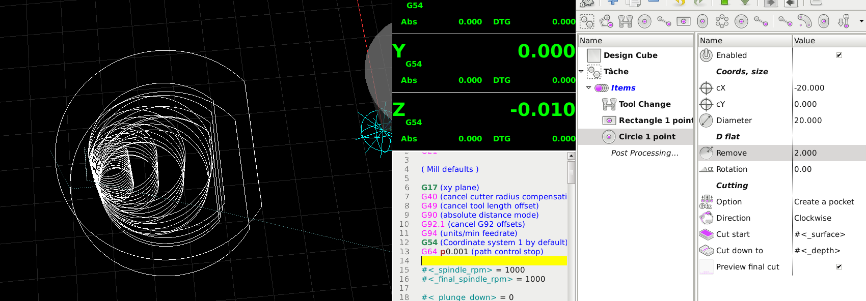

Lastly, for your information, ALL basic shapes (circle, rectangle, slots, ellipse and polygon) have the option of creating a pocket without voiding any of their other options.
It is on my task list of revisiting the ngc files after I uploaded latest version because pocketing does not spiral but start with the smallest size, mill it then enlarge until the pocket is created at the full size. I think it could work with smaller, less powerfull milling. I will add the option to spiral.

30 Sep 2015 02:35 #63224 by fixer
Replied by fixer on topic LinuxCNC Features - a kind of NGCGUI
Hi Norbert,
Maybe you could add dynamic user tab, that would open from the right side and cover complete right half of display (axes, program, spindle,..) like a dynamic toolbars that we are used on some windows programs. So one could just hide it when not needed. On 15 inch toucshcreen it is indeed hard to work with embedded tab. I personaly use features standalone on top of gmocapy, but I have to constantly ALT+TAB it, because I dont have a mouse on machine, only TS and keyboard, and I want to get rid of the keyboard too.
Fernand,
New version looks GREAT!
Thanks for testing and the comments about my engrave. I wil try to fix mirror and flip bugs as soon as i find the time. Get rid of pre- and postamble, just put a string containing one space ' ' in INI instead of #param_.... .
about those fonts, they are not following the QCAD3 standard, so they dont work. I forgot to exclude them. If someone has the time, it should be easy to translate to qcad3 format, just open fonts in text editor and you will see the difference. Until then, we should just exclude them, there are enough fonts anyway.
Pockets could really be reworked a bit. Circles and similar shapes could be easily done with spiral moves, but for squares and rectangles, I would go in an alternating arc moves, so you could achieve some kind of constant cutter engagement in material. Sharp edges and direction changes should be avoided as much as possible, or at least feed lowered there. I would do something like that:
-1. spiral plunge to per-pass-depth
-2. spiral or some other kind of pocket rough with some stock left for finishing
-3. finishing inside the pocket cutting leftover from roughing on the walls of a pocket.
-4 repeat 1-2-3 until #_depth
Maybe I will try to do something there ^^....

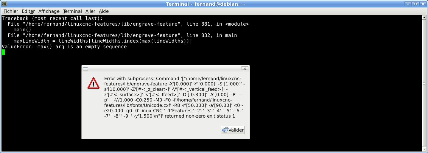

I just tested/debugged engrave-feature and here is what I found.
GreekP_xxx.cxf identifies a character as '[A]' while all other font files that work identifies it as '[0041] A'
If I change '[A]' with '[0041] A', it works.

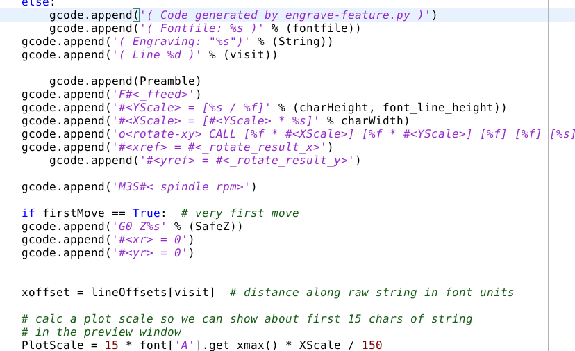

I can not edit engrave-feature because of idents, look what I get
and trying to reformat does not do it simply, I would have to do it manually and understand all your coding.
I suggest you change something in parse function in the 'for text in file:' loop to identify when it starts a new character in both format '[A]' or '[0041] A' and add it to the dictionnary. I also noticed that these are the only lines that start with '['
Presently ALL 'L' lines are added but no ID. That is why these lines raise an exception

I also noticed that Unicode.cxf was not in the fonts directory but worked after I downloaded.

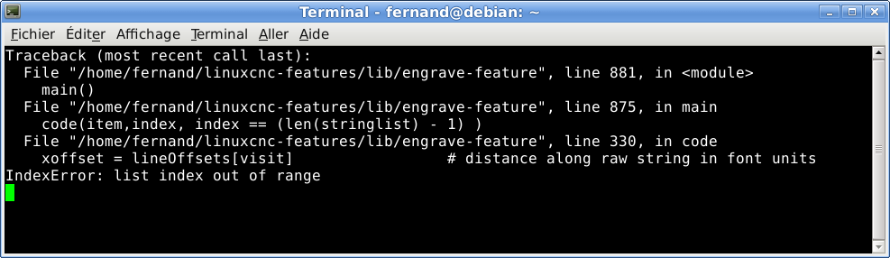

Symbol_Astro and Symbol_Misc2 return a different error code 'list index out of range'. Last char for Astro is 'F' and for Misc2 it is 'K' but even trying Astro with ABCDEF, it throws an exception until I added a new line at the end. Same happened with Misc2 and 'K'.
My conclusion is that these 2 font files are OK but limited in their rendering.
Fern
I will do something about that later.

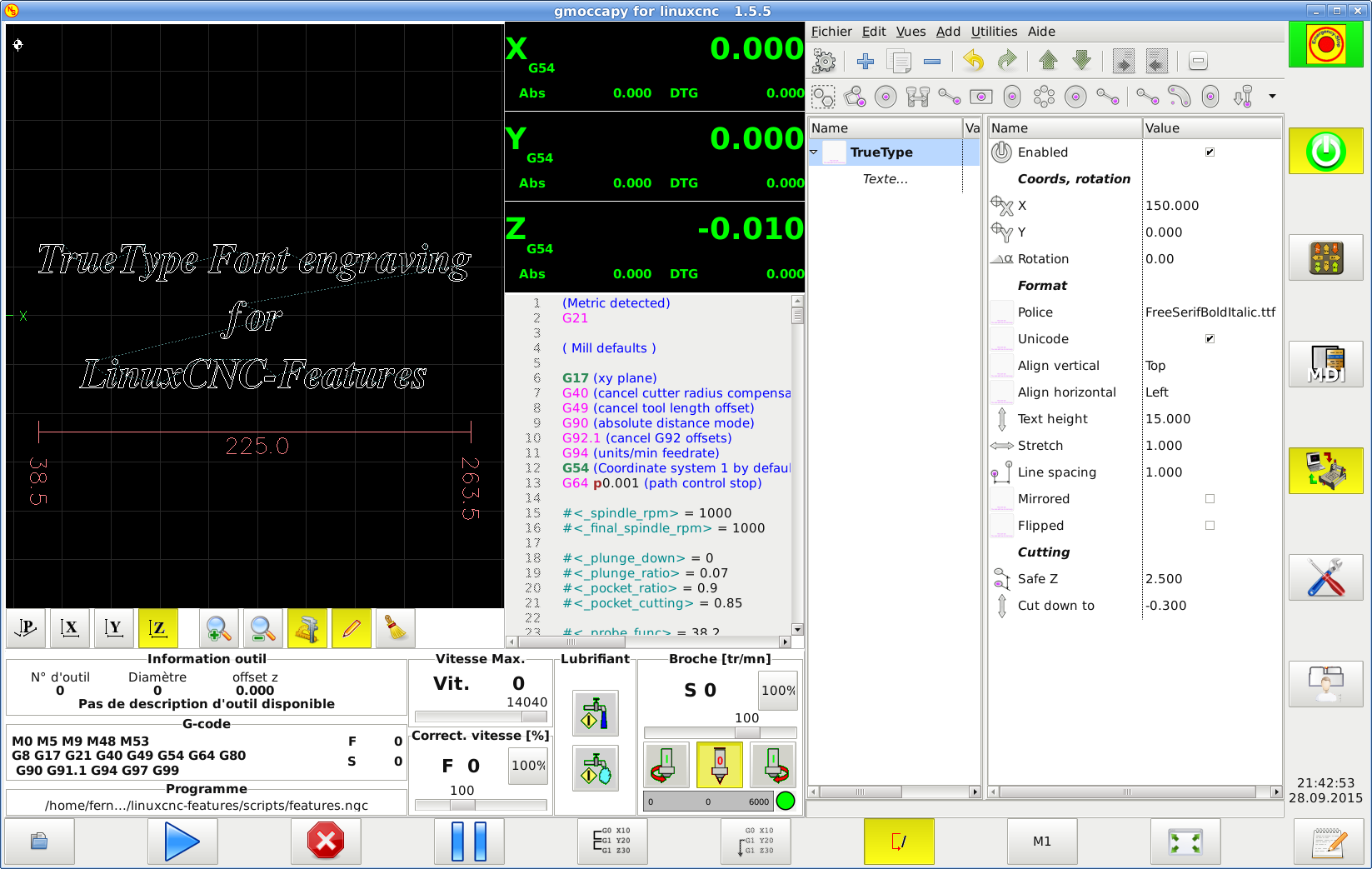

Something I found in TrueType Tracer did not make much sense to me. When using flipped+mirrored together, the result was the same as rotating 180°. I edited to use a 'mode' with 3 combo options : Normal, Mirrored, Flipped
Now only one option can be selected
Do you know that more than 500 TT fonts can be engraved, including unicode ? I was not aware of so many fonts.
Regards
Fern
