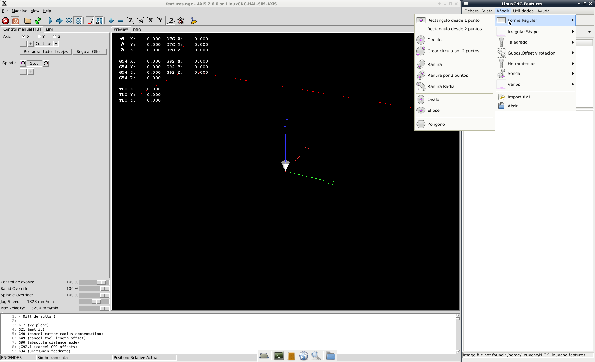

For your translation, create a subdir : locale/es/LC_MESSAGES
Move your linuxcnc-features.mo in it
In a terminal type
cd /usr/share/locale/es/LC_MESSAGES
sudo ln /<full path to features sourse>/locale/es/LC_MESSAGES/linuxcnc-features.mo -s
That is all
