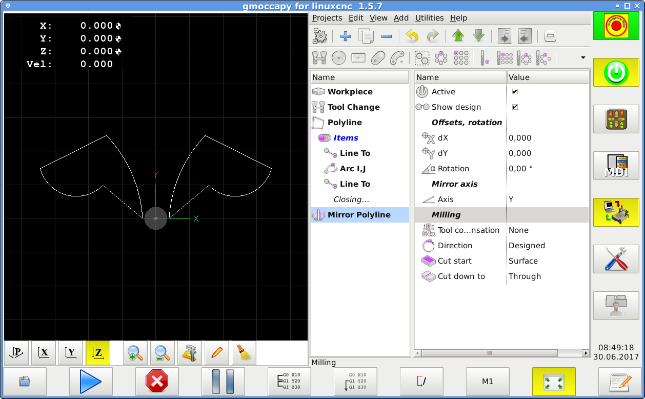

on a wood router cnc cabinet parts have to be left side and right, for that reason a mirror feature is very important, a sort of G50-G51 Gcode in mach3 not implemented in linuxcnc. Under the Group "Offset-Rotation" could you add a Mirror toolpath function maybe flipping and shifting the current workoffset (not rotating it) and not reversing the toolpaths to mantain the same milling direction?

The problem with simply mirroring a tool path, is it reverses the path direction of cut. (conventional milling to climb milling for example.) That can have unintended consequences, especially when milling wood. Such as corners chipping off, or pieces cut different sizes, and poor surface finishes. (I generally just set up 2 files a left and right one, even on machines that have the mirroring code.)

Hi Floris,
I do not know what shape you want mirror but there are possibilities with "Polyline'. The only restriction is pocketing.
Version 0.1.4 is available now and it should be installed on your computer.
Open the example 'Lathe cnc conversion/sensors bracket.xml'.
I designed the right half of the profile with 4 elements and then mirrored everything from the beginning. Changing dimensions of those elements will be reflected on the left side.
This works inside an item but for a whole shape, you first create the polyline you want (closed or open) like the strange one here, then add a 'Polyline mirror'.
You can mirror on X or Y axes, offset, rotate, mill clockwise or counter-clockwise.
Can these work for you ?
Fern

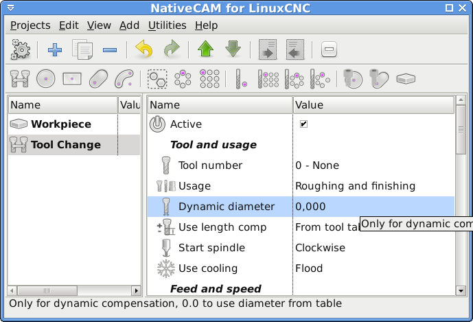

P.S. In this new version, I added 'Dynamic diameter' in Tool change. You have to replace old 'Tool change' for the new one.
Tell me if it works like you wished
