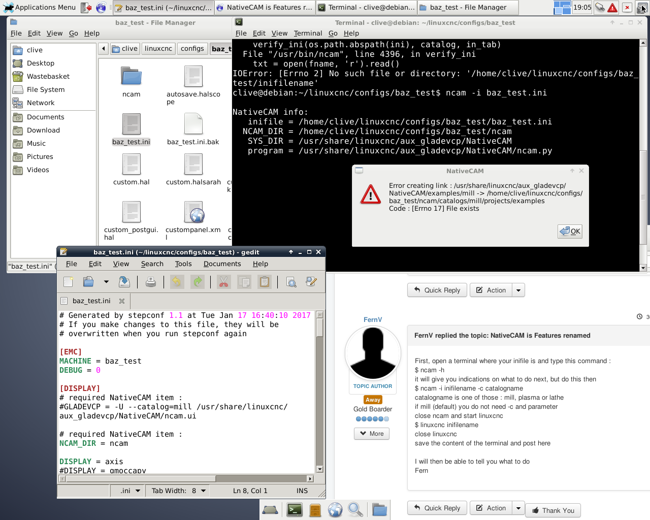

here is terminal window:-
clive@debian:~/linuxcnc/configs/baz_test$ ncam -i baz_test.ini
NativeCAM info:
inifile = /home/clive/linuxcnc/configs/baz_test/baz_test.ini
NCAM_DIR = /home/clive/linuxcnc/configs/baz_test/ncam
SYS_DIR = /usr/share/linuxcnc/aux_gladevcp/NativeCAM
program = /usr/share/linuxcnc/aux_gladevcp/NativeCAM/ncam.py
[RS274NGC]SUBROUTINE_PATH = ncam/my-stuff:ncam/lib/mill:ncam/lib/utilities
Real paths:
/home/clive/linuxcnc/configs/baz_test/ncam/my-stuff
/usr/share/linuxcnc/aux_gladevcp/NativeCAM/lib/mill
/usr/share/linuxcnc/aux_gladevcp/NativeCAM/lib/utilities
Using default mill/menu.xml, no mill/menu-custom.xml found
/usr/bin/ncam:2275: GtkWarning: IA__gtk_accel_label_set_accel_closure: assertion `gtk_accel_group_from_accel_closure (accel_closure) != NULL' failed
mi = _action.create_menu_item()
clive@debian:~/linuxcnc/configs/baz_test$ linuxcnc baz_test.ini
LINUXCNC - 2.7.9
Machine configuration directory is '/home/clive/linuxcnc/configs/baz_test'
Machine configuration file is 'baz_test.ini'
Starting LinuxCNC...
Found file(REL): ./baz_test.hal
Found file(REL): ./custom.hal
task: 998 cycles, min=0.000023, max=0.022279, avg=0.009937, 0 latency excursions (> 10x expected cycle time of 0.010000s)
clive@debian:~/linuxcnc/configs/baz_test$ ^C
Plus a screen shot file:///home/clive/Pictures/Screenshot%20-%20300617%20-%2019:05:15.png

First, open a terminal where your inifile is and type this command :
$ ncam -h
it will give you indications on what to do next, but do this then
$ ncam -i inifilename -c catalogname
catalogname is one of those : mill, plasma or lathe
if mill (default) you do not need -c and parameter
close ncam and start linuxcnc
$ linuxcnc inifilename
close linuxcnc
save the content of the terminal and post here
I will then be able to tell you what to do

Replied by FernV on topic NativeCAM is Features renamed
Delete /home/clive/linuxcnc/configs/baz_test/ncam completely
restart $ ncam -i /home/clive/linuxcnc/configs/baz_test/baz_test.ini
close ncam
restart $ linuxcnc /home/clive/linuxcnc/configs/baz_test/baz_test.ini
Fern

I will correct this for sure but meanwhile you only have to do this :
Add a new line after G28 in the postamble just like you added one before it
Fern
I do not think so but I see a newline is missing after the postamble (% must be on a line by itself),Fern, maybe I have to delete my old modified files and reinstall NativeCAM...
Fern

Many thanks
Replied by Clive S on topic NativeCAM is Features renamed
Fern Perfect worked first time thank you. Just have to try and get the launcher working on the desktop now I am using the command :- ncam -i linuxcnc /home/clive/linuxcnc/configs/baz_test/baz_test.ini but that does not work but from a terminal in the baz_test directory it runs ok with ncam -i baz_test.ini not sure where I am going wrong.Delete /home/clive/linuxcnc/configs/baz_test/ncam completely
