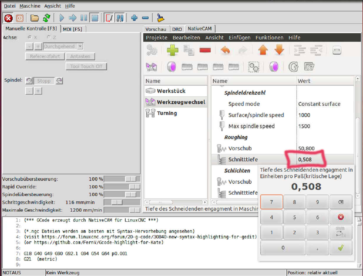

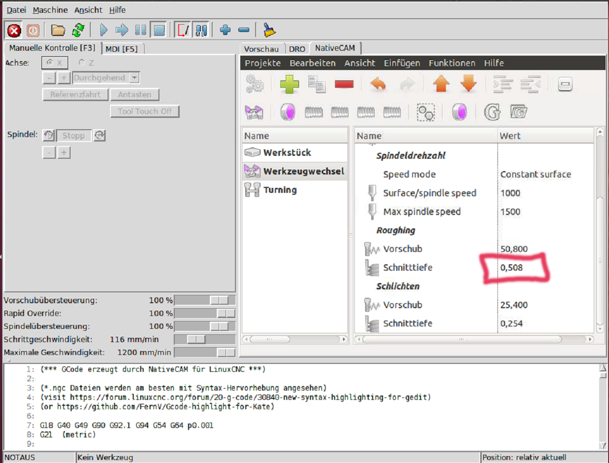

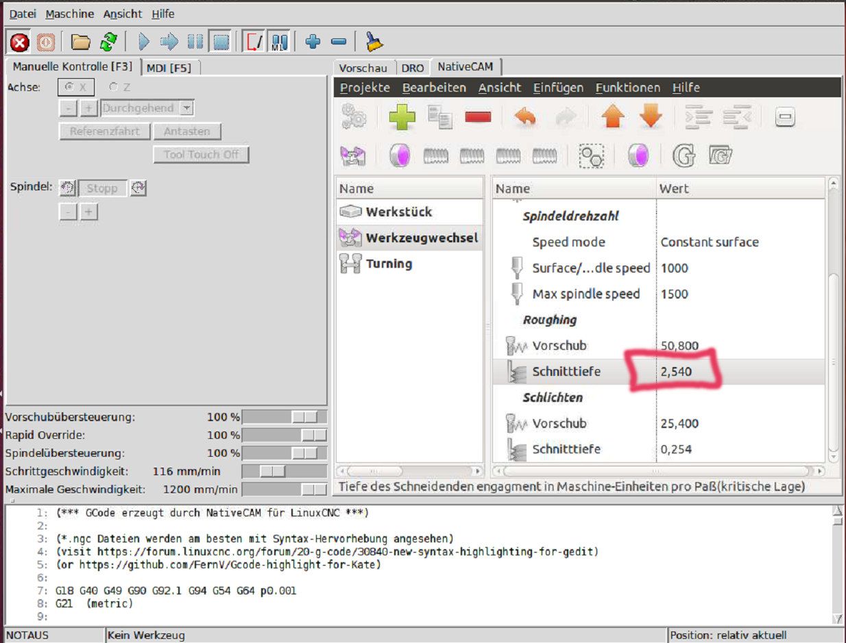

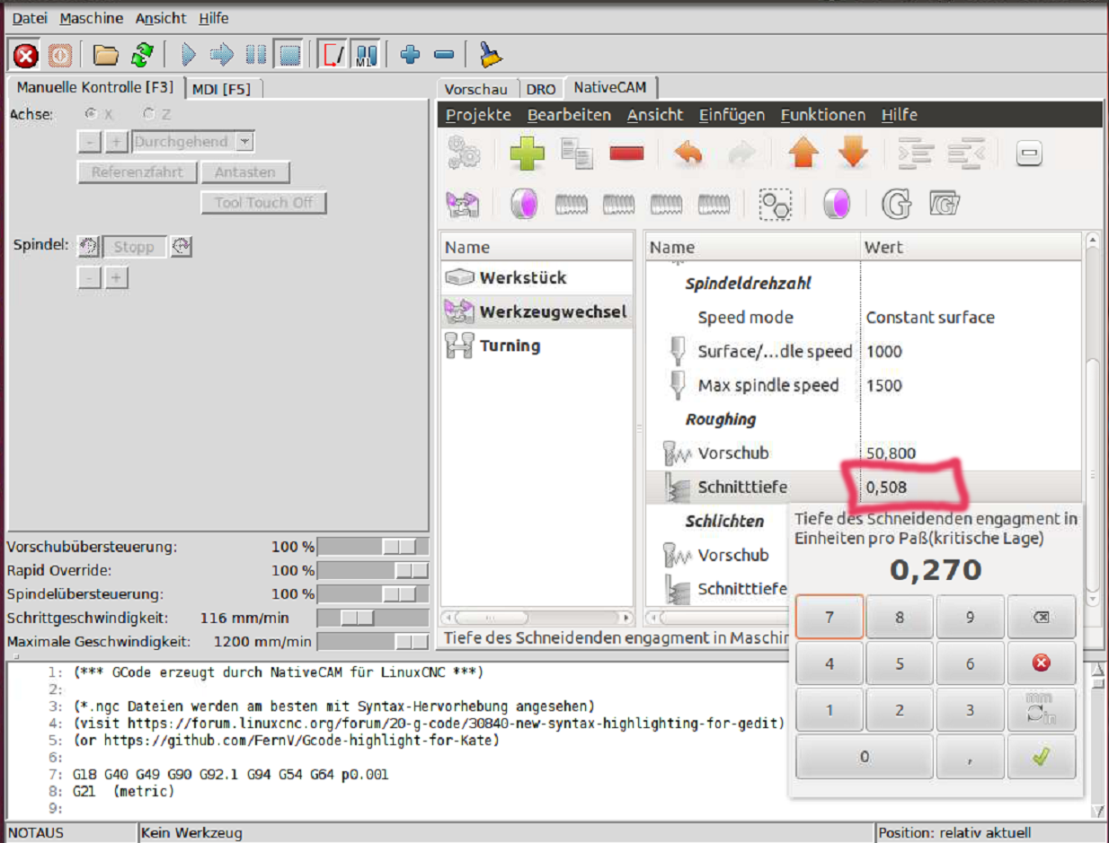

23 Jul 2017 09:17 - 23 Jul 2017 09:19 #96310
by BigDo
Replied by BigDo on topic NativeCAM can't change Engagement Value
I try to change the cutting depth in NativeCAM but apparently this is not possible
the default value is 0,508
and if i change it for example to 0,270
It changes automatically to 2,54
How can I fix this?
See attached pictures
My System Ubuntu 12.04, LinuxCNC 2.7.10, Lathe (metric)
How can I fix this?
Last edit: 23 Jul 2017 09:19 by BigDo.

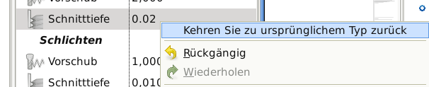

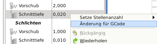

To change for g-code
To revert
Fern
Replied by FernV on topic NativeCAM can't change Engagement Value
How can I fix this?
It was explained 2 posts before your's
forum.linuxcnc.org/40-subroutines-and-ng...amed?start=390#96228
but here are screen shots :
To revert
Fern
