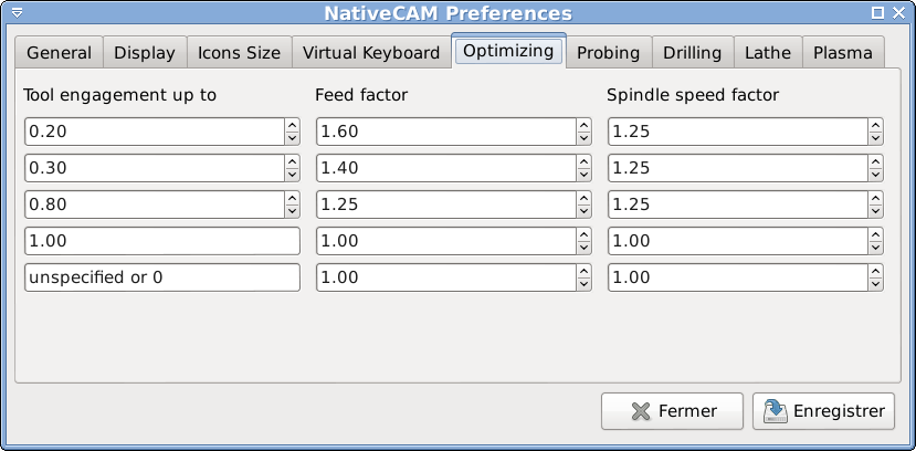

Now I need to find out, where to set some default values, as I want to use on every tool change the compensation from the tool file and all my tools should be used with flood cooling.
Also If I enter a feed of 750 on a slot/ovel 1 point outside milling, the machine does only 600 and speed is also lower.
I think this are those optimization factors.
I changed default values for optimizing like in this shot
I also changed default values in Change Drill and Change End Mill to use length compensation and flood. It should not hurt if tool table value for Z is 0 or nothing is connected for flood, isn't it ? If you think it does, let me know please

P.S. it is possible to change default values in all *.cfg files. They must then be saved under a different name to prevent overwriting them. It requires the use of a menu-custom.xml which would not be overwritten. Drawback is you may not be aware of improvements and new files though you will be noticed of this and to try the new changes you would either have to load with the standard menu or open a cfg file and select the new files.
I think there is a way to do it but I am far from it now. It would be to have a 'init' section in each cfg files that execute as python code and set your personnalized values that would be entered in the Preference dialog. There are other priorities now.

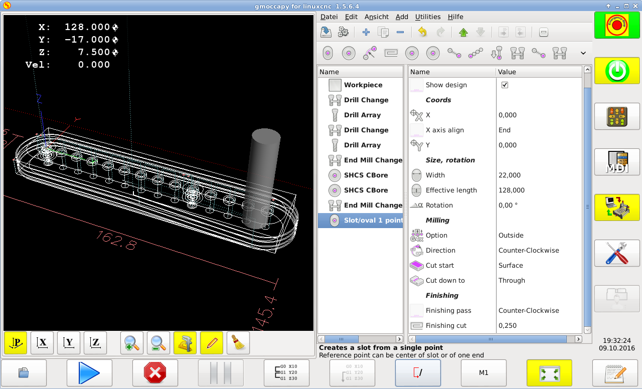

10 Oct 2016 06:55 - 10 Oct 2016 07:00 #81494 by eFalegname
Replied by eFalegname on topic NativeCAM is Features renamed
Fern, thank you very much for being so helpful, you've done a superlative tremendous nice job.
This morning I found a very strange behavior, I think it's better to illustrate it with a video, I do not know if I should do the steps in a certain order to get that these things do not happen
If you do not follow a logical order, yes you will have messages from lcnc that some parameters do not exist.
Select them in the order they need to be executed like you do in any ngc file you would write yourself.
I watched you video and except for some warning that appears from times to times I have never them seen before.
On my pc's there are 2 messages that appears from times to times and when I tried to solve them (at least 5 times each) the cure was worst than the evil preventing values to be displayed. They do not hurt but I do not like having them and I found no way to make them not show. I think they are pygtk error.
When I started working on Nick's basic code 2 years ago there were some error checking code but no real handling of them and nothing very elaborated and at that time I knew nothing about python and linux. I now know a little more and with a lot of research on how to do this then that I have been able to improve his application to what it is now but far from perfect.
I can not reproduce the problems I saw but I wonder if it is due to your newer versions of python or others
I will start from the messages in the txt file you attached and write error handling when and if they shoe but YOU will have to test.
