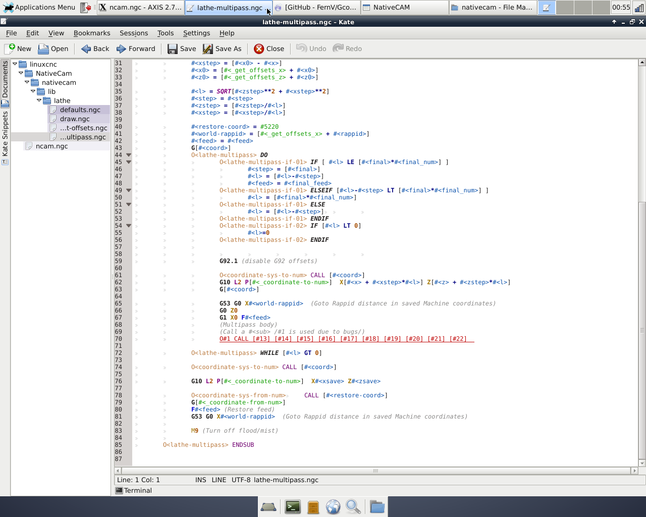

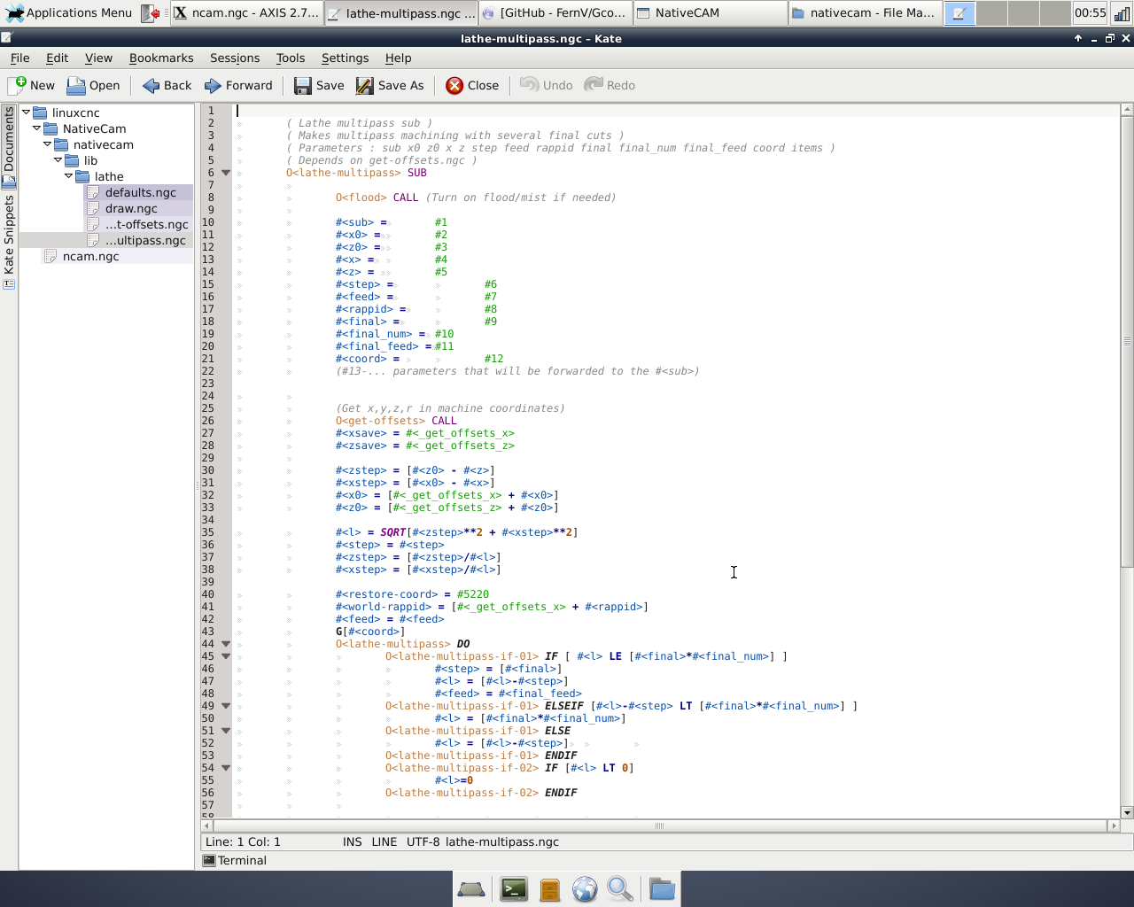

Regarding the lathe support I'm trying to help with, I've noticed that I have an error in lathe-multipass.cfg (previously it was .ini)
I have installed kate + the plugins suggested by FernV, I can see there's an error at a specific line but I can't figure it out what the error actually is. I am attaching two screenshots containing the code highlited in kate.
If someone can help me with some clues/code I would be grateful!

That way to name subroutines was not supported when I wrote this highlighter, I will update it when back from the jungle.
It does not mean it is wrong in this case. The #1 is the first parameter passed to "multipass " subroutine.
I see there is a call to "flood" subroutine here too. Comment the line and try again.
The most difficult part in debugging gcode is there is no debugger. You have to write print statement to know where it stops and print values. Read ngc files in utilities directory
Fern
