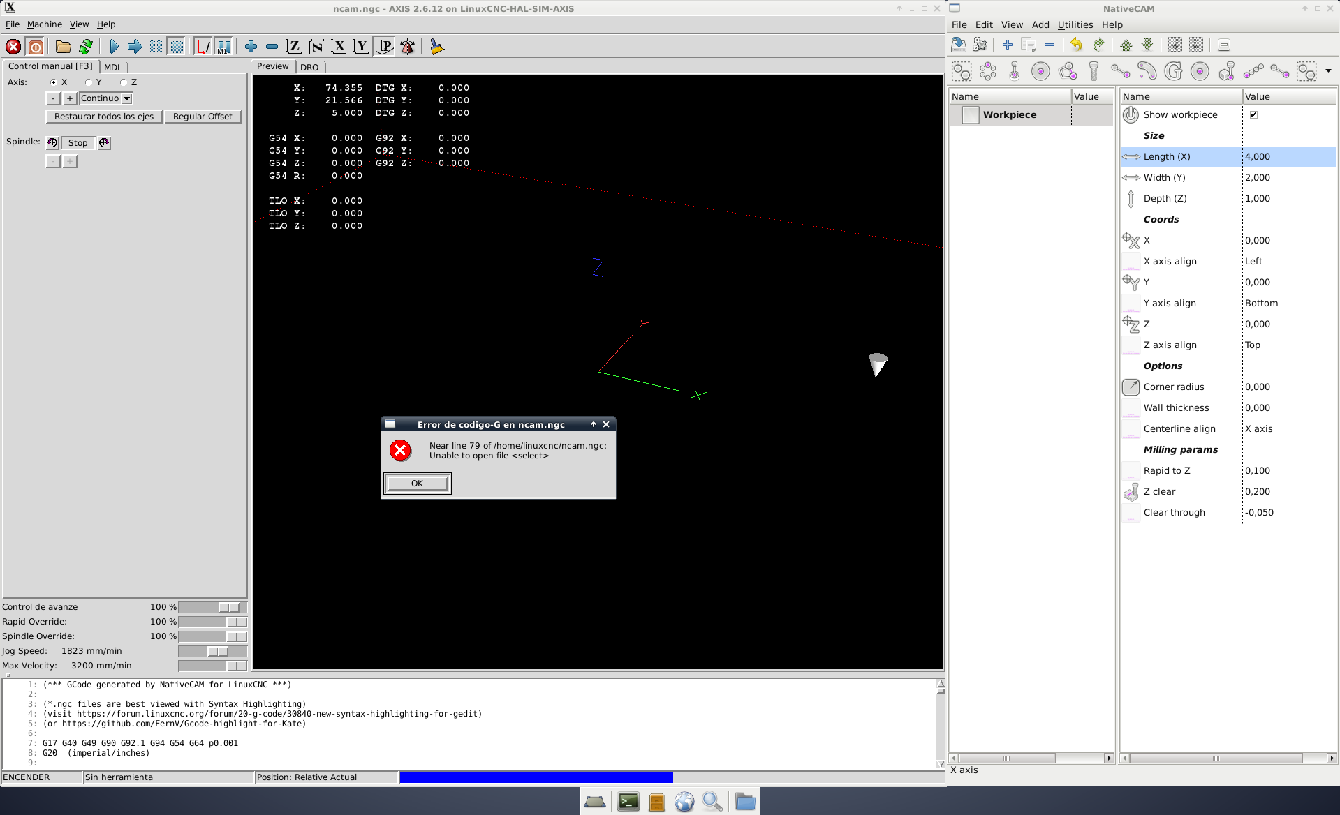

Have you change the SUBROUTINE_PATH in the
inifile ? It is trying to execute select.ngc from lib/utilities
Read the ini files in the ncam_demo directories
Fern

Many thanks to FernV for this great new tool for Linuxcnc.
Onething, i start Nativecam and when try to run any Feature i get an error,
Someone can help me with this?
My installation is under Debian.
