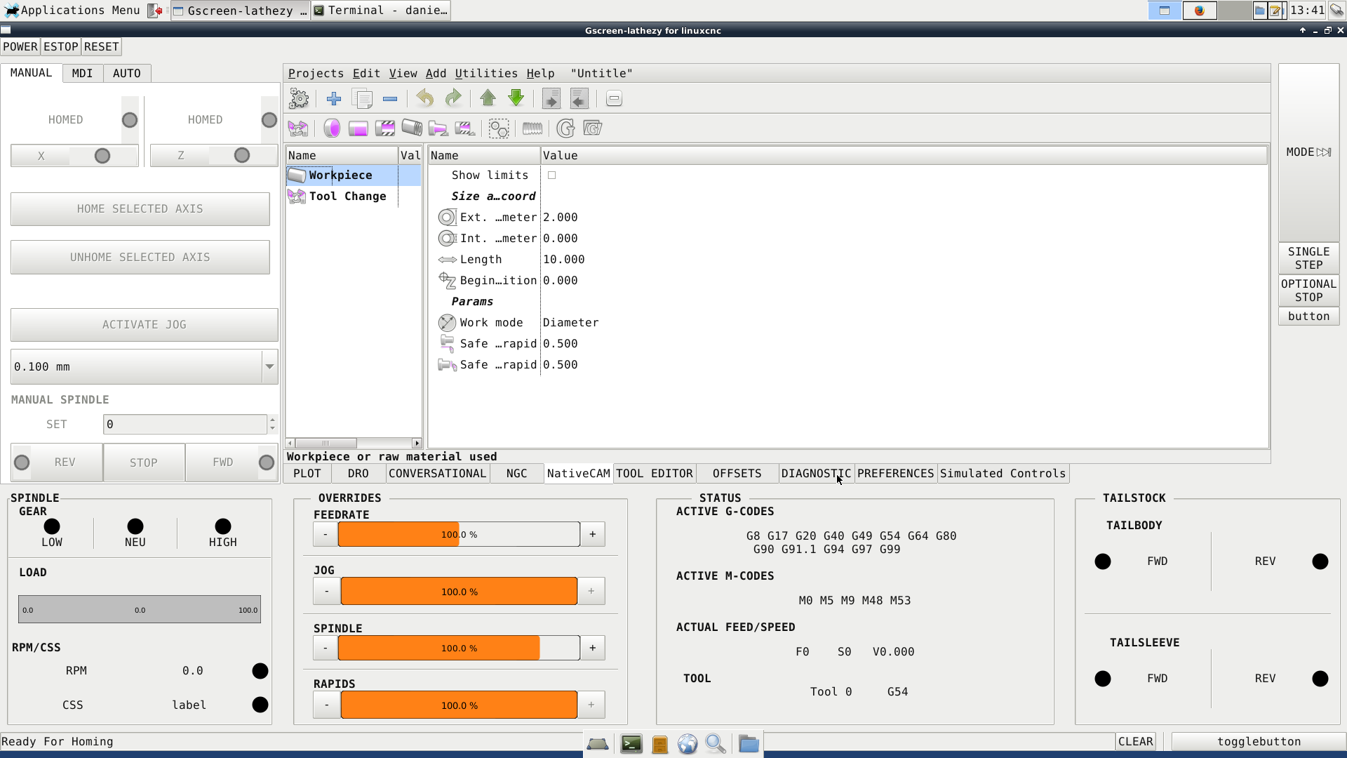

NativeCAM check for DISPLAY to be exactly 'gscreen'
In your file it is 'gscreen -c lathezy -d', do you really need the others args ? If yes ncam.py will have to be modified to find the value at position 0 of DISPLAY
Fern
14 Dec 2018 04:13 #122410 by sqmathlete
Replied by sqmathlete on topic Use NativeCAM as a deb package now
Yes, I believe the line is required for gscreen to load to custom ui
From the gscreen wiki
There is a switch in the INI file to set set the base name: -c name so Gscreen looks for MYNAME.glade and MYNAME_handler.py. HAL pins will start with this name too.
When I start my custom screen it comes up as gscreen-lathezy...hmmm.
Dan

If you want to change it, edit ncam.py and find
            if val not in ['axis', 'gmoccapy', 'gscreen'] :
                mess_dlg(_("DISPLAY can only be 'axis', 'gmoccapy' or 'gscreen'"))
                sys.exit(-1)
You can remove this code or comment the last line if you know what you are doing
Fern
18 Dec 2018 05:43 #122554 by sqmathlete
Hi Fern
and changed the code (around line 2384) to
            test_str = ini_instance.find('DISPLAY', 'DISPLAY')
            print ("test-strg = %s") % test_str
            # valid options gscreen or custom gscreen, axis, gmocappy
            match_gscreen = re.search(r"\b(gscreen)\b",test_str)
            if match_gscreen.start() == 0:
                print("match found at position %s") % match_gscreen.start()
                val = 'gscreen'
Seemed to work perfect. Not sure how you would change this to load all three options though. It was pretty much a miracle that I got that to work.
Dan

19 Dec 2018 03:48 - 19 Dec 2018 14:49 #122589 by FernV
Replied by FernV on topic Use NativeCAM as a deb package now
Just insert these lines
            pos = val.find(' ')
            if (pos > -1) :
                val = val[0:pos]
between
            val = ini_instance.find('DISPLAY', 'DISPLAY')
and
                glb.mess_dlg(_("DISPLAY can only be 'axis', 'gmoccapy' or 'gscreen'"))
                sys.exit(-1)
at line no ~2383
and at line no ~4978 substituting here 'val' by 'dp'
Those are the iines of published version
Fern
