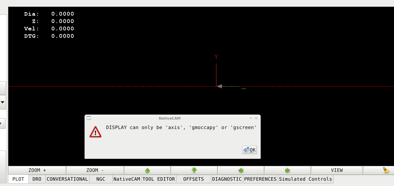

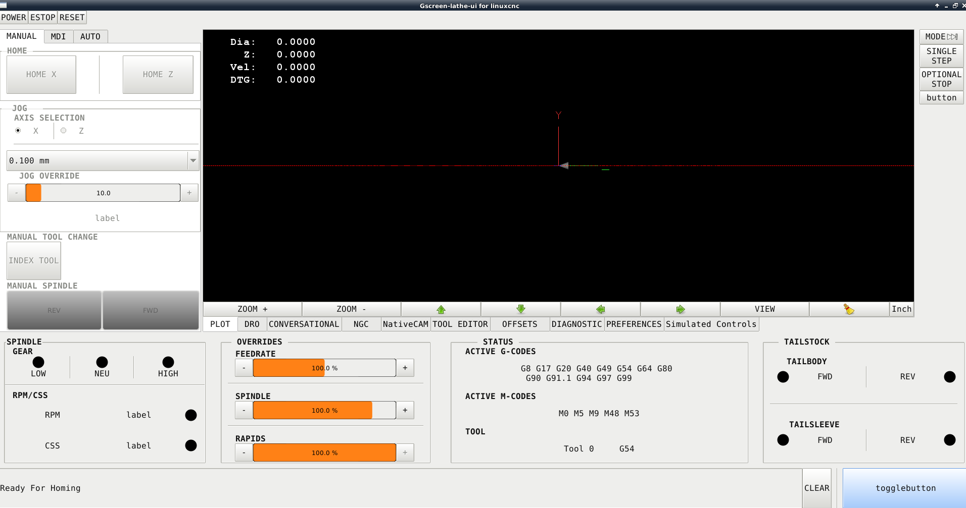

10 Dec 2018 18:07 #122150
by sqmathlete
Replied by sqmathlete on topic Use NativeCAM as a deb package now
Hi Fern,
Sorry, that question was a bit unclear. I want to embed NativeCAM in to a custom g-screen tab. I am assuming that the answer is still no, since I get this error... this is the only one though.
As you can see, there is also a tab for Ngcgui. It doesn't work either at this point.
Second, I installed NativeCam via the instructions on the first page and through the synaptic pkg manager, now I need to run sudo linuxcnc to open anything without errors but I am unsure of which file permissions I need to change.
Any idea?

- FernV
- Posts: 457
- Thank you received: 124
10 Dec 2018 18:22 #122152
by FernV
Replied by FernV on topic Use NativeCAM as a deb package now
What is the display value in your ini file ? As you see, it can only be 'axis', 'gmoccapy' or 'gscreen'.
Have you tried to setup a second time ? It must not be done before removing any 'NativeCAM required item' lines from your ini file.
I personnaly had success with gscreen but you have made a lot of modifications to it.
If you have issues since you installed ncam, uninstall it and make sure lcnc works fine, then post your ini file here so I can have a look at it.
Fern
