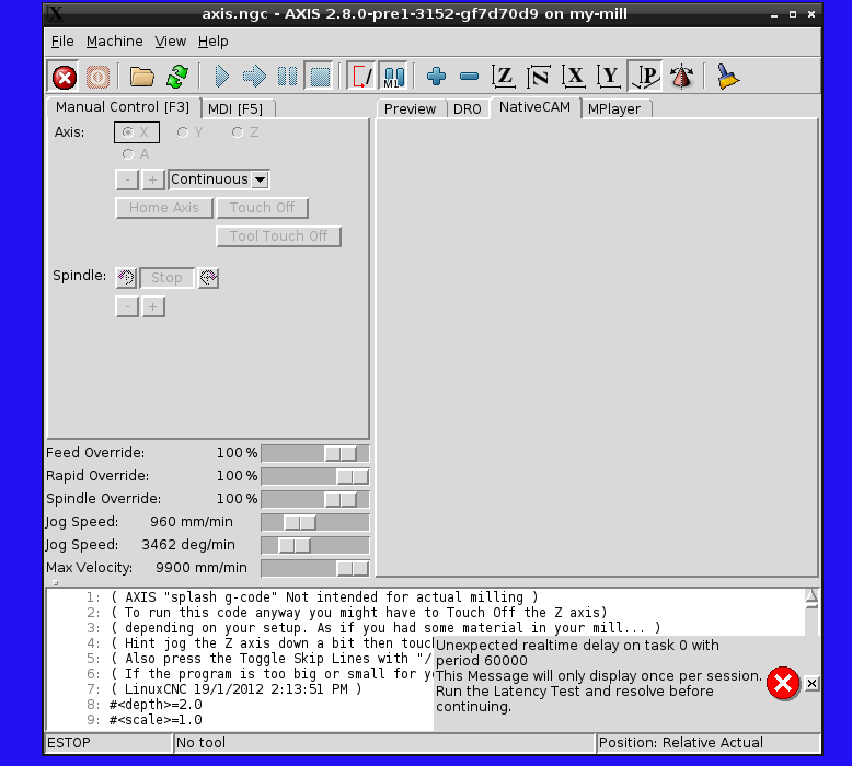

Damn, now the Ncam tab has gone blank again.

grump wrote: ...the Ncam tab has gone blank again.
Change directory to where your inifile is and restore your inifile backup.
Then : ncam -t -i (inifilename)
This is the fastest way to re-initialize it.
ncam.ui is in a new directory and it should be reflected in your inifile
Fern

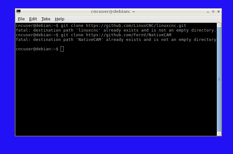

9 years 4 months ago - 9 years 4 months ago #94303 by grump
Replied by grump on topic Use NativeCAM as a deb package now
Ok so I'll just wipe the Hdd and start again. Again.
It's not me reverting it's the git won't give me 2.9 nor does synaptic.
I give in.
Last edit: 9 years 4 months ago by grump.

9 years 4 months ago #94308 by FernV
Replied by FernV on topic Use NativeCAM as a deb package now
If you have not erased your HDD yet, don't.
I had a version for development that was not in continuity with any other
Here what I did and succeeded the first time
The information you need is here :
Code:
http://linuxcnc.org/docs/html/getting-started/getting-linuxcnc.html#_installing_on_debian_wheezy_with_preempt_rt_kernel
but I did not follow all steps and I did not reboot at all.
First in Synaptic remove completely linuxcnc-uspace,
Then I followed only steps 7 to 10
Voila, I had version 2.7.9 installed
I was then able to install NativeCAM as described in the first post
Fern
